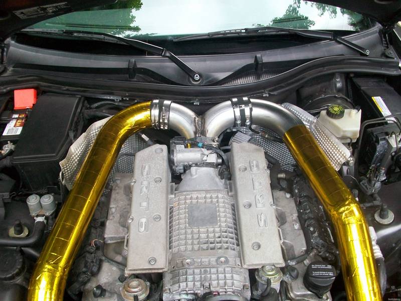

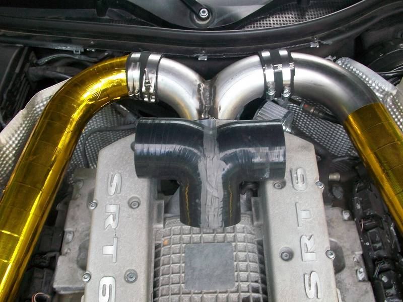

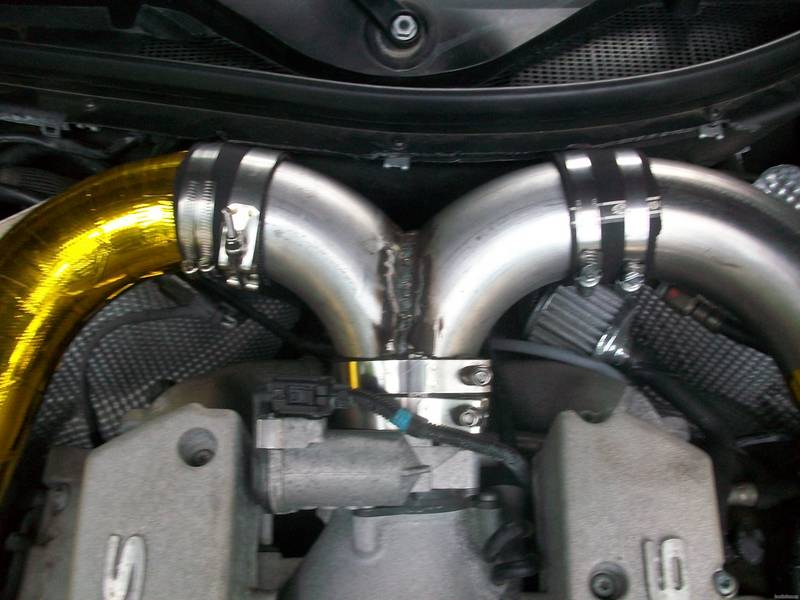

This is my custom dual intake, I made this setup nearly 6 months ago but never finshed it until last week i used 2 silcone 90's cut to make a merge collector with Woody's advise months ago but ended up switching to the hard pipe merge collector later hoping to increase the velocity of the air into the throttlebody. The cool tape works wonders at the track. It doesn't prevent heat soak on the pipes but it takes extremely long for the pipes to get heat soaked and even when they do you can touch and it wont burn your hand. Where before i put the tape on it would be hot enough to burn your hands.
Haven't tested if there is any improvement at the track because its rained non-spot here on track days. I can hear more whine earlier in the rpms and a slight increase in whine across the rpm range. With the old silcone couplers i could blow in one side and feel nearly no air come out the single side, but the the hard pipe i could blow into one side and feel all the air come out the single side.
New collector vs old merge collector
close up of hard merge collector
picture of filters without the grill and use of 3inch fuel filler hose to get past radiator shroud.

other than those ugly welds(jk), looks great....
Old Jun 16, 2009 | 10:16 AM
Montana Crossfire's Avatar
Posts: 1,271
Default Re: Modified Dual Intake
Are you sure those are welds?

On the silicon wye you will find that if you blow into the tee, air comes out the sides easily and evenly. The tee section is the low pressure side and it sucks off both sides easily and effectivley. The Super CAI power numbers has shown that ESPECIALLY below 4000 revs. THat is where it is the most important on the street and getting going on the track. There is a positive gain on the top end also, I believe 10 or better H/P.
This is a full size 3" design and also conducts less heat than the metal style. ALSO I would never talk about others welding, cause I have made a few gumball welds in my day, but they work.
Woody
BTW the coupler of silicon isolates a lot of vibrational stresses better than the straight couplers as there is more material to flex and give.
( Proud parent of the original silicone wye)
Enjoy..

I have a question for mayhem and woody. There is a difference between the two setups. One is a "Y" (large inner radius), and the other is a "T" (tight inner radius). Is that what was making the difference that mayhem was talking about? I would think that this would make a huge difference in flow, but is that correct?
