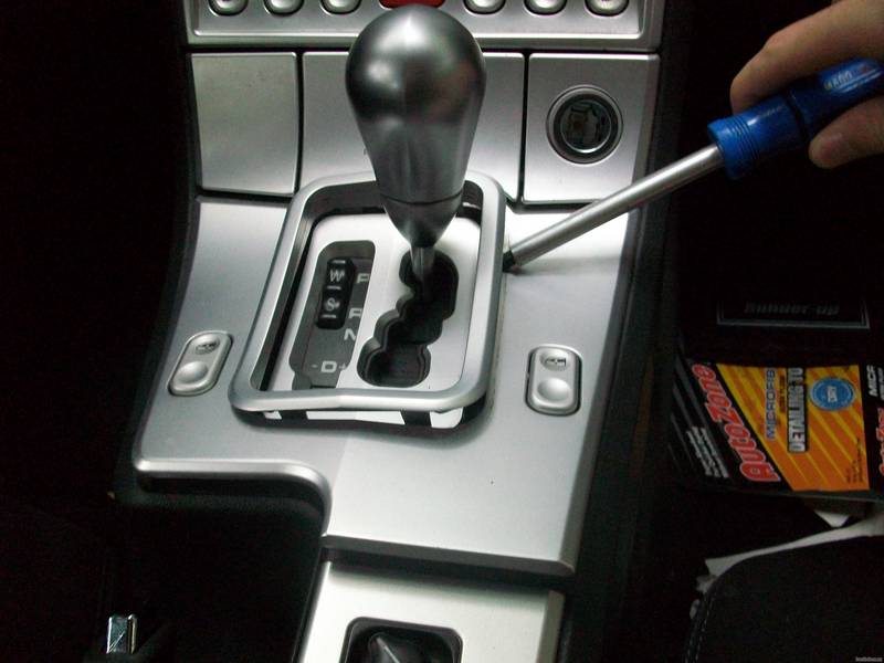

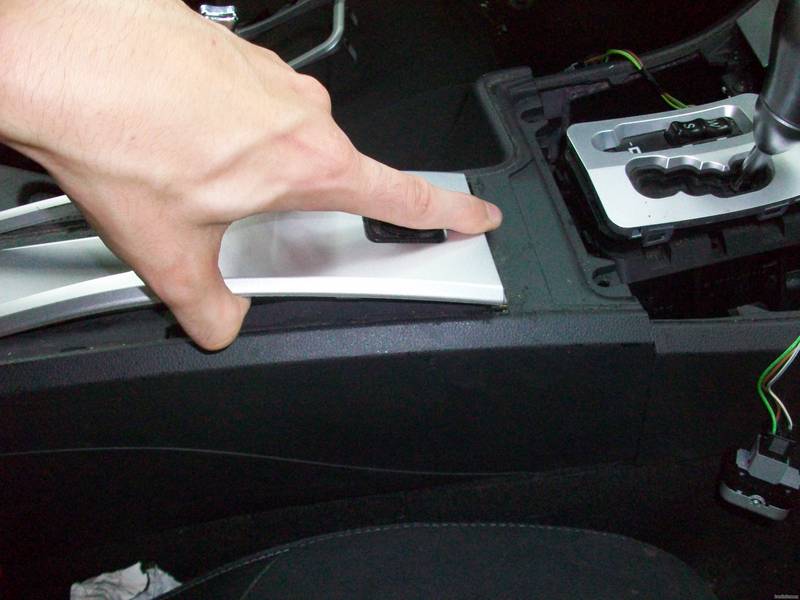

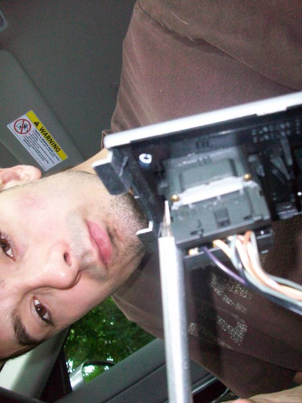

Here are the requested images i'll put them in order of completion.
First and second step just use a flat head screwdriver to pop loose the plastic cover peices.
3rd picture is showing me uncliping the two electric window switches so i can set the plastic cover to the side.

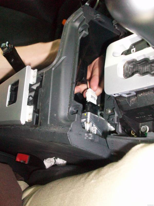

4th you need two remove the two screws holding the major console peices together.
5th lift up and pull twards the back of the car to remove the plastic cover with the electric side mirror **** on it.
6th disconnect the side mirror connector from the main plastic peice

Remove the rubber cover from around the e-brake, this can seem rather difficult at first just use some muscle and wiggle/twist it as you pull upwards. Hmm... now if i can just get my woman to grasp this technique...
theres that sneaky sob...
