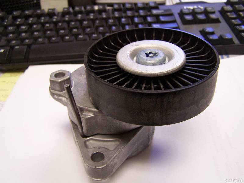

One of my bearings is going bad and I isolated it to what I would call the Idler Pulley. It is left of the water hose. Anyway, I looked up idler pulley for a SRT6 and saw that Gates makes one so I went and purchased it. The part # is 38082. The pulley is 63.5MM. Looking at the pulley that is currently on there, this looks way too small. Before taking the belt off and cover off the pulley, does anyone know the size pulley that should go there?
Thanks,
Glenn aka Marine05
sc idler pulley is 65mm, i believe and plastic.The idler pulley steel and 90mm. Tensioner and idler are the same. Search site there are photo"s and a lot of info on subject.

It is the pulley just to the left where the water hose goes into the engine, It has a bolt going into it. Looks like a 15MM size ratchet would fit. I tried posting a picture here, but didn't have any luck. It is a jpg file but it won't upload. I inserted the picture in a Word File and attached. Sorry for the poor quality I used my phone and flashlight.

That is the idler pulley and is 90mm as Texas T said. Not sure what the Gates part number is for a replacement. A 100mm replacement is Gates 38002.

Thanks everyone. I guess I will have to take this darn thing apart and bring it to a part's supplier. Everyplace I checked online, keeps on showing the smaller pulley size (The one that sits just to the left of the Super Charger).

So I will close out this thread by telling everyone that more than likely you have to get an Idler Pulley from a MB Dealership. I searched high and low online and everytime I searched for an idler pulley, it showed the smaller ribbed pulley. I took the 90MM pulley off and went to the MB Dealership. As soon as the Parts Guy saw it, he said "Looks like you need an idler pulley." The MB dealership had one in stock. It was a little steep ($84 bucks), but my research time cost more than that. I put the pulley on this evening and am ready for the GTG tomorrow.
