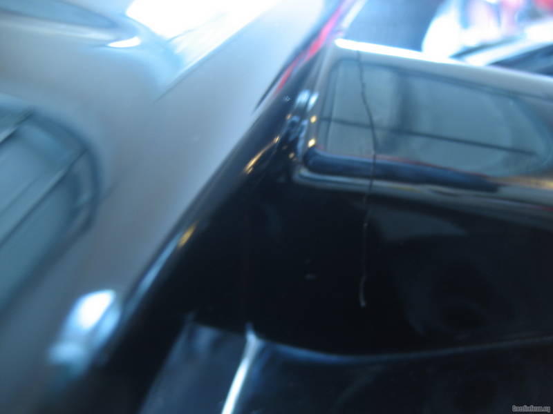

Has anyone had any problems with there spoiler cracking? If so what did you do about it. Its the part where the top of the wing connect to the mounting piece before the bolt on to the trunk. I will try to post a picture later.

Here are the photos. It's kinda hard to see.

Mine is still cracked. I have not gotten around to checking ointo getting it repaired. Here are a couple of pics of mine. As you can see, mine is cracking in the same place as yours.
