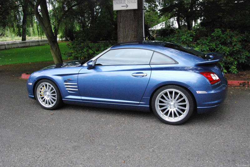

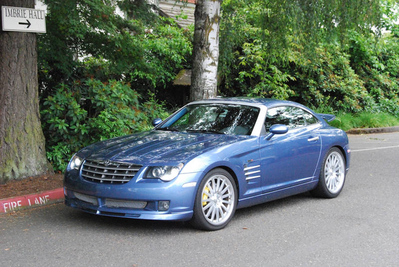

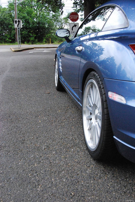

Here are some decent pics I took a little bit ago at one of the (many) micro-brewery's here...... I just install the TVT adjustable camber arms today and set them so I have about 10mm-11mm of negative tilt from the bottom of the rim to the top edge... this looks to be close to factory or a little less...... this also has the 10mm spacers in front and 12mm in back........ (a few more in my gallery)..

~ perfection...

A+ very nice

Hey Mike looks great!
How do you find the ride? I know a few members like the stock SRT springs better! what are your thoughts?

Car looks stunning as always. Hit some big potholes if you can, I'm curious about the 12 mm in the rear. (I have 10mm on the front too) I believe the suspension adds positive camber when the lower control arm passes horizontal, but I'm not 100% positive. Either way, stunning, stunning.

Kolevski, So far the ride is fine... I have had the springs in for about 4 weeks... I may take it for a drive to the coast today and see how it handles going through the mountains.....

I try to miss them too but I manage to fail from time to time. I couldn't take the risk of contact at the track so I tried to make my tires rub. I guess a better way would be to lift the suspension on one side with a jack. I think I'll do just that to find out how much wider I can go, if at all. I'm glad you got the rattle fixed before it got worse.

Les.... jacking the wheel up would be a good way to check clearance under compression...the rattle was just annoying...as long as the bolts didnt fall out, it was just a floating caliper. Glad that I caught it and fixed it though.... caliper falling off would not be a good thing.. I had checked everything else on the rear suspension thinking it was coming from there... guess I should remember to check the basics first..

Yeah... I had the adjustable arms for some time now but didnt install until I saw that I had an inch or more of negative camber when the new springs had settled...
One of these days I will wear out the 255 Kumho's and get some 275 or 285's and will have to see if the rear spacers are too much...
