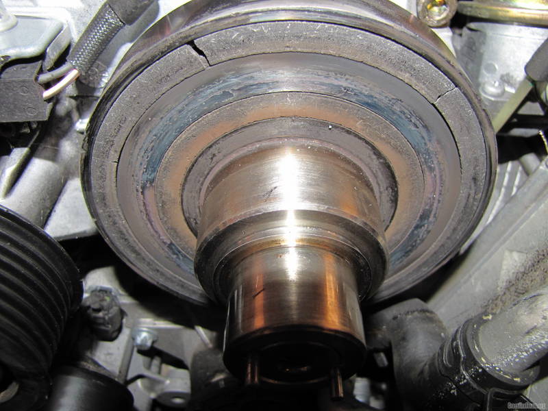

Anyone familiar with this type of clutch failure? Just going to Lowes (only about 1 mile from the house) and heard a strange sound from the front then I heard the familiar sound of a slipping belt. This was the suprise I discovered when I opened the hood.

Same thing happened to another member one month ago, almost to date.
https://www.crossfireforum.org/forum...lure-pics.html

Wonder if this could have been the problem?
It's the friction disc portion of the SC pulley clutch.
If it came apart it would frag like a clutch going out.

It looked like there are some flat pieces of metal, probably used as a spring to keep the face of the clutch away from the friction material when the magnet is not engaged. One of these broken flat pieces of metal was hanging out and did all of the damage.
