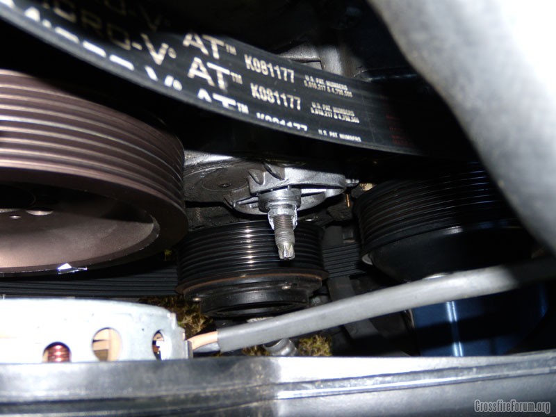

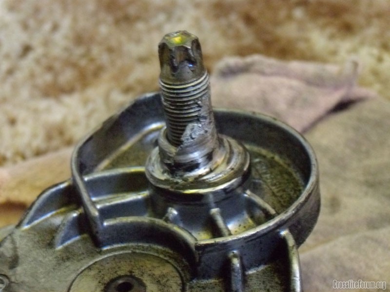

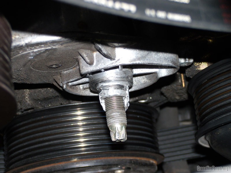

On the way home I was cruising down the freeway and heard a clunk and banging under the car and something black bounding on the road behind me... crap, what did I run over? I didnt see anything on the road... a few minutes later I see the engine temp on the Dashdaq is RED, look at the needle on the dash and it is climbing quickly.... so I find a spot to pull over quickly and kill it. Pop the hood and sure enough, my belt is all loose, but looks okay. WP pulley and all on the passenger sides looks good. Where the heck is my tensioner pulley?? It came off. I just looked at the tensioner this morning in good light and it looks pretty clean. Nothing else damaged and even the fan belt looks find. But it looks like the nut came off and there is some metal stuck on the tensioner around the bearing seat and on the threaded bolt..
Dont know if the pulley siezed and spun if off being driven by the engine or what. I will pull it and confirm, but it looks like it can't be salvaged, the seat looks damaged and the means a new tensioner. The EC re-tune will have to wait till I get this fixed.

this is the under side where all the pressure is applied....

Dude, that looks pretty rough. Hopefully, when you get it off, you'll
be able to find a way to clean up the seat and save yoursefl the $200.

Oh man! So sorry that happened to you Mike. I always worry that I didn't tighten my pulleys enough. I tighten them to 20 ft lbs of torque which should be way more than enough. Hope your car recovers ok. It does really suck though when they don't prep the tracks good enough. It just causes problems with spinning which can result in axles and diffs breaking. Good luck with everything.

well I remembered that I keep almost everything.... including an old tensioner that I thought might be causing belt slip and has a kind of buggered up bolt that I worry about using when I have to pull the belt.... I also have a couple of spare stock 90mm pulleys.... so I can get the car fixed and usable... just cant floor it...
I will get a new one and the larger 100mm pulley so I can go have fun soon... The new tensioners come with a 90mm pulley so I will have another spare.....(can you have too many?) anyone want to trade for a 100mm?
I checked all my other pulleys and they seem to be fine. No rattles or grinding...
