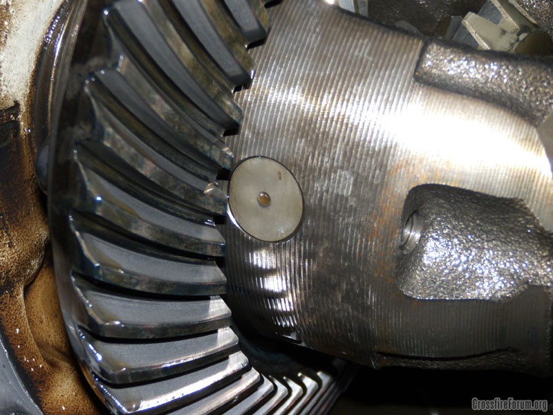

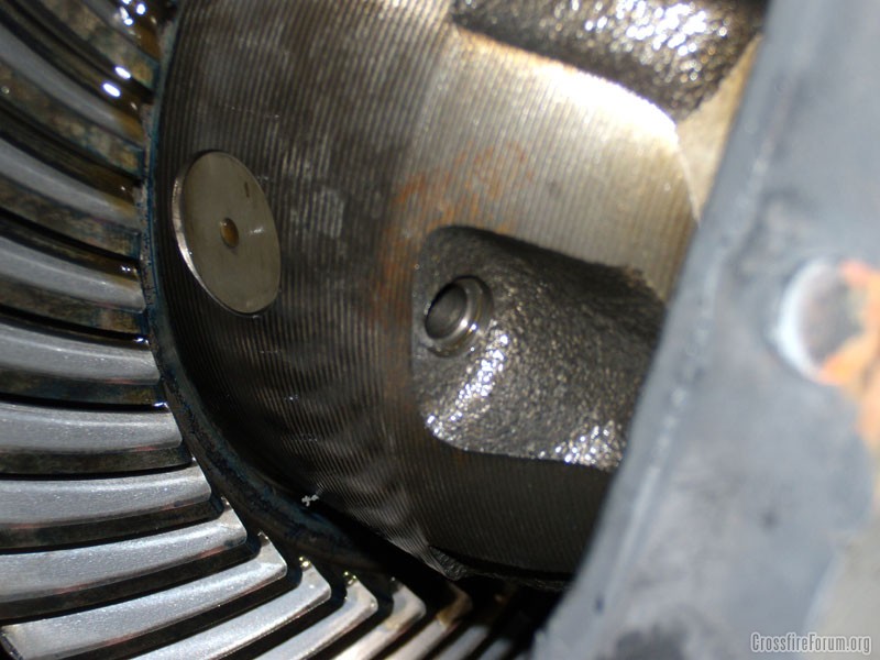

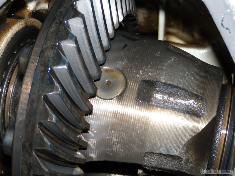

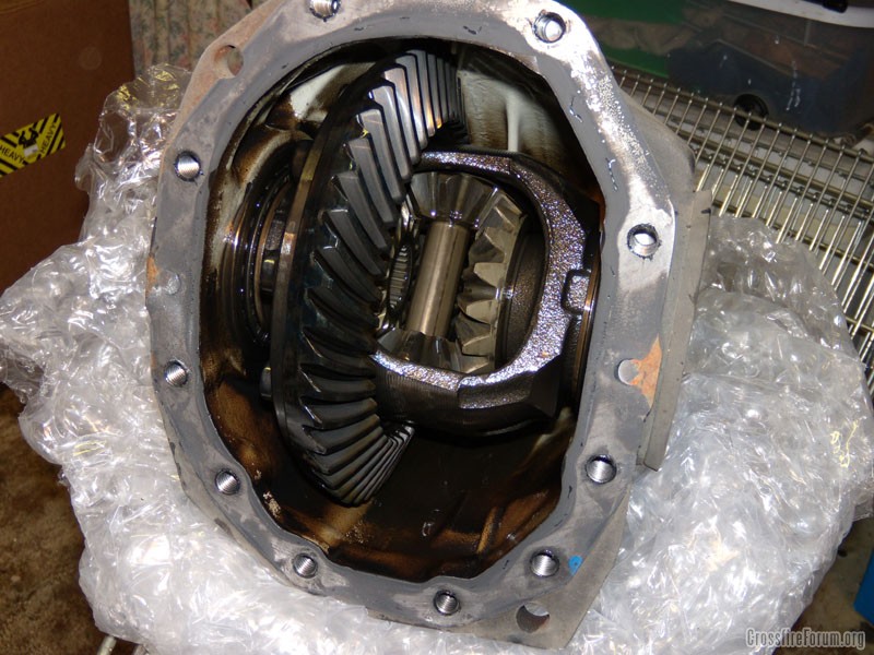

I wanted to check out the wear and tear on my original differential from the Aero that has 37k miles on it now that it is out.... so I popped the back cover and here is what it looks like....

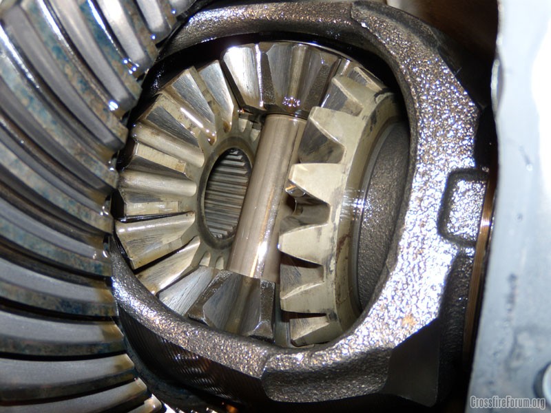

Here is a close up of the spider gears...
And here are both ends of the side gear pin....
I rotated the gears around and could find no signs of damage or chips anywhere on the spider gears or the ring gear... can get at the pinion gear without disassembly... but it should look just a nice as the rest of them do.... pretty good for 37k and some track time... granted it is only about 45 runs....

[quote=ProjectMayhem]Can you get a good picture of the saver pin? Make sure it hasn't backed out or sheered off.
Here is a close up of the keeper pin..... looks fine to me.. but I have no reference of how far in/out it should be.....and no way to tell if it is sheared other than it was working fine when I took the diff off the car....
Edit: I remembered that I do have a reference.. the carrier that came out of my new diff that only has 11k miles on it. I just looked at it and the pin is the same on the 11k mile carrier as the one on the 37k mile carrier.... so all is good
