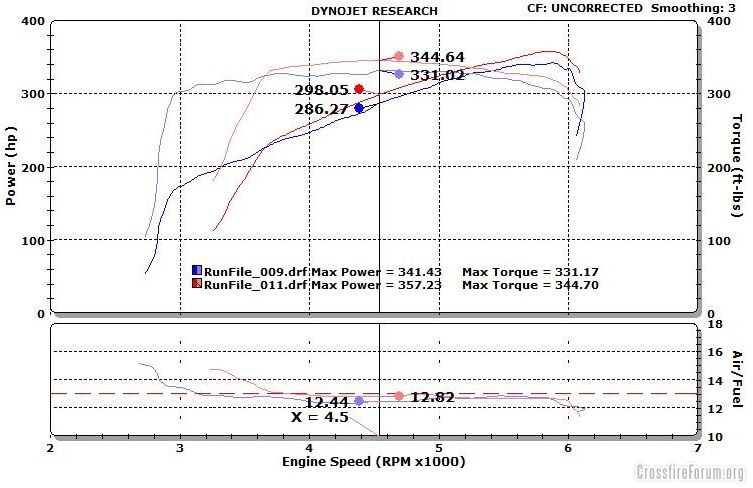

This is after my first Eurocharged tune. I sent it to Jerry and he in a matter of fact manner told me I didn't know how to dyno my car. He was right, but after some tutoring now I do. Anyway, I felt it was way too rich and it was adjusted. Then came the first revision (3 pulls) which I felt was a little too lean. I really don't know what's rich or lean for this car but I wasn't comfortable so I got another revision ..... that I will have to find the dyno chart.
Do us a favor, Les, and post another thread about how to dyno a Crossfire. We all need to know, because 99% of the dynos I've been to or seen don't know how either, and no one can tell them unless we - the owners - tell them.
The guy at Carlisle had a hard time getting three consistent runs out of my car, and couldn't get Beaner's car to dyno right at all.
