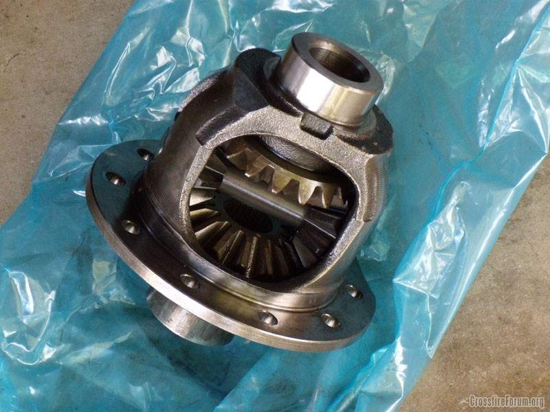

Hey Woody, how did your old carrier look when you took it out? was it shewed up like some of the others we've seen?
Old Jul 21, 2011 | 05:02 AM
waldig's Avatar
Posts: 4,508
Likes: 34
From: VA
Talking Re: Driving Miss Daisy, this aint
Clean oil, no chips, and teeth were shiny and smooth, did not take it apart as I dont want to stress the phantom grip components by taking them apart. The factory installed the PG for me and set it properly. It shows no wear. Made my day BUT I DID use synthetic. Woody

If anyone needs a complete SRT6 carrier with gears I have a spare that only has 11k miles on it... I also have a spare complete stock SRT6 differential...
