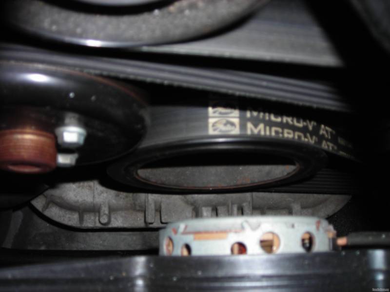

DO NOT RUN THAT ENGINE YOUR CRANK PULLEY IS TOO FAR OUT
I went down to the garage and took some pics and it is clear to me that your crank pulley is too far forward... I will post some pics shortly

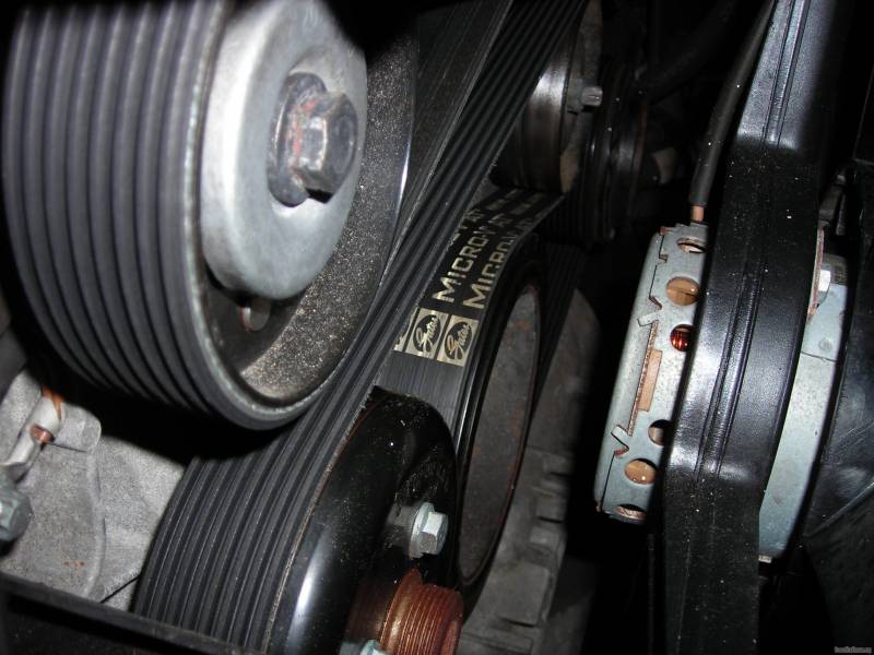

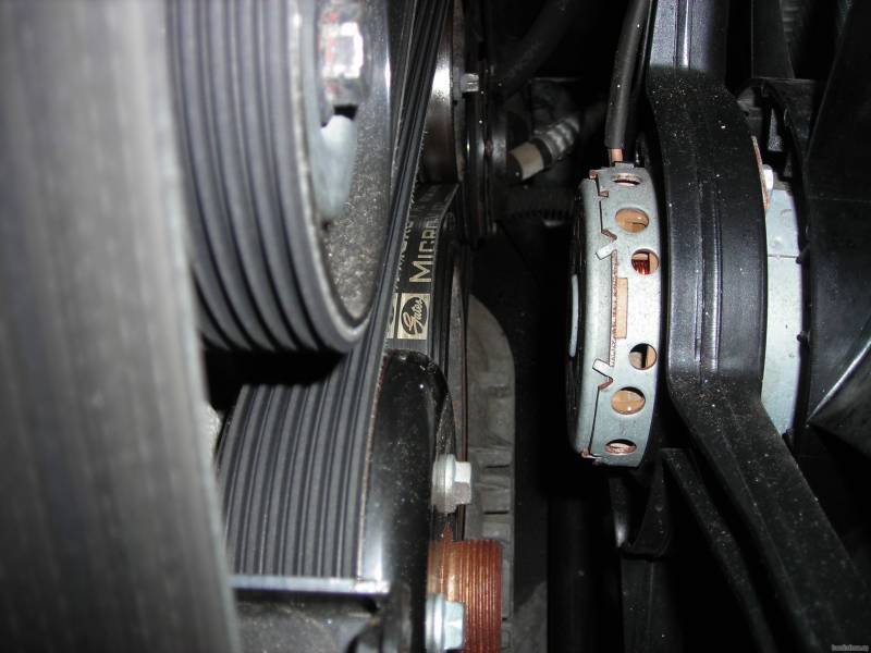

You can see the pulley sets flush not out to the front you can also see the crank sets out further on yours ( covering the ridges on the block at the bottom) you can clearly see the ones on mine

Son of a gun, you guys are exactly right..............after checking all of the pulley alignments with a straight edge it's clear that the crank pulley is out by a lot, probably 3/8ths to 1/2 inch. Damn...........how the heck does that happen? Could the crank be walking out all together or do you think this is just a pulley issue. Oh man this sucks.

I think you have it covered. It looks like the pulley. If you compare your pulley (in post #1) to Howard's (in post #23) you can see difference (visible separation). Your crank/key is probably fine.
