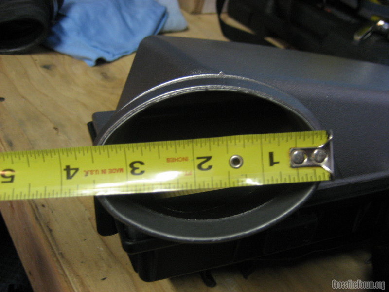

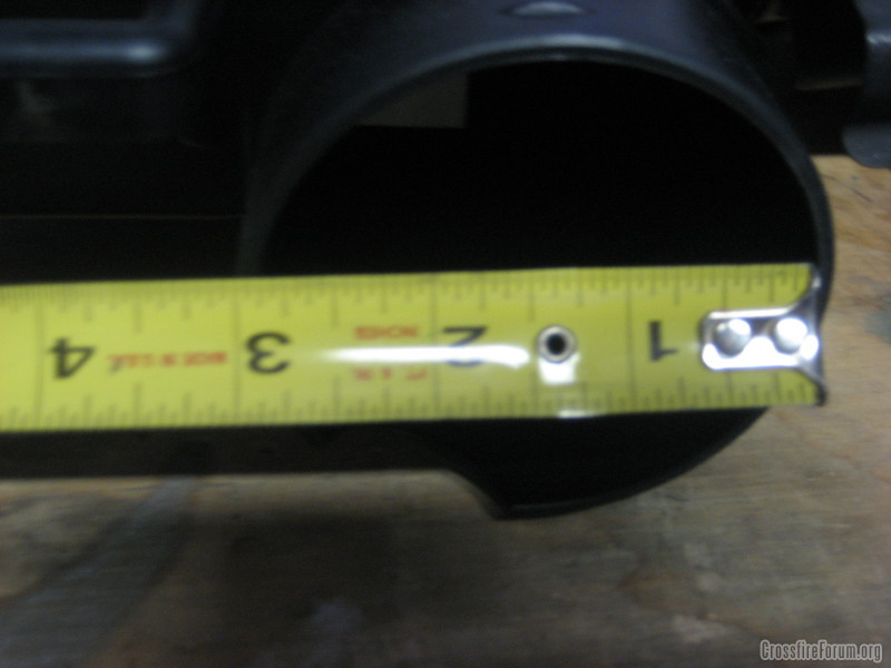

There's also the SL55 AMG Airbox option...
True 3" dual CAI....
brian you well know its only 3" after the radiator support. the intake section is tiny unless opened up. also the double 90* bends disturbs the airflow

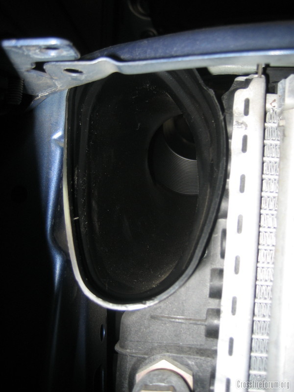

True - but the radiator support openings are the same for any crossfire using any intake. (once the stock couplings are removed.) We all know that one must cut and widen the opening on the divers side to gain the needed clearance to match the passenger side.
Are you talking about the double 90* bends from the filter to the radiator support openings on a NW intake?
the factory opening has a trap door that is very restrictive and has to be removed. this gives you the 2 3/4 on driver side and 3" on the pass side. the plastic ribbed tube also disturbs the airflow
the 90* is the path of the air thru the air box fro the bottom of the box up thru the filter into the t/b
