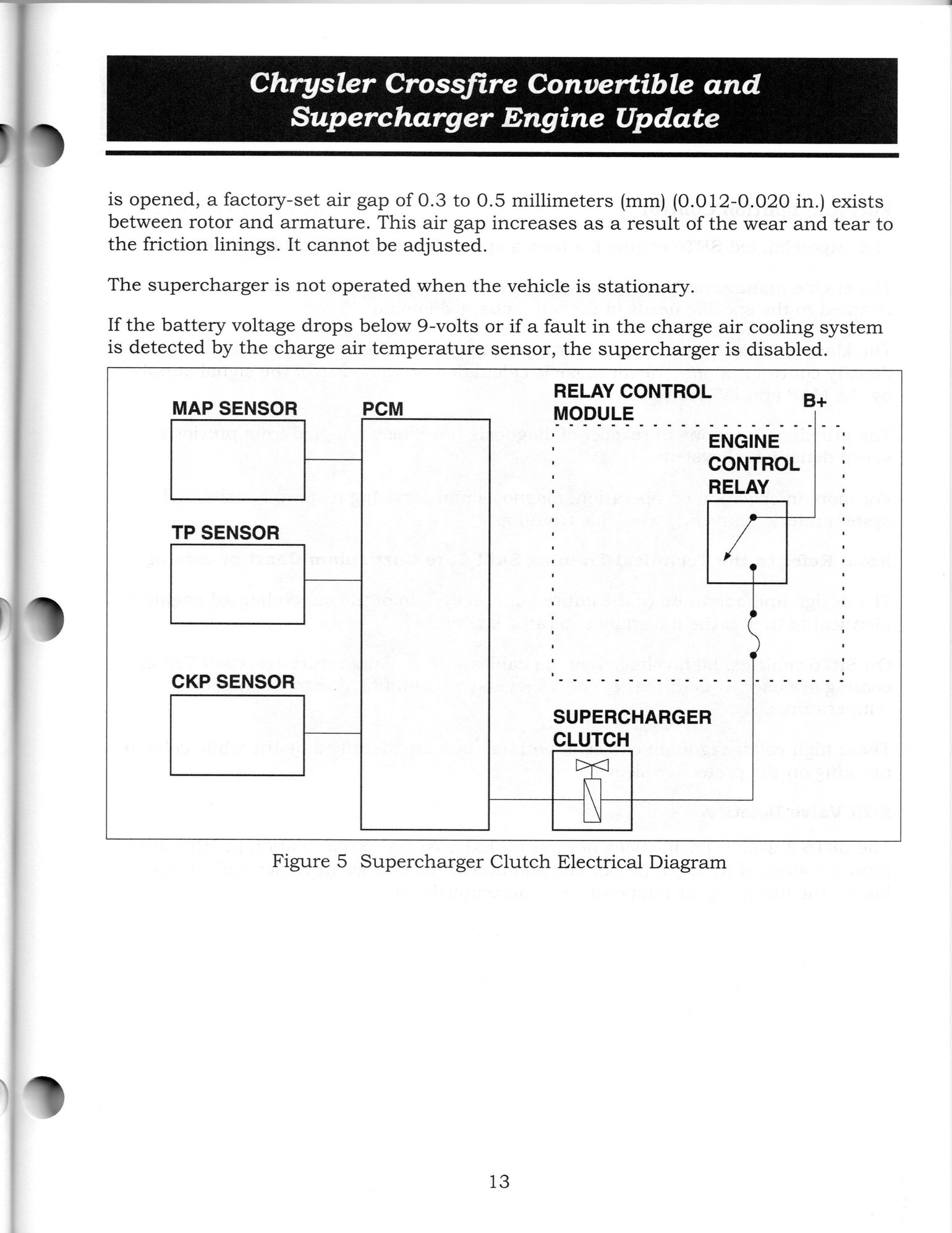

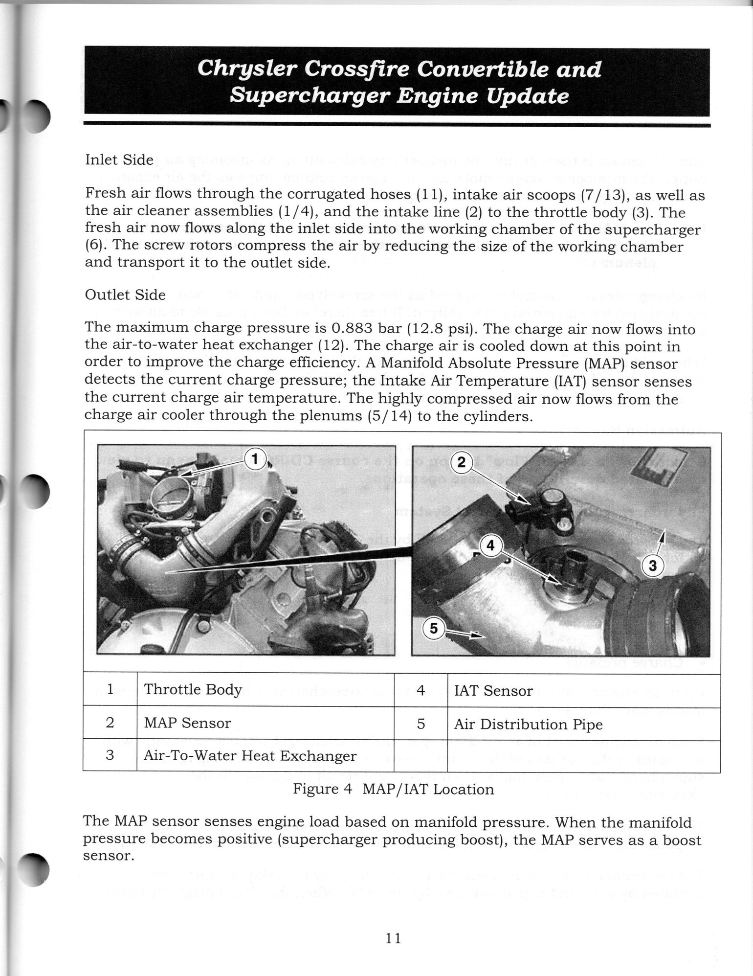

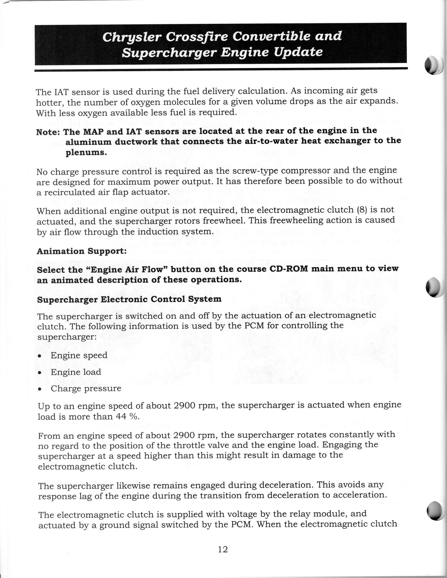

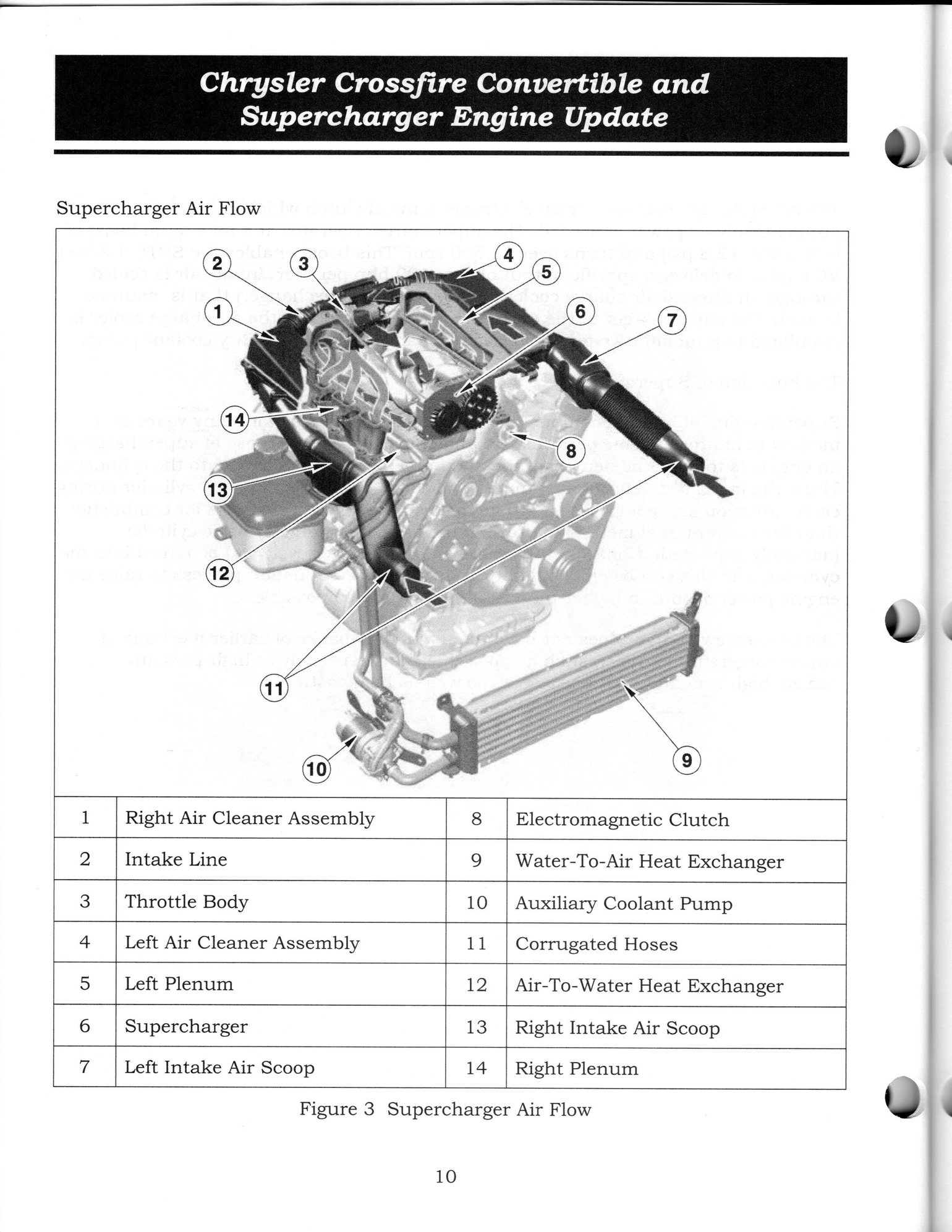

Information from the Convertible and Supercharger Engine Update book from the DCA.
