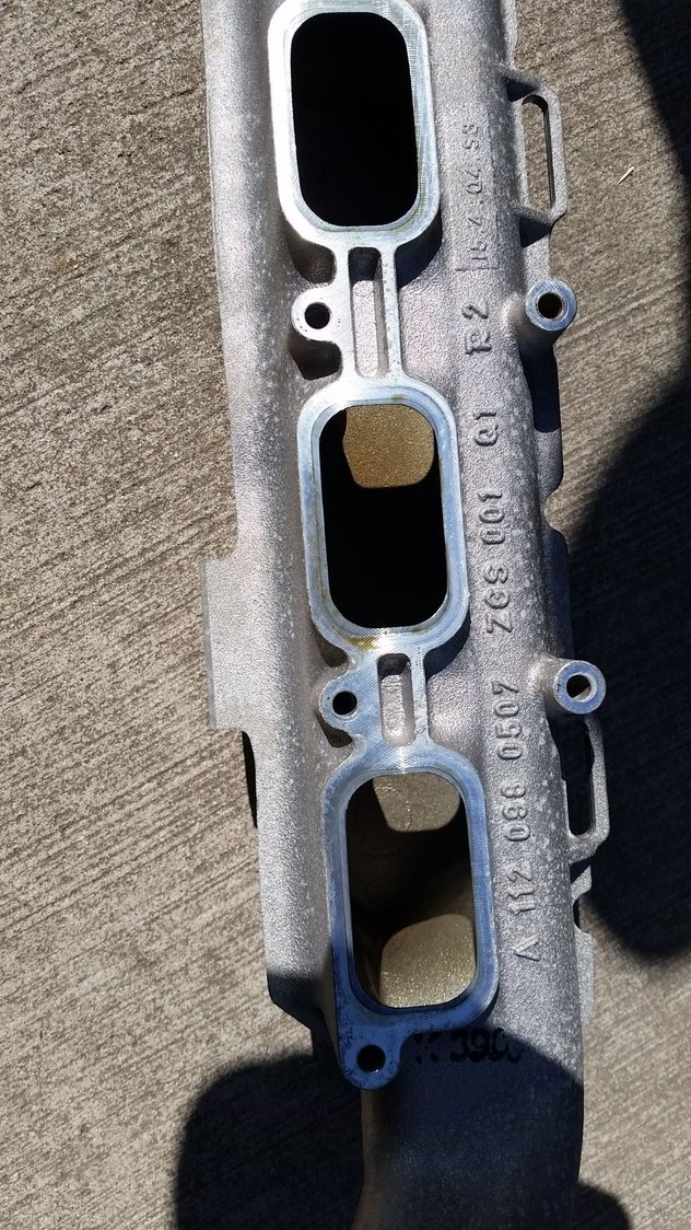

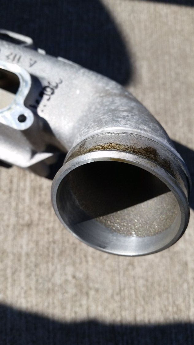

Here's a couple of photos inside the plenum. All I saw was a dribble of oil. Do these look ok as far as leaking intercooler go?
Old Nov 11, 2017 | 02:24 PM
dinasrt's Avatar
Posts: 2,404
From: Mendocino, CA
Default Re: Aftermarket intercooler
Those do not appear to have signs of an intercooler leak; but Rob is definitely more the authority here. Do you have your engine coolant system isolated from the intercooler system? How long does it take to be noticeably low?

your IC is not leaking as your manifolds looks clean enough inside

If your head gasket leaks you OFTEN get bubbles in the expansion tank, but your taking it apart, so look at the plugs to see the color / shades and see if one is STEAM cleaned - different from the rest.
I have cut apart 4 heat exchangers and yours is really clean looking to me.
