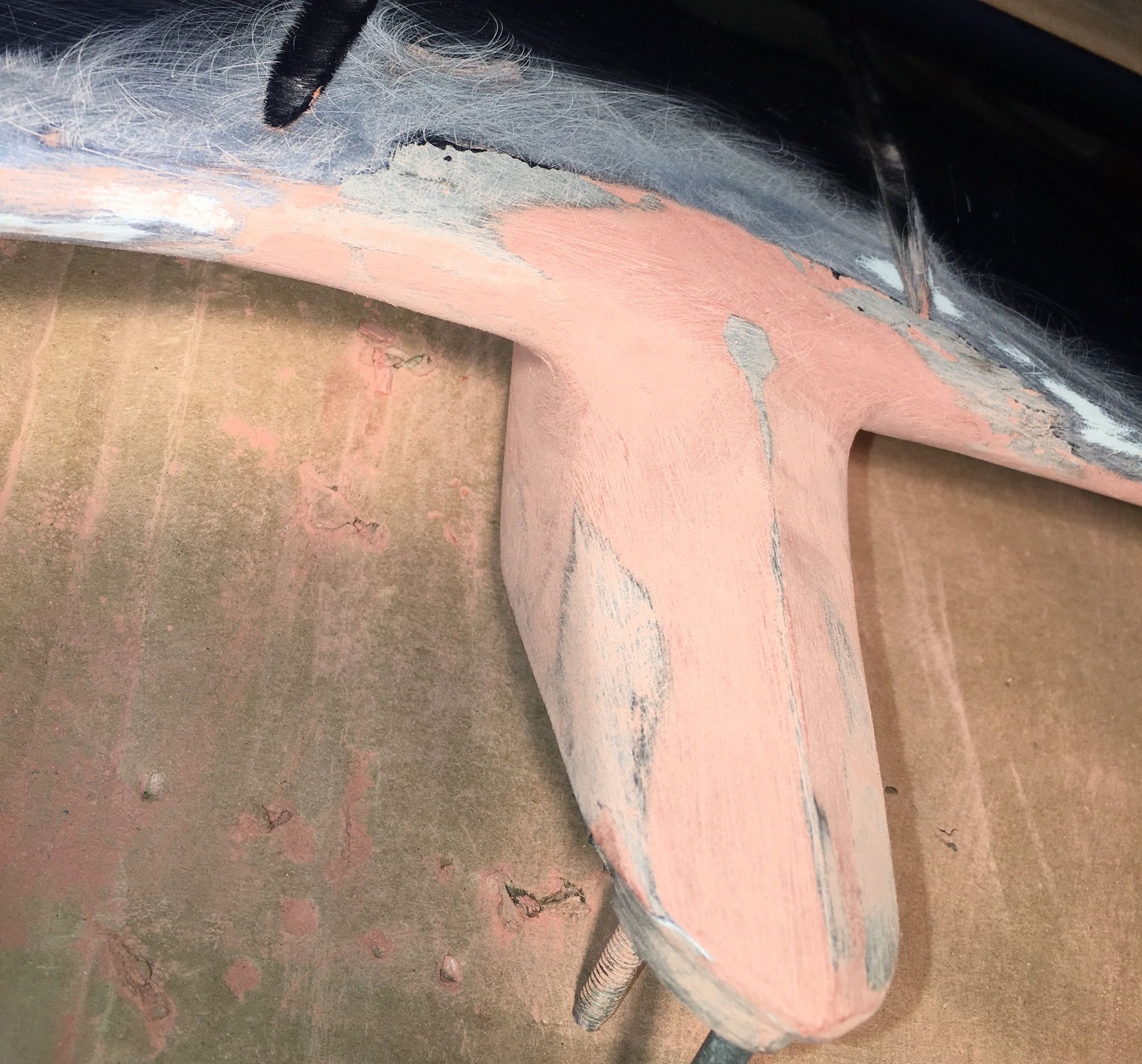

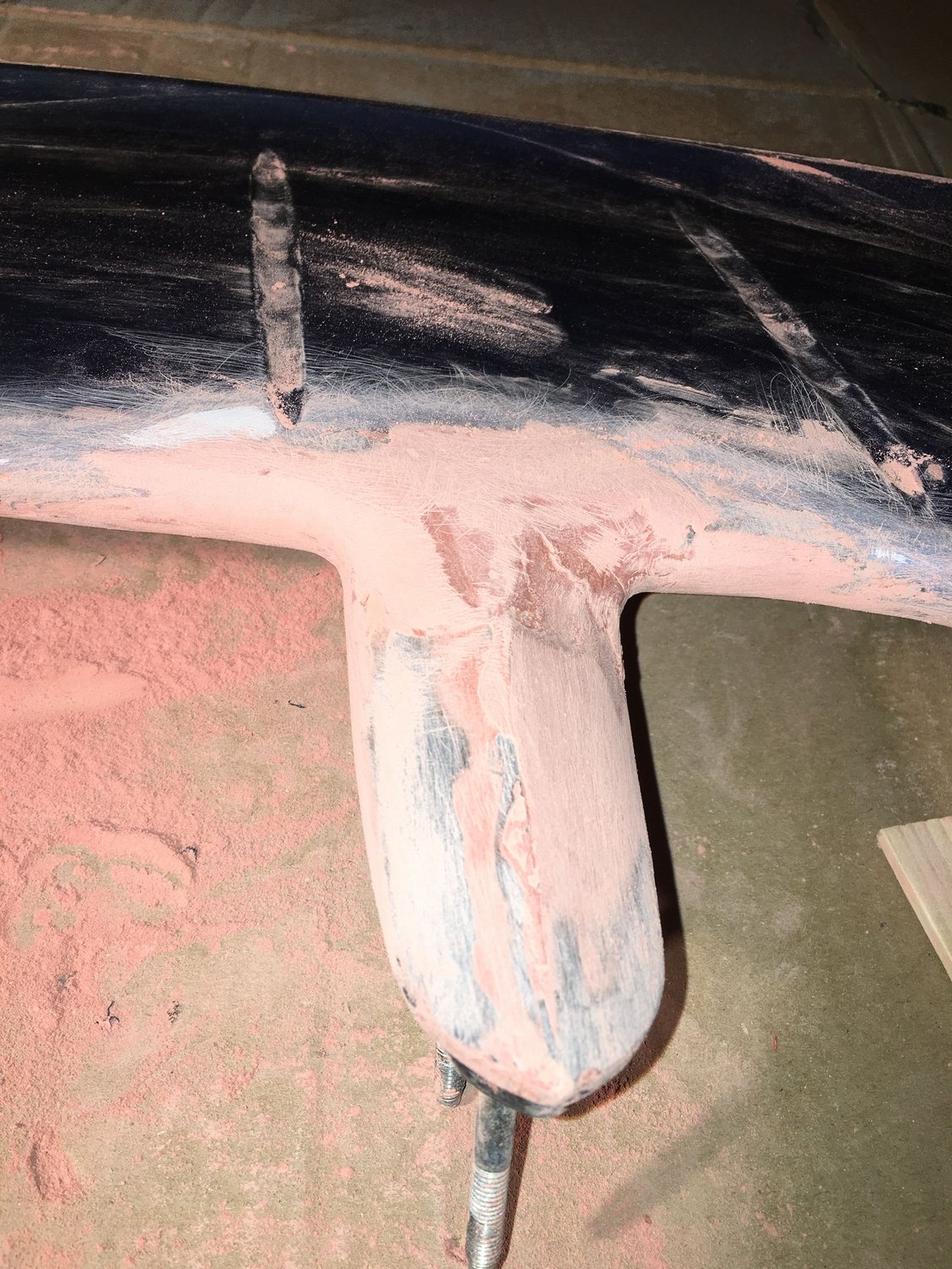

Is the red finishing putty a non catalyzed filler ?
Stick with two part fillers and primers. There's less of a chance you'll have problems with shrinkage and blisters later on down the road.
Great point.

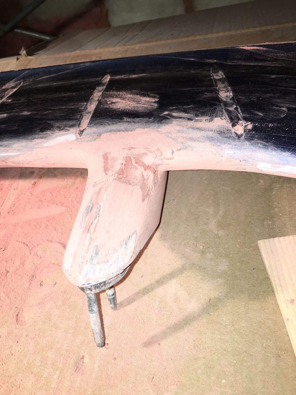

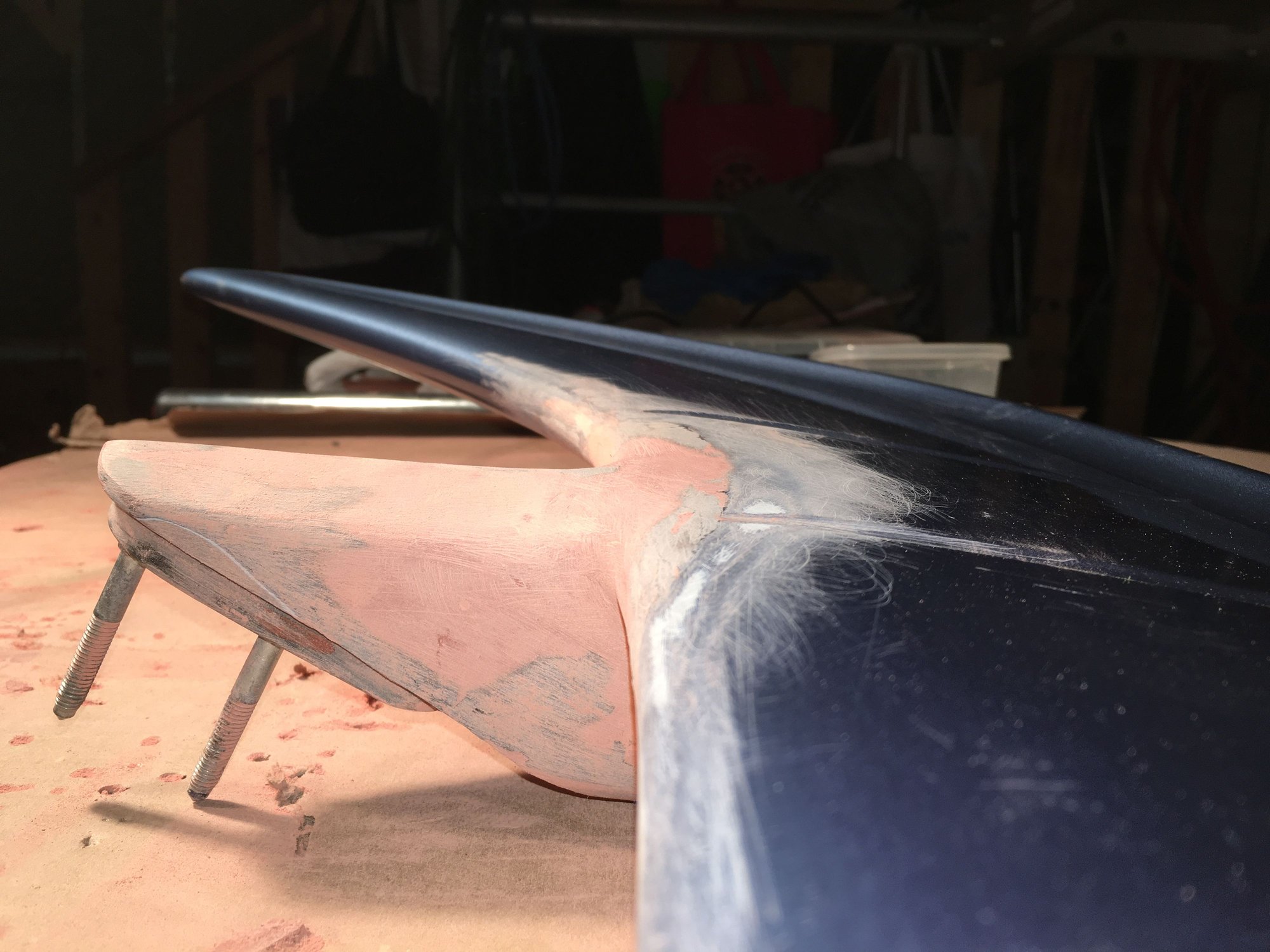

Non catalyzed
I had taken that into consideration when I began. It really is being used, as intended, to just fill in the voids before I apply the carbon.
most of the spot filler has been sanded away
The structural adhesive is doing all the work. The carbon and Resin will finish it off and it will never crack again
I’ll let you know how it holds up over the next decade.

Originally Posted by UrbanE
Great point.
Non catalyzed
I’ll apply the last round of filler over the weekend. Shaping and carbon over the next few weeks once it warms up.

Default Re: SRT-6 Roadster Fixed Wing

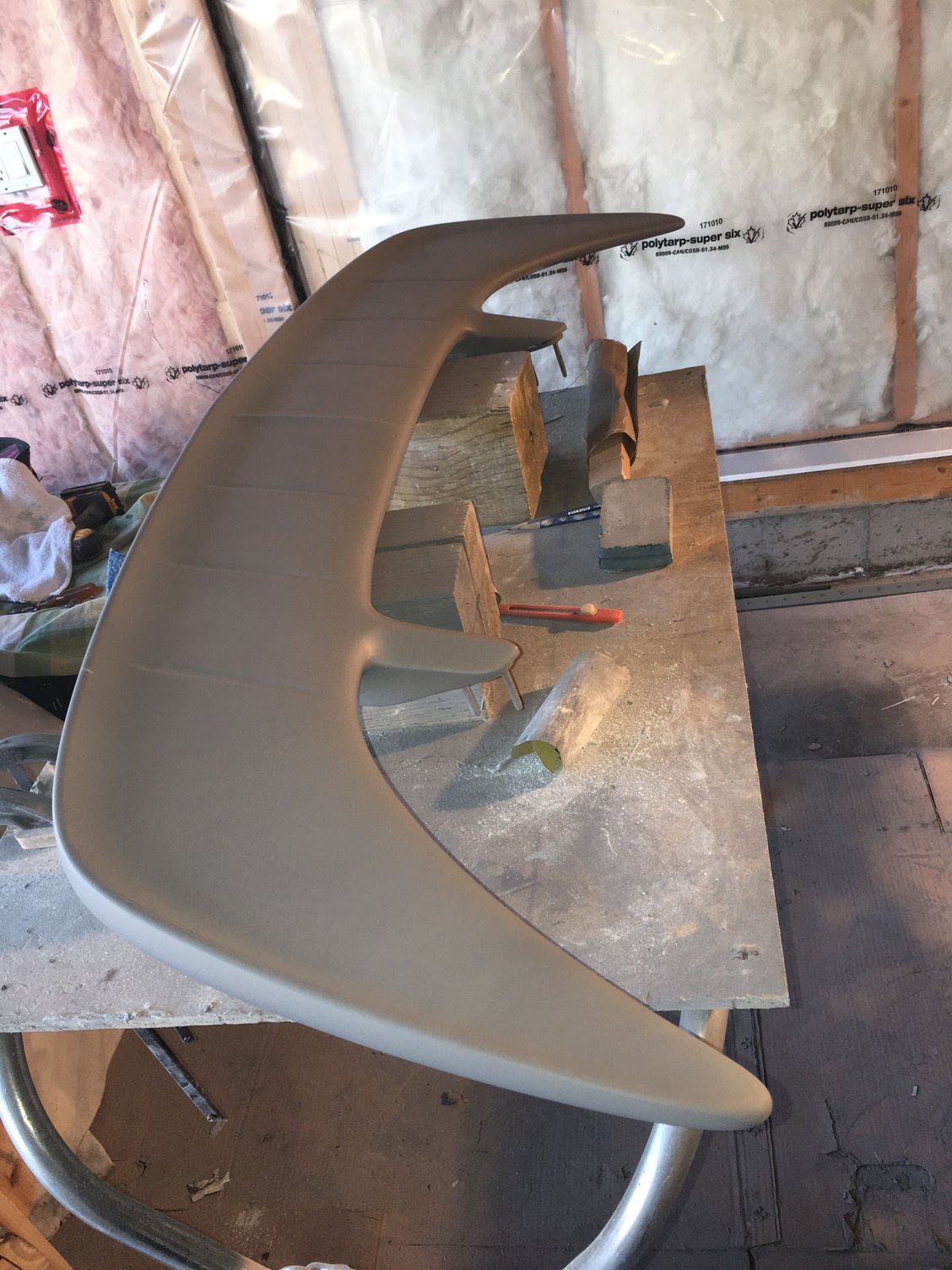

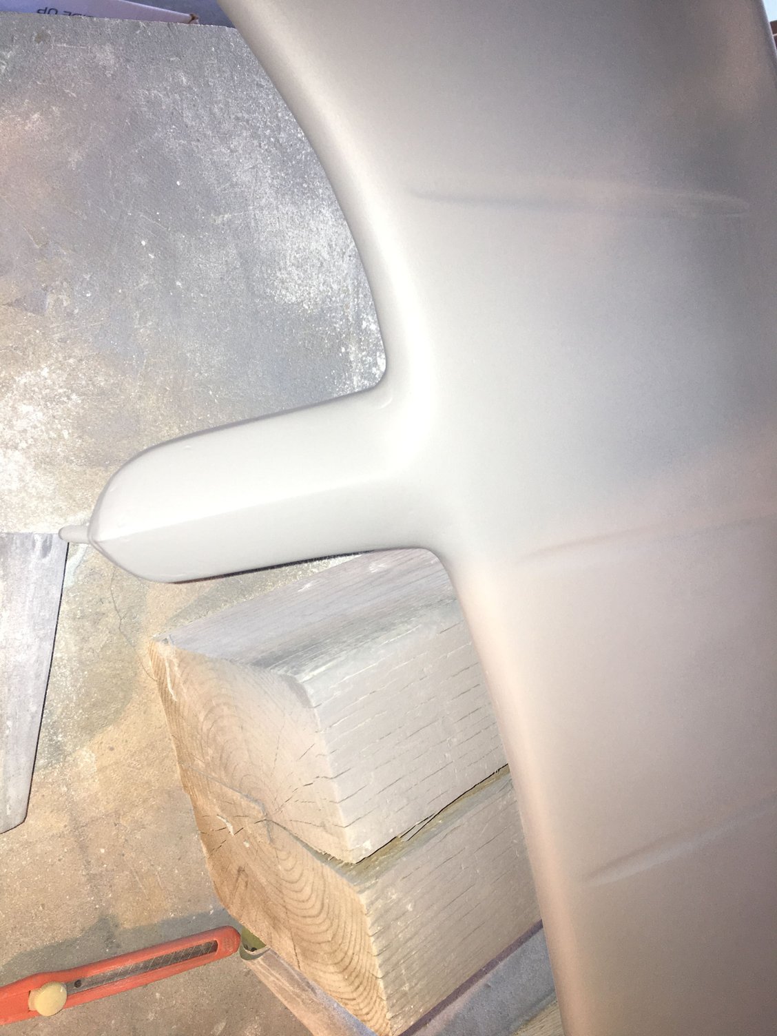

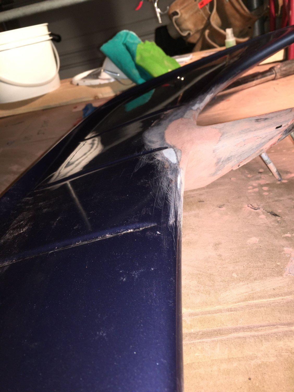

Finished shaping. Ready for Carbon
Project progress
carbon fibre complete
2 coats of resin
filler tomorrow
should be be ready for paint by the weekend.
It will never crack again
My first time working with Carbon fibre. Super easy. Lots of tutorials on You Tube.

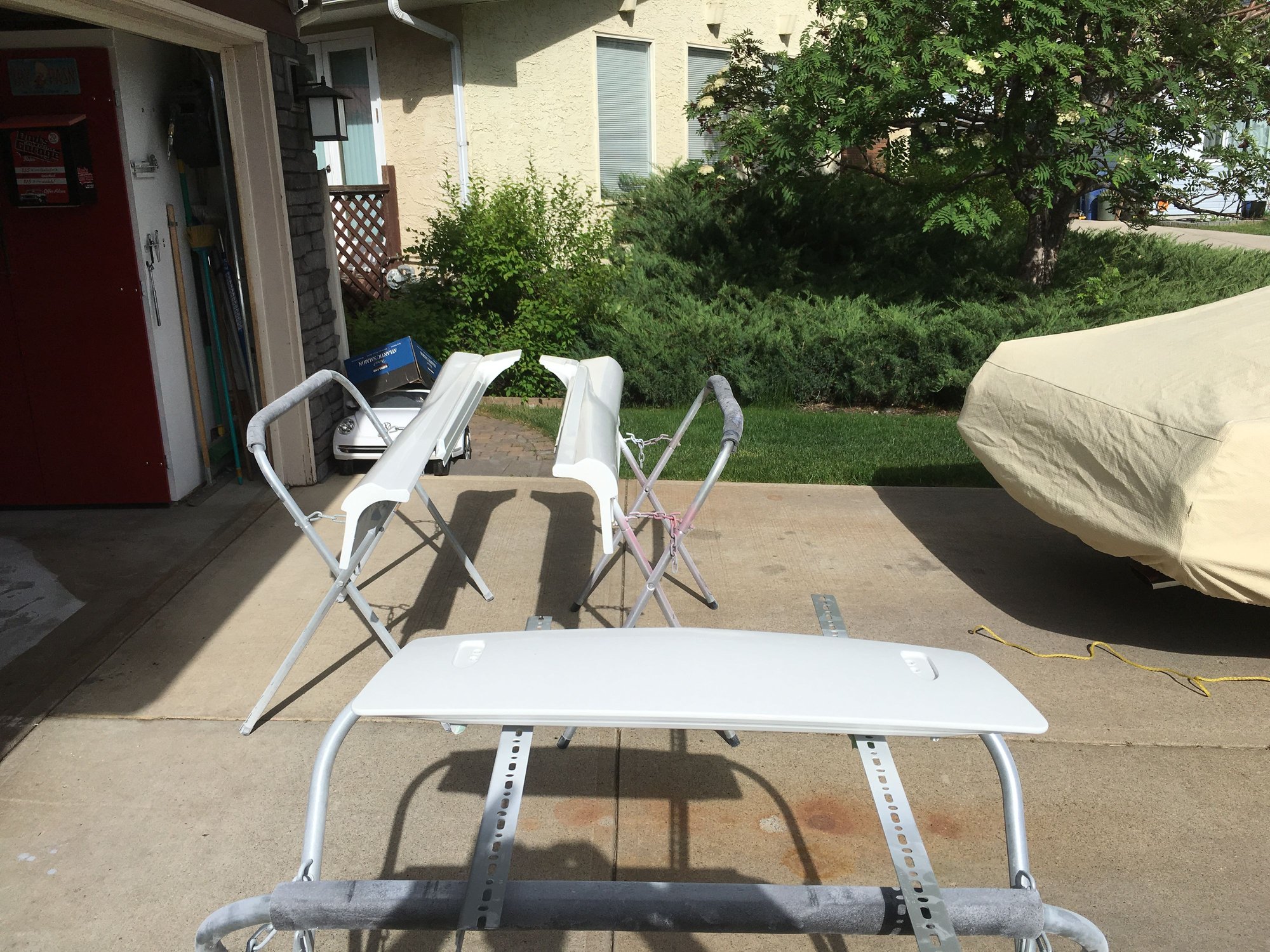

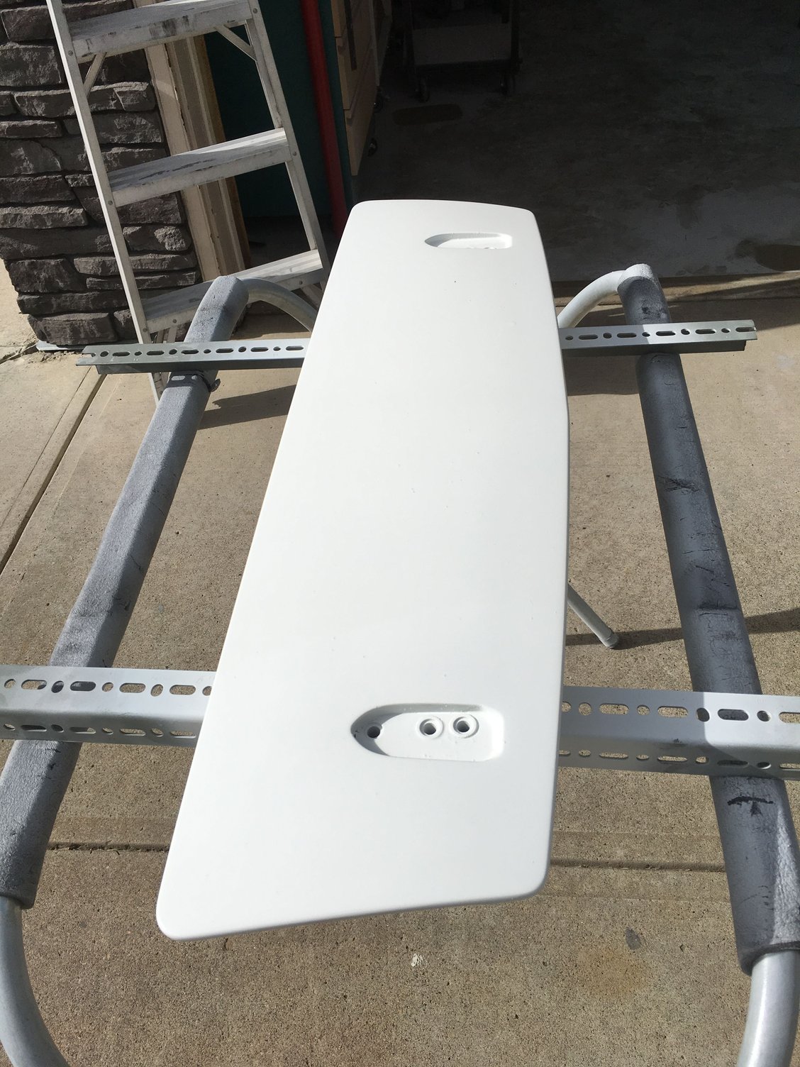

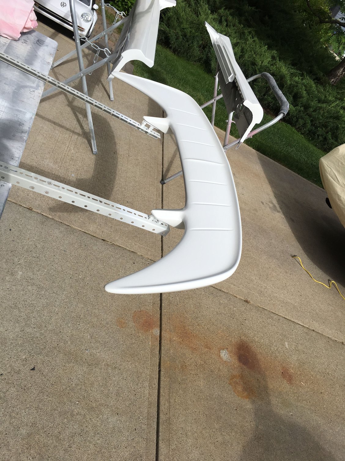

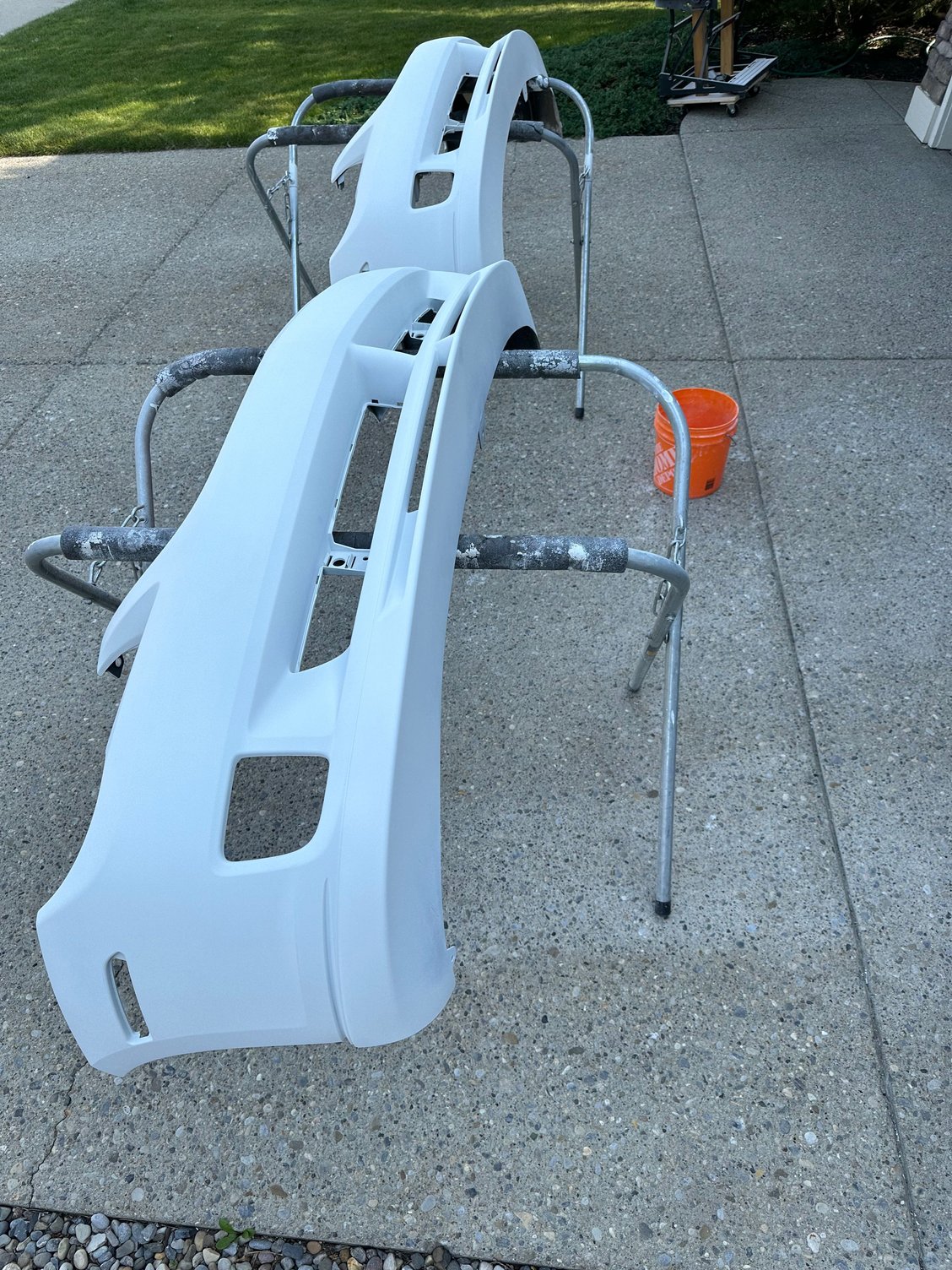

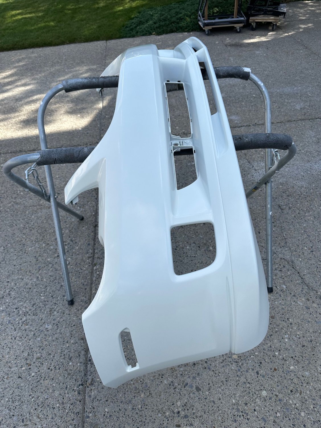

Painted
wet sand and buff today
3 coats paint
3 coats clear

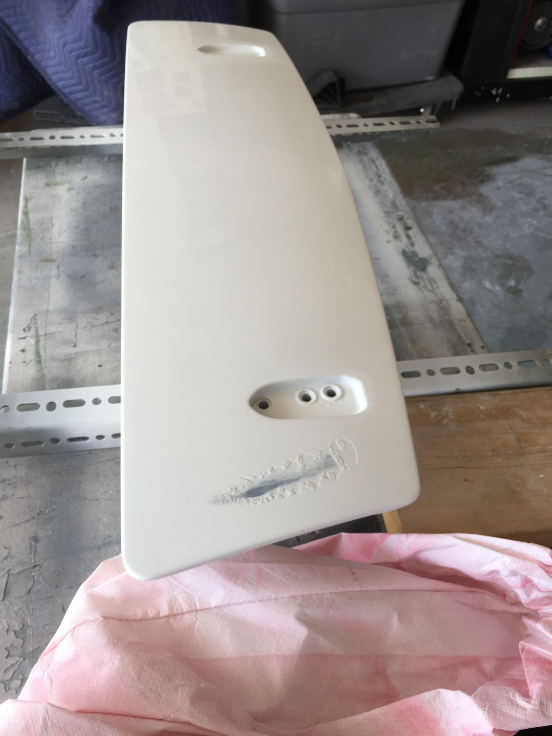

First word that came to my mind
fire truck. Condensed version
impatience added another 3 days to the project
last pass with the buffer
It was like glass
It was like glass
Ouch!
Old Jun 16, 2019 | 09:10 PM
UrbanE's Avatar
Joined: Dec 2014
Posts: 1,246
Likes: 296
From: CA

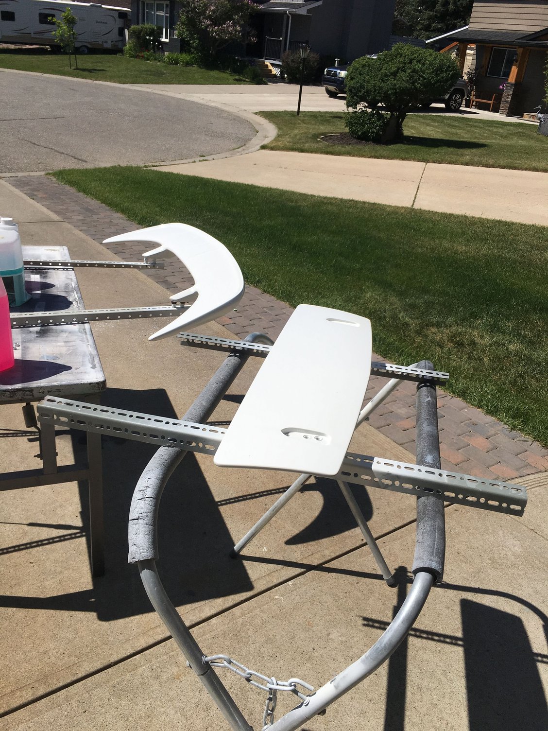

All better today.
Perfect day. Laid up the repair outside
im just going to leave everything to cure until later this week

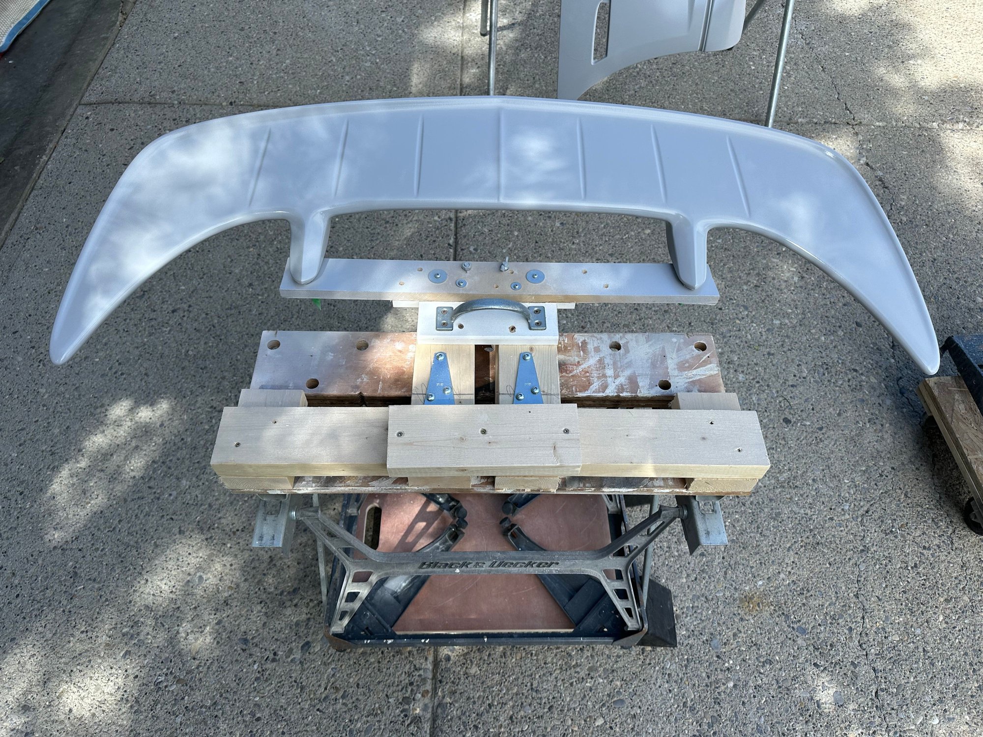

As it happens, I was painting wing and 2 bumpers today
send me a PM with your questions.

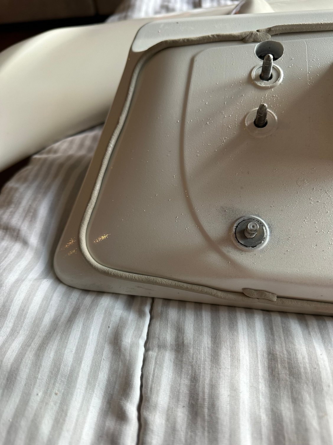

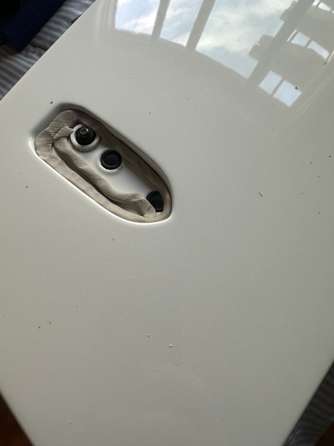

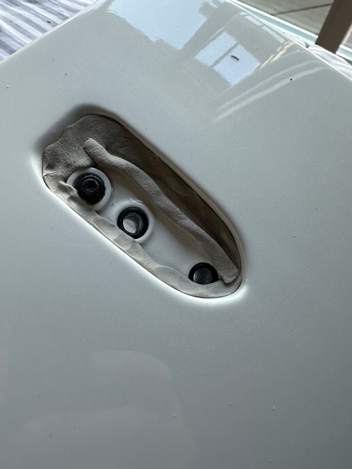

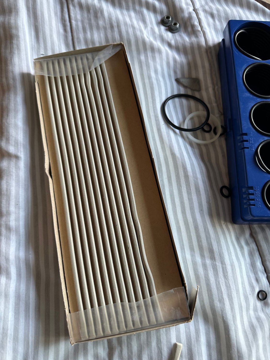

Completed everything today (except for the stuff I need to do in the spring) and wanted to share my approach to a leak free wing and deck plate. I used the same stuff 5+ years ago and never a leak.
Dum Dum strip Caulk by Proform. The box should last me another decade
I applied it around the deck plate and at the base of the stanchions. I also replaced the small rubber o-rings.
I also applied a small piece behind the seams to ensure a solid seam. This stuff is NOT an adhesive. It’s like plumbers putty. It doesn’t get crazy hard and it’s easy to remove.
when you tighten down the deck plate, this stuff will compress and take up any irregularities.

Forgot to add image with caulk strip in deck plate where wing is attached.
