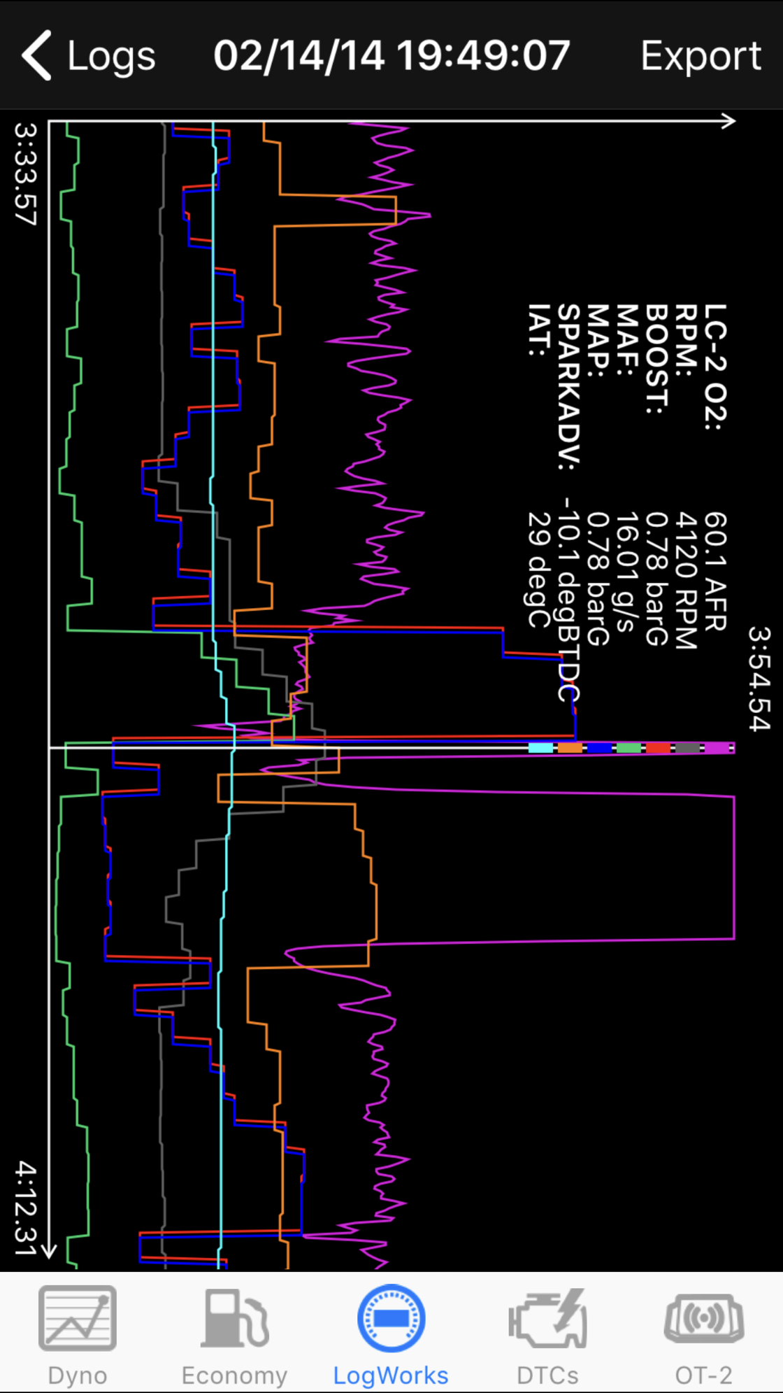

I attached 3 logs when it happened, the afr look as if I released the gas pedal for a second, map suggests that the supercharger was disengaged.

There are quite a few step changes. Were you driving at a constant speed or doesn't it happen then ? TP (throttle position) only is in the last one. Need some explanation of what was happening when.
I have just changed the TB and it is not the source of the issue. So I am still trying to find it.
Well it does two things, the charts above depict the sudden loss of power that lasts not more than one second. It feels as if the supercharger was disengaged or there was no fuel for a second. It occurs while accelerating mildly or during wot. It also happens quite often.
