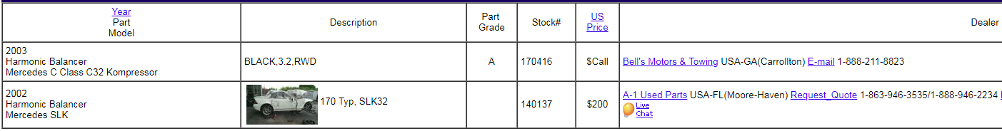

Default Re: Harmonic Balancer
There are however 2 listed on car-part.com :
