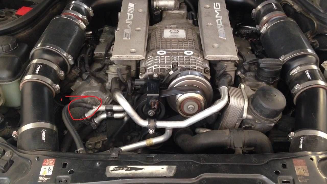

opened the hose and drained, while adding water at the same time. First it was coming slowly and stopping from time to time, I drained it until the water started coming stopless and with better pressure. I circled on the picture the hose I detached while draining

Detach the hose circled. Pinch the rubber hose after the Y (return line) with the car running. See all the air come out!
