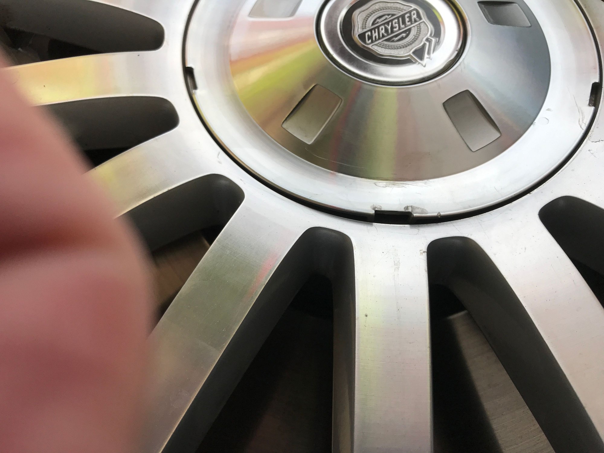

Hi,
I left my car at the garage today to install new tires on my 2005 SRT-6 convertible.
I take care to ask at my appointment if the garage have the special tire machine that don't touch mag wheel. and they said yes. So go for it!
Result: Tire look great and run well.
I realise tonight at my home one hub cap is not installed properly.
After inspection of 4 wheels: the fu*** mechanic ruin all 4 hub caps by prying it and bend them. So now they don't fit properly and bend is apparent.
Stupid guy GRRRR!!!
Any idea were to find new ones or a place to repair them?
I joined pictures of cap.

what bends them is they don't line up the slot in the cap with the cut-out in the wheel and hammer them on anyway.

If i understand well, they have a precise position for installation? Hope it was just that!
OK i will try to remove them and reinstalling them tomorrow. Thank's !

Yes, do so, but it won't help the bend they have already done to the locator tab portion

A great quality wheel repair shop can pound these back into shape.
Ive had to have mine reworked for the same reason.
Watch ebay or call rob at needswings for replacements
prepare to open your wallet wide.
Thesebdont come up up very often. Take them off with plastic pry tools before your next trip to the tire or brake shop

Today i removed all hub caps. With care, i have succes to straighten them and reinstalling it. Like Ala_xfire mentionned previously, they are bend because mecanic guy don't pay attention to align them with the **** in the wheel.
Problem solved! Thank's for the trick!
