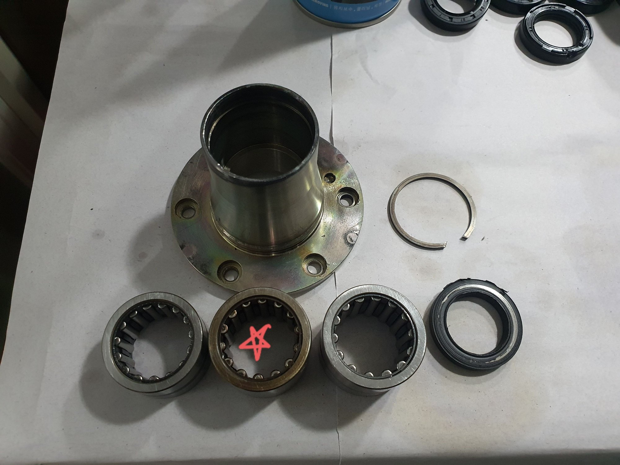

did your oil leak got fixed with new bearing?

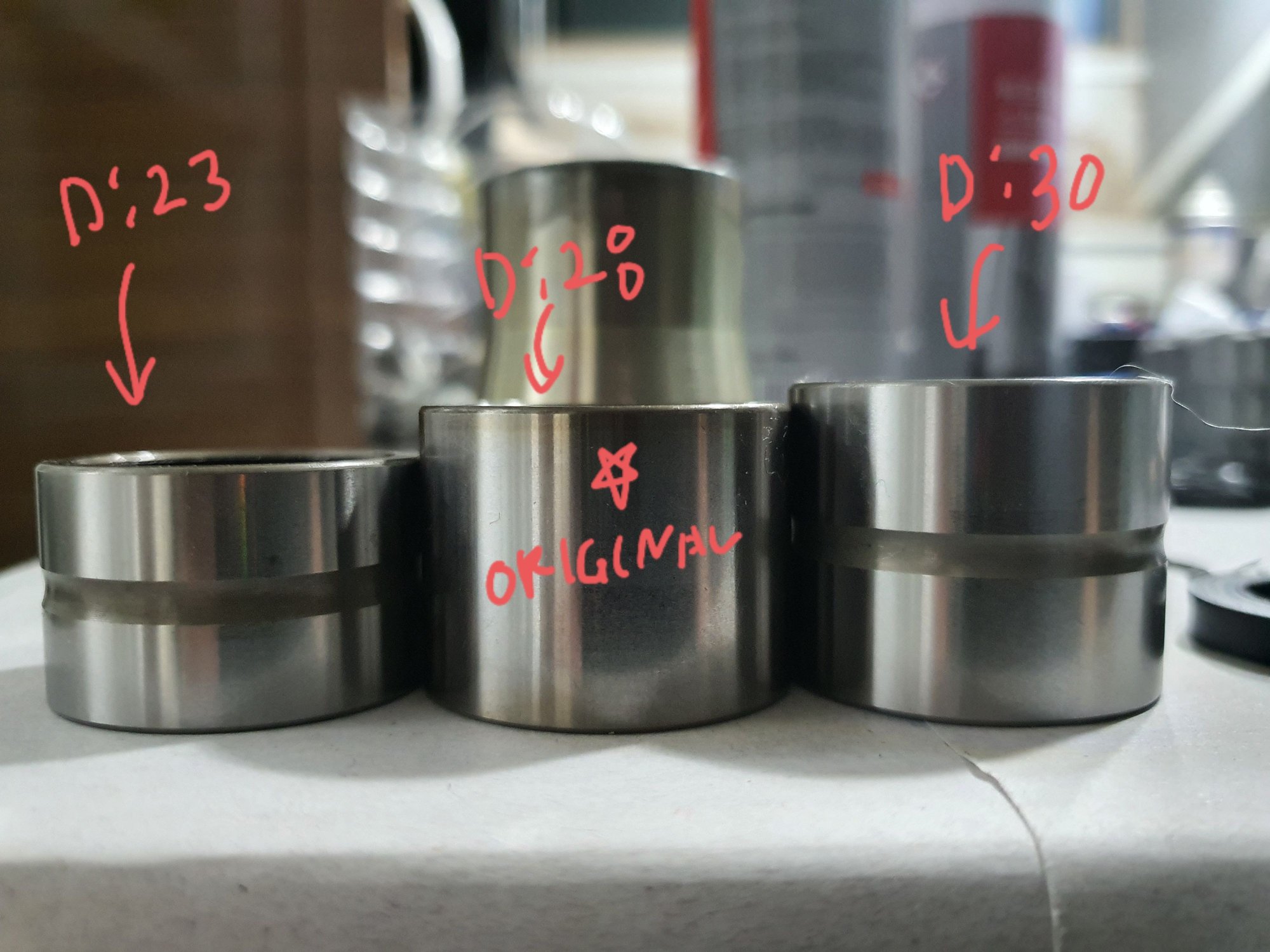

Unfortunately not yet, but I am using another used supercharger from ebay.
Spec. of the needle bearing is
In dia. : 25mm, Out dia. : 37mm, Depth : 28mm.
I found D:23mm and D:30mm which In/Out is same.
But could not find D:28mm.
Can you find the original size?
If we can not find D:28mm, D:23mm can be alternative.

I never took out that bearing when it started leaking, just used a new oil seal with 2 springs inserted, been 2 years and 30,000 miles with 62mm pulley and hundreds of pulls. still bone dry. knock on wood
But If I can find the oem size will let you know

thats not available anywhere
but it can be repaired with brake lining
Old Oct 20, 2024 | 12:28 PM
srt6prbk's Avatar
Joined: Jul 2021
Posts: 19
From: puerto rico
Default Re: All components of SRT6 supercharger.
scrap all the lining , then use 1/8 or thinner brake lining and cut it to fit, then use adhesive for lining, then sand down the part that sticks out, until leveled . did that years ago a still working perfect. I think I have photos
