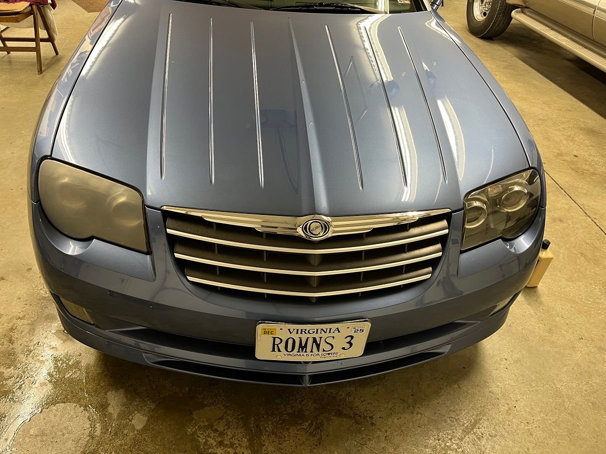

koolub2, Have you considered sanding and painting the existing headlight lenses with clear polyurethane paint? I have done this on several vehicles with plastic lenses, including my '05 Crossfire shown below, and they look great. If polishing has given you decent results (meaning oxidation and cloudiness are on the outside) but doesn't last long, try sanding (wet, with 400 grit) then painting with clear polyurethane. After the sanding process, the lenses will be practically opaque white, (see left headlamp below) and you will wonder if you have screwed up. But when you spray the clear paint on, the clarity will come back better than polishing of the old surface did. (See right headlight).) And the better quality the clear paint, the better the result and more UV resistance will be. I used automotive 2-part clearcoat, but I have also seen great results using a hardware store spray can of clear. Good luck.
