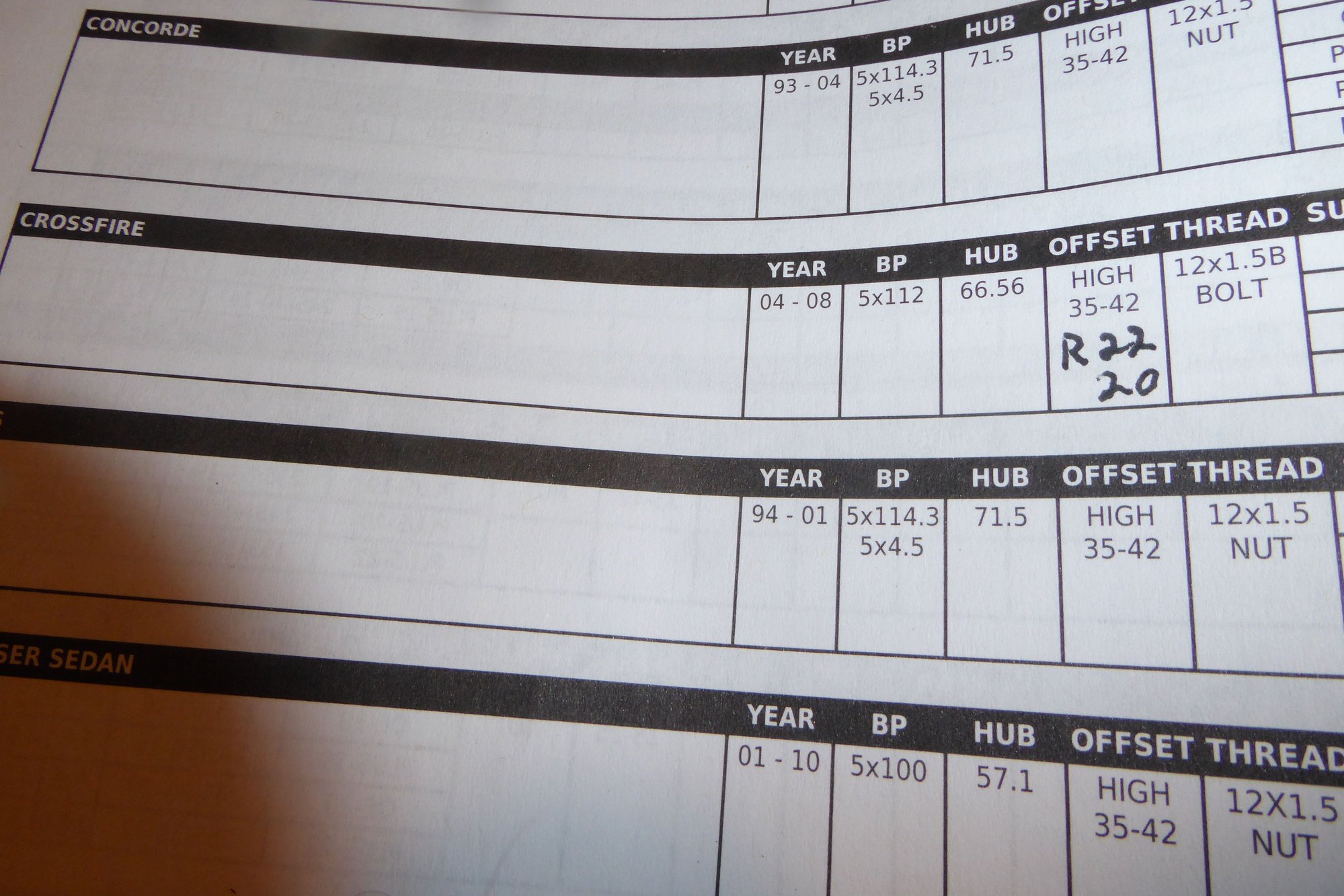

I also have 235 on the front ,,and 275 rear, I just never liked the 285 the 235 and 275 ,when looking at the car from the side
I like the look , had 225 on the front and it lowered the front bumper 1.5"
Stock 255/35 are 26" tall,,,,,,,the 285/35 are 26.9 tall the 275/35 are 26.6,,
and for the front , the stock 225/40 is 25.1 tall,,, 235/35 is 24.5 tall,,,235/40 is 25.4 tall
Yep i have the book, hope this helps. the two pic with R 22 is the crossfire the 22 is the stock et for our stock rims. jim
