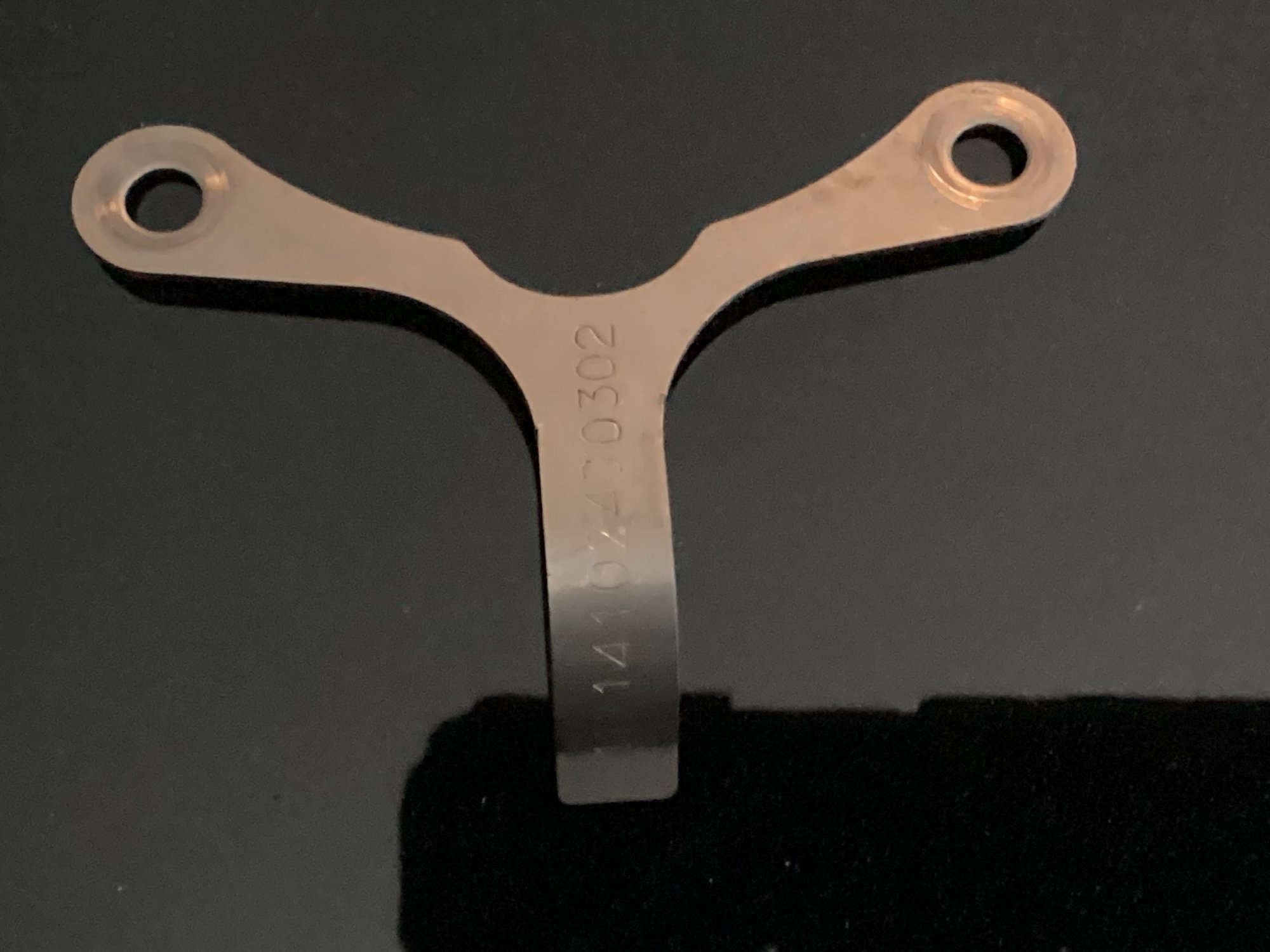

I forgot how this mounts on my srt6 throttle body. Please help

@VaderMarine It fits on the bottom two mounting screws with the tang pointing down and the bend on the tang faces forward. It helps hold a hose in place. It is the last thing you put in place before placing the screw through the hole and tightening the throttle body in place.
Hope that makes sense.

Thank you. The piece appears to hold up the hose which plugs into the throttle body.
