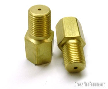

this is a restrictor for the oil supply for garrett turbos:
more and more turbos now come with these built into the casting of the unit rather than requiring you have a restrictor on it like this... ideally this restrictor would be fed at 40 psi.
