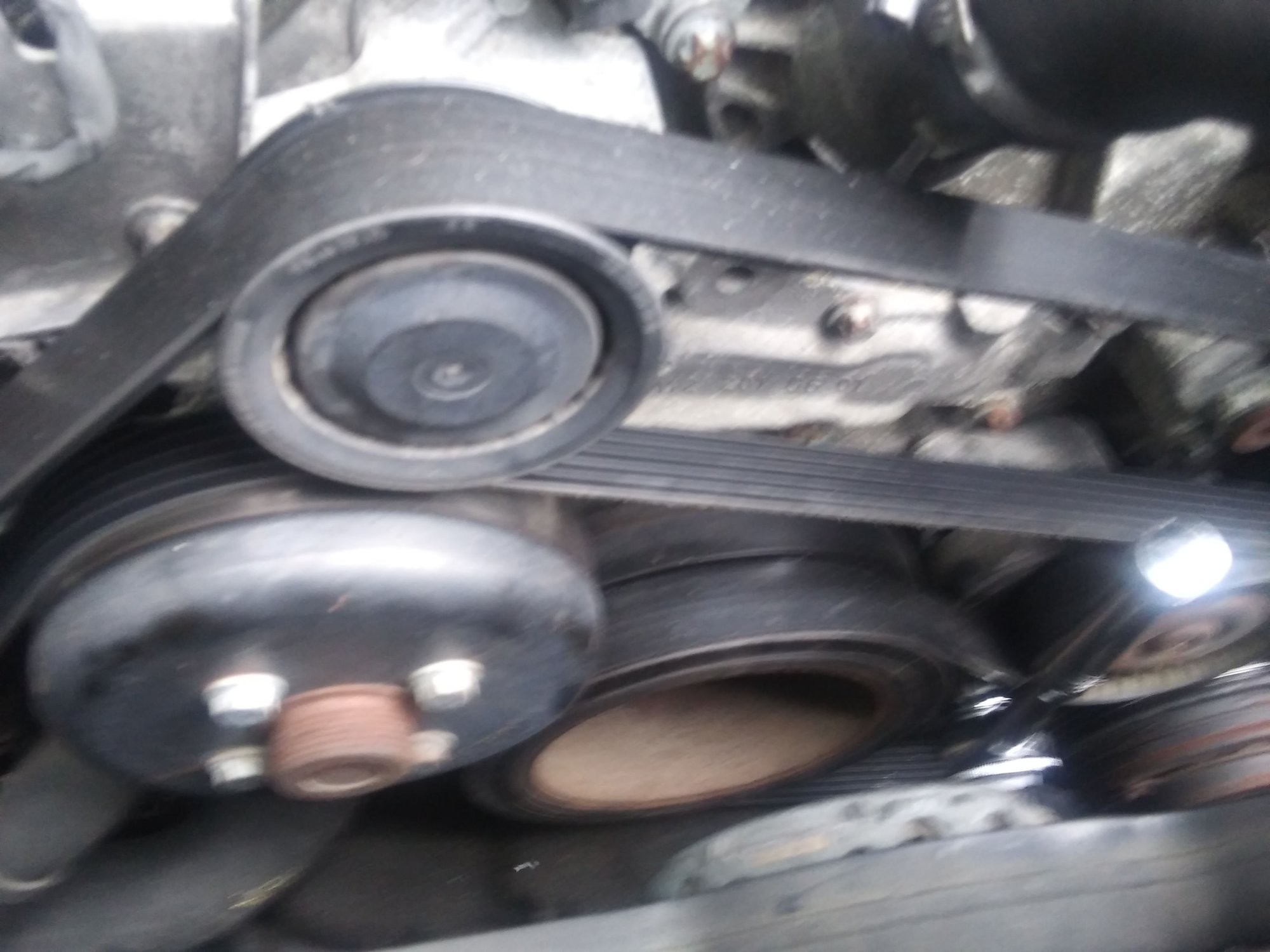

Here is something I came across in the PDF files...
Hi all. I know it's now 2022, but I'm thinking at this stage these crossfire are more and more for the DIY owner. I just want to add that Yes... The limited is as described 17mm socket to the bracket very tight to the pulley at 7oclock in my case. You can find it blind once feeling the area. I used 3/8 ratchet and a jackhandle as a breaker just for the reach. Might be the easiest serp I've ever done once removing the aircleaner for whatever access that afforded. I'll add 2 pics of the scene if that helps.
Limited 2008
2008 limited

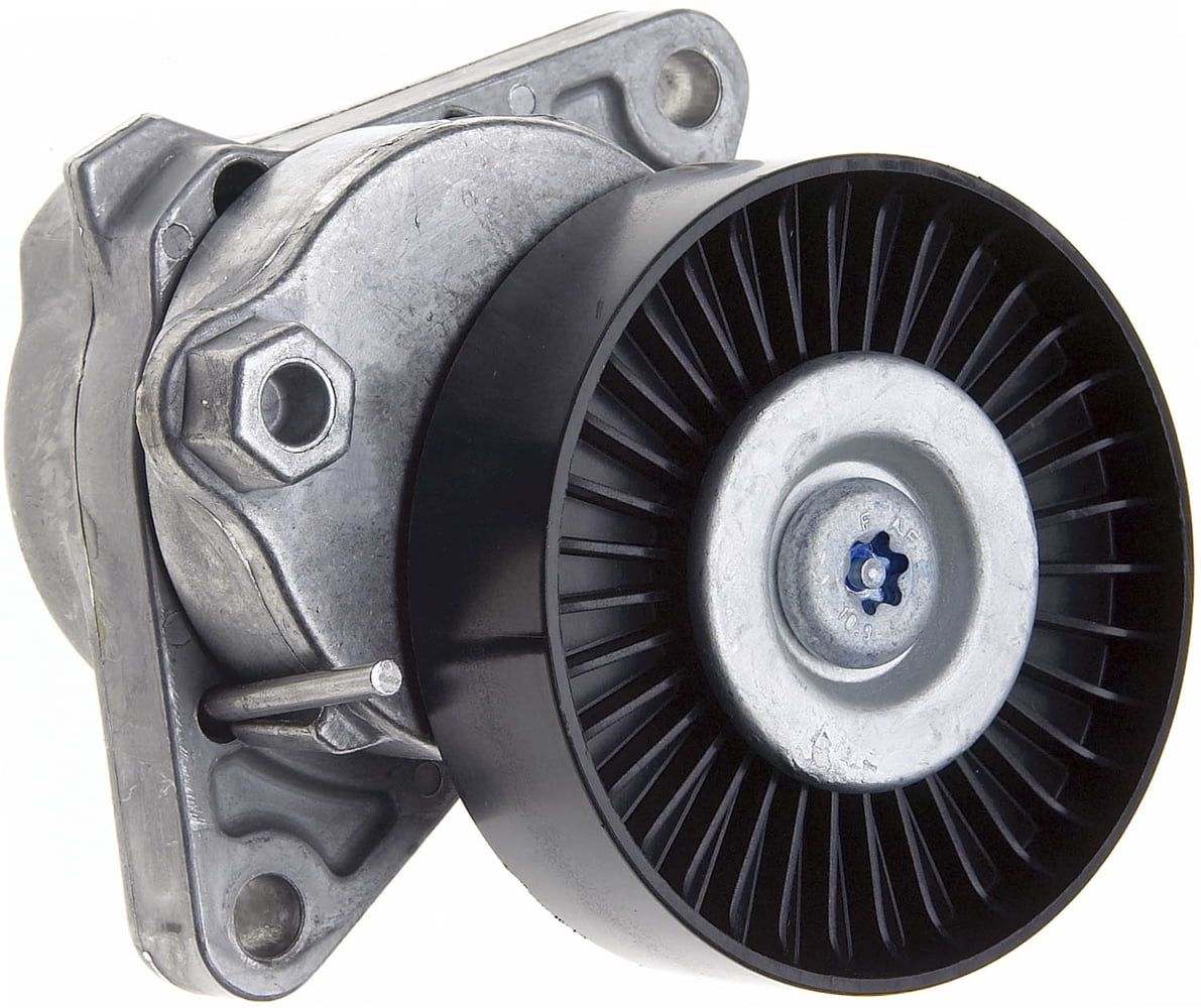

Originally Posted by MacCrossfire
Mine is not a 17 mm socket, looks more like a female torq, the cent of the torq must be hollow? Any idea?
Here's a picture of a base, limited or special edition belt tensioner. This requires a 17mm socket on a breaker bar to release the tension.
This is not for the SRT6.
