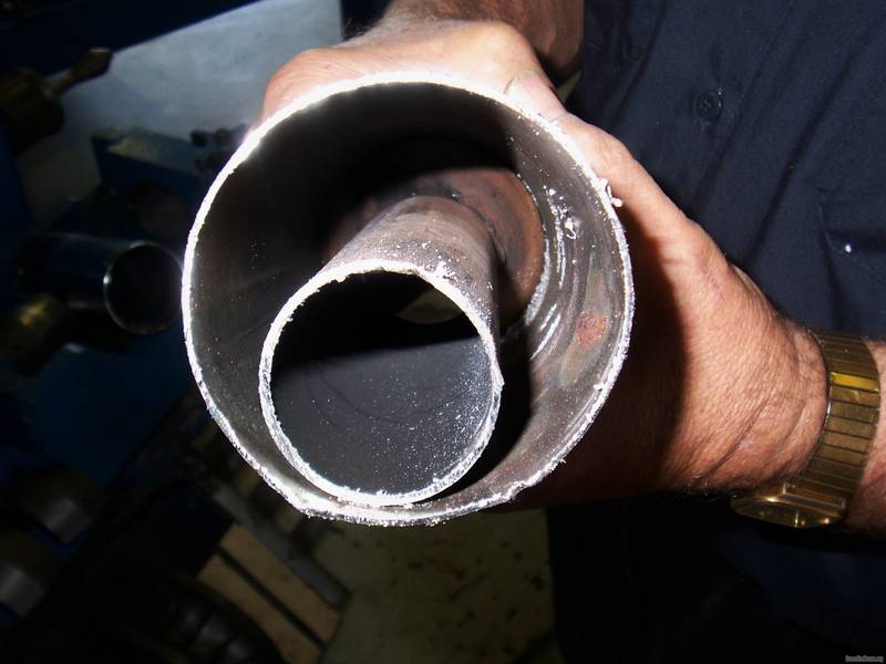

After seeing this I knew that I had to bring back that classic OEM look so I went back to my local custom exhaust shop who did my original install and with a few pics and a skilled exhaust technician/welder I now have the OEM look with that great Ansa sound.
Ansa with the tips cut off
OEM Muffler with tips cut off
Ansa Tip - Inside view
OEM tip (back / inside view)
Removed exhaust from first rear flange
Tack Welding the tips for alignment
OEM tips welded to the Ansa Muffler
Finished Look
finished Look
Finished Look

Thanks for the pics, any change in muffler tone? Still no drone?
Old Jul 25, 2009 | 08:14 PM
Default Re: Ansa Muffler Modification - OEM Tips
ABSOLUTELY NO CHANGE IN SOUND AND STILL NO DRONE !!!

Good to know. You are probably the only one that has heard this muffler both ways. I remember in the old "ANSA group buy thread" someone whacked the ANSA tips off but thought it was way too loud. I still haven't installed mine but I may have to rethink it. I was thinking about a custom filler panel but really like the OEM tips better. Fits the space well. How much time did it take to complete?
Old Jul 25, 2009 | 08:40 PM
The shop owner did this job and spent about 90 minutes to complete it.

I was in the shop the entire time they did this mod and we took our time and made certain that the tips were centered and straight before the final welding was done.
Actually I noticed I took one of my pics slightly off center but these tips are right on the money.
