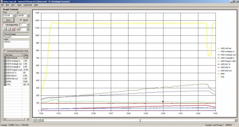

Then I started getting a couple of new errors; pressure sensor and a supercharger malfunction error.
So I collected lots of data, printed out logs and fault reports. Fried my brain looking at them and decided to take a break and develop my tuning tools and process.

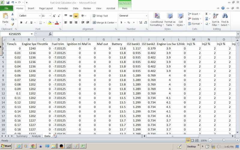

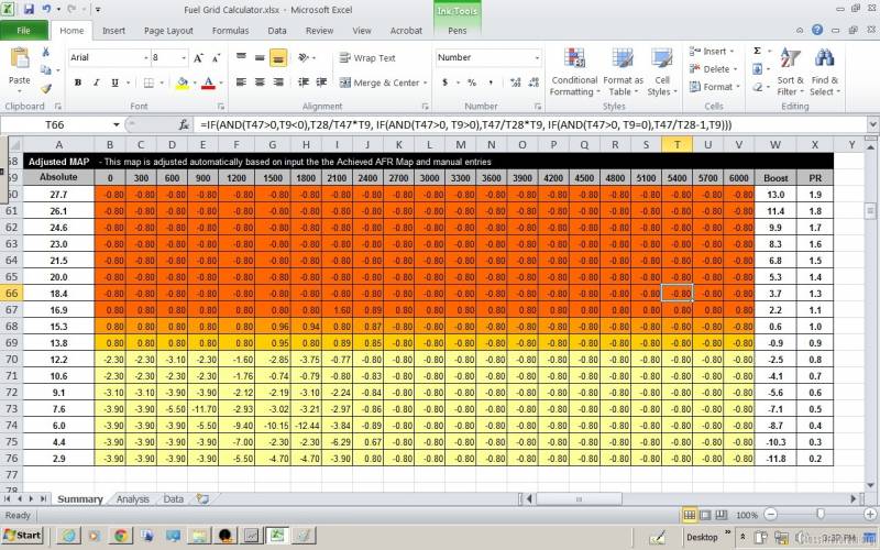

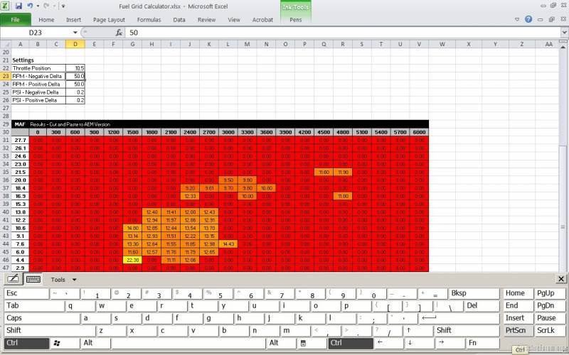

I've had a spreadsheet that I built and used for years that I changed from working with the Toyota FCEdit to the AEM. Basically it is a calculator that accounts for the 21x17 map used by the AEM. It has 4 sections; Base Map, Desired AFR, Achieved AFR, Adjusted Map.
Paste your map, enter the achieved AFR per cell, cut and paste the adjusted map into your AEM tune.

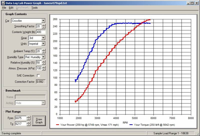

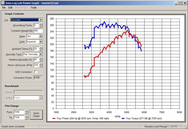

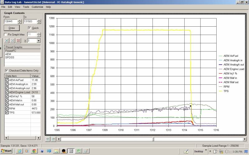

I used to sit for hours mulling through logs in a program called Dataloglabs that provides a great way to manipulate data. I worked through the tune looking for areas with positive throttle input, increasing rpm, etc. I then zeroed in on intersections of RPM and PSI and entered the results in the Achieved AFR section.
So I decided to automate my system. I built a new spreadsheet with Excel 2010 that scans my 225,000+ line logs and dynamically maps the AFR average per cell based on a user definable Throttle Position, RPM window per cell, and PSI window.
So far it has been working great and helping me dial in the fuel in minutes versus hours per tune.

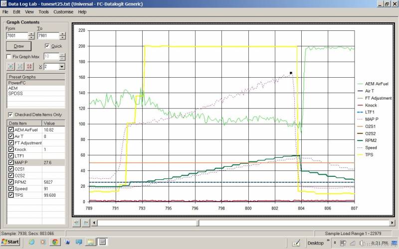

That out of the way, I turned my attention back to the nagging CELs and BAS/ESP errors I was getting with the SRT-6 ECU. Understandable due to the fact that my Rotrex SC doesn't have the exact same boost characteristics of the stock SC and the Mercedes ECU is a living, breathing ***!
It is amazing sometimes how you take a break from something and come back to it and the answer is right there in front of you. I guess I had been working towards the solution one step at a time so it didn't exactly happen over night. Then WHAM the result of hundreds of experiments culminated into an answer. I sat down at my computer, mapped out a plan that I thought would tell me if I was at least on the right track (fully expecting I would have to tweak things further one way or another), implemented and boom.
Six test drives later of 45 minutes or more and NO CELs OR BAS/ESP Lights, no stumbling, no jerking, just smooth sailing (although with lots of extra fuel). Each drive was with progressively deeper and longer pulls, and finally today FIVE WOT pulls in 3rd gear. All confirm that I am finally in the POWER TUNING PHASE and working towards my ultimate number!
My fuel is pretty rich for now but this graphs shows I was making 10 PSI at 4,500 RPM. Right on target to make my desired 12 -13! Next up, more pulls, and tweaking fuel of and spark to find the best combo for power in pursuit of my top end goal of 400+ BHP.

I'm glad to report that the tuning is going very wonderful! In the very limited time I have had, she is dialing in nicely with less than a dozen WOT pulls. I'm making a firm 13psi, no knock, and slowly moving the torque drop off further into the power band with each pass.
I'm at 240 RWHP and 270 RWTQ to date. Well on target for the 300+ RWHP I am looking for on the stock motor. So far so Good! Now if it will ever stop raining. I should see my mark before the weekend is over. Also, no CELs!!!!!!!!!!

Tuning is coming along very well. I'm making a nice, solid, 260 RWHP which is about 340 at the crank (or roughly +80 HP at the rear wheels) at a little over 11 psi. I'm calculating this based on 16% drive-line loss as displayed on the crossfire dynos I've found plus the roughly 30 HP required to drive the Rotrex at this boost.
For the record, that is 340 HP and counting on a stock NA motor and they said it couldn't be done!
If you take a look at my logs, I've managed to smooth out my boost signal and my A/F is shaping up into a thing of beauty. I think there is a little more on the bottom end as I can lean her out from where she is at now, but not much left on top at this boost level.
