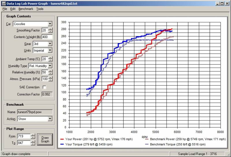

Making Progress!!!!
Very interesting indeed. I took off the air filter to my rotrex and installed a screen before messing with an air box and it made no difference in boost. So, I pulled the rotrex pulley and my dual drive pulley then grinded down the grooves on each to reduce pulley size (and improve traction) and >>>>>>>>>>>
That said, boost went up and now I am approaching 80% on the srt injectors. It looks like it's time to hook the boost signal back to the fuel pump and see if the built in pressure regulator gives me the extra kick I need to bring my afr's back down where I want to be and give me the head room I need for cold weather.
Man she felt sweet! That 3rd gear pull was awesome!

For those that follow, I definitely wanted to confirm that adding a boost signal to the fuel pump offers an increase in fuel pressure just like a RRFPR. I am now making 1 full bar of boost and was approaching 80% fuel injector percentage at 13.1 AFR. I made a slight adjustment to fuel to pull it down to 12.5:1, added a boost signal and am now running a 10:1 at the same 80% utilization. This is more than enough room to lean her back out and account for cold winter air!!!!!!!
