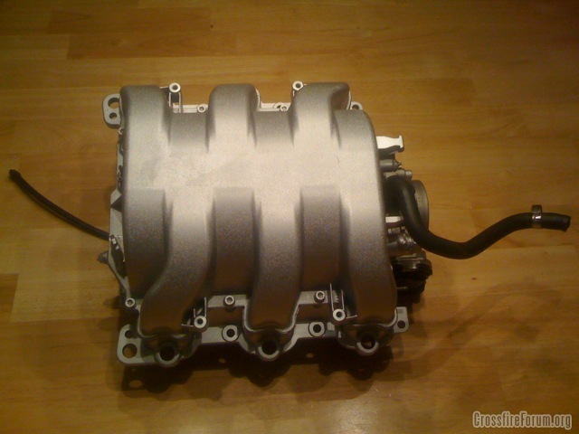

Old Oct 18, 2010 | 05:01 PM
  #344 (permalink)
Web 3.0's Avatar
Posts: 259
From: Houston, TX
Default Re: Project Crossfire - a Rotrex Supercharged Limited!
Pics of Intake Manifold:
I think the aluminum paint looks great! I can't wait until I can pickup one of the mercedes covers from earlier in the thread that leaves the IM exposed!
