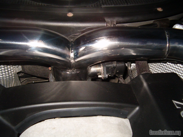

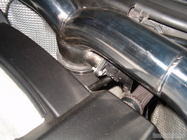

Valk - The MAF sensor is tucked in the lower portion (in the 3" part) out of sight. I will take a pic later tonight of it if you want.
Here are those pics Valk!

Looks awesome !! Thanks for developing one for the NA guys !! Can the rubber hoses be gotten in different colors ? Any idea on a final cost yet ? Hopefully less than a Needswings ? Or just sell the pipes and we do the rest, as far as, getting filters and hose at Autozone or someplace. Might be quick and easy for you that way.

Yes the hose comes in a different color. I chose the color I have because it matches my interior but I will probably get black someday. Since I live in Canada, the cost for me to buy and ship filters compared to anyone in the US going to the local auto store and buying them is a huge difference. So it would not be a good choice for me to supply filters but for everything else I should be able to include in a package (pipe, elbows, clamps, 2 bolts for the maf sensor, brackets, the part number for the filter). The main concern I have would be the install. It is a little more complicated than just moveing 1 horn and moveing one end of the cooling line towards the rad a little to allow room for 1 filter. It is going to take me a little while to get the relocateing brackets and the best possiable procedure for install all sorted out.

excellent craftsmanship!
how about IATs? they are already high enough with these cars and all that metal would only increase temps negating any airflow gains...

I know that stainless will be a bit hotter than aluminum but no matter what material you make it out of it will get hot on our cars. I tried to keep the intake as far away from the motor as possiable just for that reason. If I was to put a coating on (paint or something), it would retain heat even more thats why I just polished it. I will get around to see just how hot it does get but I am not in a rush to do that right now, but some day!
