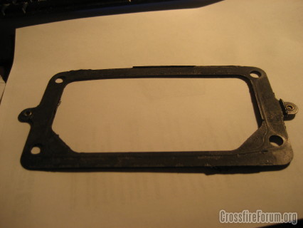

Old Dec 2, 2012 | 11:29 PM
BrianBrave's Avatar
<--- Huge Horsepower
Posts: 3,217
From: So Cal
Default Re: Intercooler replacement tips, anyone?
Notice the RTV on the edges of the gasket...
