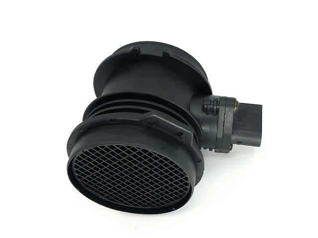

We are talking about this sensor, right ?

Just ordered one of these "2001-2004 Mercedes SLK320 Mass Air Flow Sensor O-Ring 35659FH 2002 2003". Should be here on Wed.(found on e-Bay, not on Amazon). Also ordered one of these "Seal Ring - Air Intake Housing to Engine Fits: Mercedes C240 CLK500 S500 SLK320". Not sure if goes on elbow or MAF intake but might as well...
ala: yes the MAF sensor. Wonder why is not in the parts book.
