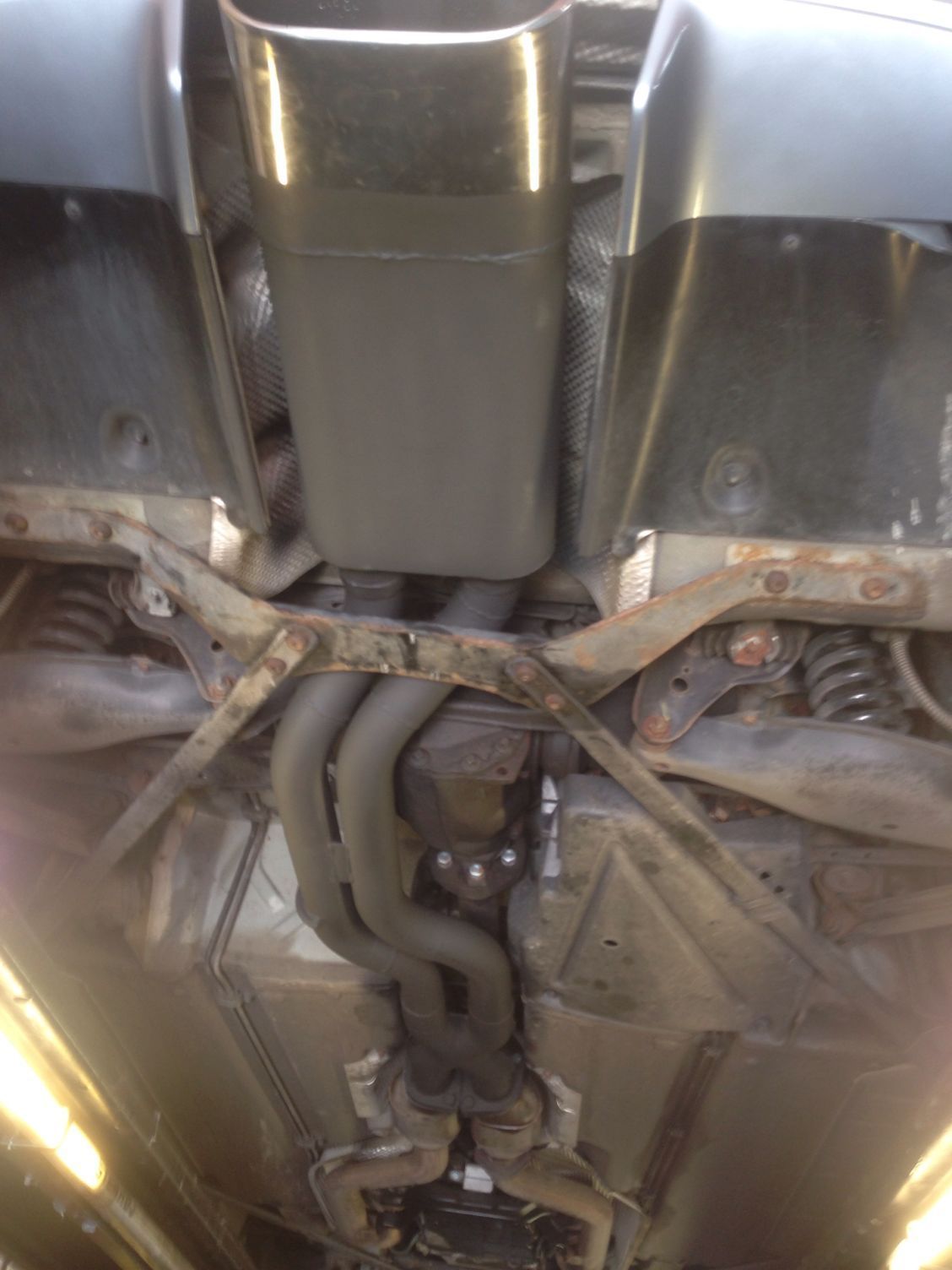

I went with with a true dual set up. So X Pipe from the secondary CATS with 3 inch pipes all the way to the exhaust for which I used Flowmaster Super 44. I also use a sprint booster which enhances throttle response and makes the exhaust note even sweeter.

Default Re: Exhaust Opinions
Informative pics ,thank you !
how does it sound ?
how does it sound ?
Awesome, will try recording a sound or video clip over the weekend and try posting it here.
