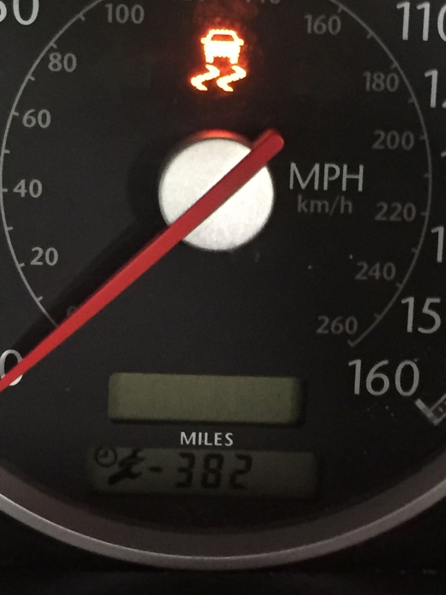

Something weird going on, first day throws PO376 when key turned to on, next day PO377. Yet today PO382? Tried 2 different scan tools and same results "no DTC codes stored. Help!

I have to ask, where are you reading these codes from?

Clock/wrench -382

That is just telling you that a double wrench service is past due by that number of miles.
