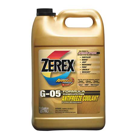

Refill with 50/50 distilled water and full strength Zerex G05
