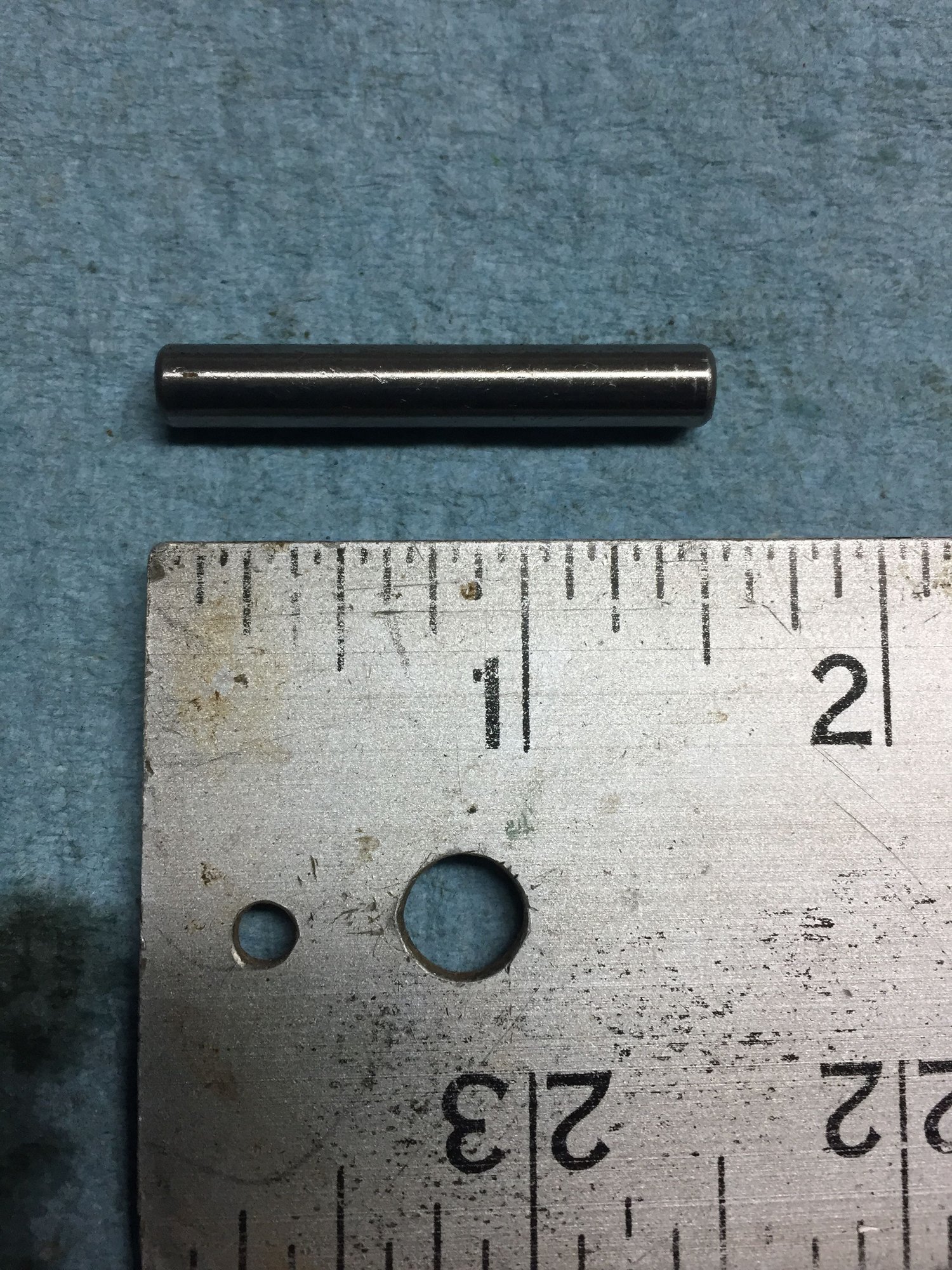

I am currently performing a conductor replacement however when I dropped the pan, this 1.5 inch pin was lying in the bottom. It looks like I could be an alignment pin but I cannot find where it came from. Need some expertise! Thank you much in advance.

Do you have a picture of the part?

This is what I found in the trans pan.

I just posted a picture of it

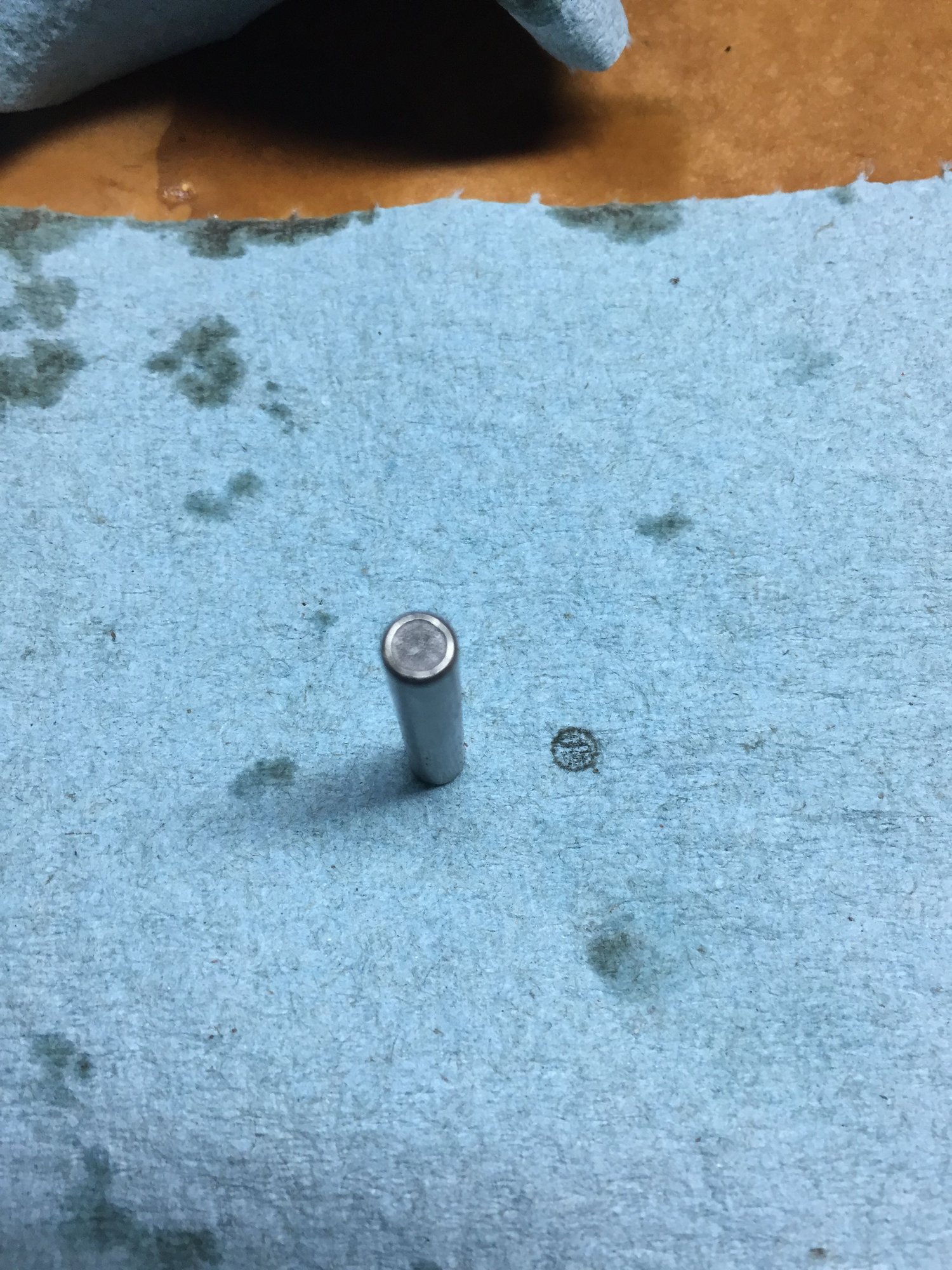

It looks like the rod just to the right of the "750"

Default Re: 722.6 Unfamiliar Part

Originally Posted by rednrollin
What do u think 451 is?
Look up part 451 in the parts manual.
He means the part between 451 and 750.

No I actually mean 451. Your were correct! That is where it goes! I thank you Bigtime!!!
