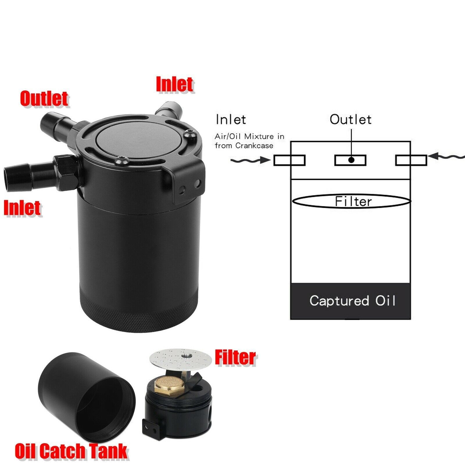

I'm going to test the cheap eBay 3-port oil catch can. Does it work for Xfire? Did anyone try it?

I bought a similar one from ebay with a dipstick to check oil level, I've had it on the car for awhile it seems to be working fine. The only trouble i had was mounting it. I used one of the studs for the heat shield for mounting, it's not the best but feels secure.

I've been reading posts about this catch can myself and am interested in your findings as to how well it works. This is not a precision performance part. Its just a reservoir can that holds gunk!
Look, I'm not trying to choose sides but...….if buying the best was the only option this would be a Lamborghini forum not a Chrysler Crossfire forum. I have and continue to spend money with vendors who bend over backwards to help us Crossfire owners. I trust them to sell us quality parts. However I think there are some things that can be done on a tighter budget. The car was engineered to "burn up" the extra gunk anyway. My car has 75000 miles on it running without one so why should I even consider one now......because all the cool kids have one that's why. I know people use them and yes they do trap junk so one can say yes I need one. If it doesn't work then I'm sure he will let us know.

It will work. maxcichon re-engineered a cheap one from ebay by adding some more steel wool and it worked fine on his car.

Mods I'm going to perform.
1. Take it apart and see the internals. If it's not baffled I'll fabricate baffles from aluminum or stainless steel and I'll add some copper or stainless steel scrubber.
2. I'll install oil drain ball valve.
3. I'll replace barbed hose connectors to AN fitting. AN10 or AN12 will be fine.
4. The Y shape 3-way connector will be used for inlet hoses that's why I bought 2-port oil can catch.
5. I'll use 3/8" fuel hose SAE 30R7 Hi-temp resistance.

I helped fab the oil catch can for ROB and the one shown seems to have minimal screen to catch vaporized oil well. I am also concerned that the sintered filter on the unit would become very restrictive. Original plan was to minimize the oil let thru and keep runners and intakes cleaner. With fuel injection the runners never get WASHED, as a carb;ed engine would. Restriction is your enemy thus the dual intake and crossover manifolds I developed a while back. Enjoy the new year, Woody

So which catch can are you trying to use? You have shown two different units and the drawing looks different even yet.
