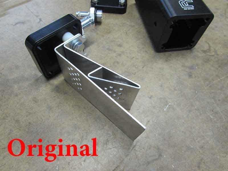

RacerX baffle design vs eBay copy. Almost the same.

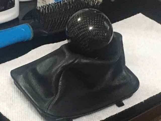

BTW I don't like the manual shifter **** so I decided to replace it. I have two variations.
First, I bought a used stock shifter **** and boot set for pretty cheap on eBay, Removed chrome and painted with Dupli-Color gun metal acrylic enamel 2 in 1 (paint +primer). Very good paint for plastic and resin.
And second type - original stock leather boot , M12x1.25 adapter and real carbon fiber ball shaped ****. Looks fantastic.

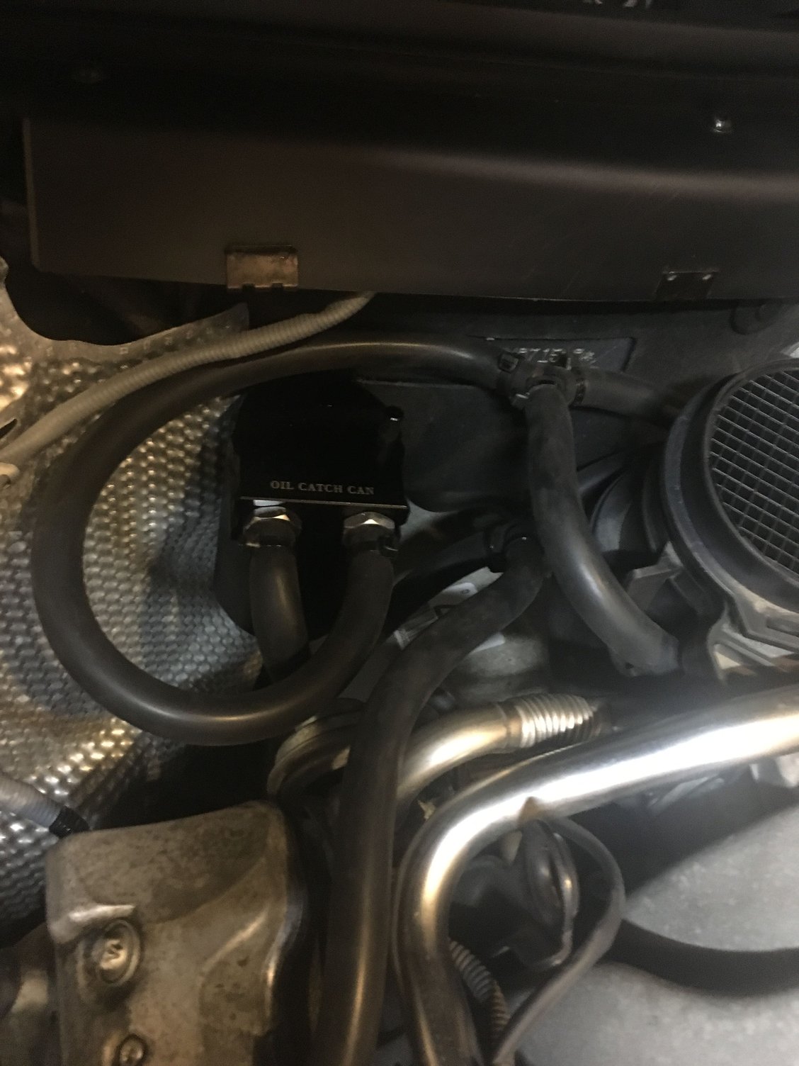

Finally the project "Oil Catch Can" has been done. Took about 2 hours to complete.
Parts:
1.Oil catch can
2.Aluminum flat bar 1/8" x 1" from Home Depot.
3. About 8' 3/8" ID hose.
4. Stainless steel screw and 2 nuts.
5. Panel hole 3/8" rubber grommet.
6. "Y" shape fitting.
7. my bare hands

Oil catch can mounted just behind right engine bank keeping it close to vacuum source

Nice. Good idea. But it's too small and you need to drain catch can more often. Also you probably have to take off an engine cover.
In my case I just need to put small container under the catch can and turn the ball valve to drain .

There is room to unscrew the cup from the top without taking off the engine cover . I took the picture with the engine cover off for a better view. Whatever anyone comes up with that works and enjoys doing the modification and the satisfaction of doing it. That's what counts
