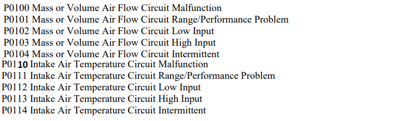

With not codes other than MAF/MAS, my question is this: WHAT code?
"All it showed was a MAS issue" is not complete information.
What code did you get, and was it MAF or IAT? (I ask, since the MAF assembly has both sensors in it.) This can tell us a LOT, for example, a "malfunction"code often means a connector is corroded or bad, or, if it shows all the time, you may have the wrong part in there.
