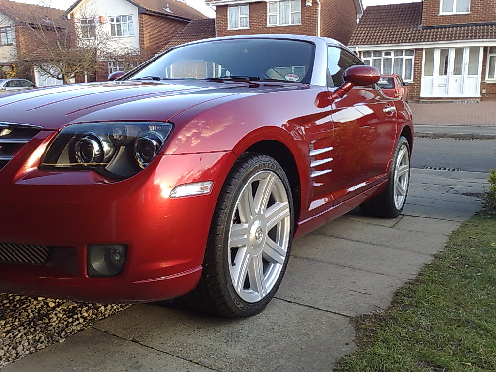

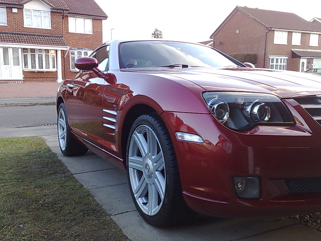

Hi Baz , i went for Dunlops in the end ,Grip is good & not much road noise , But i have the 275 on rear & standard on front . i think the 275's fill the rim better than the standard 255 's , If you look at your wheels & tyres at the moment (if your using the standard sizes ) you will see the front tyre fills the rim , but the rear tyre looks a little on the slim side. going up to the next size at the back , just gives a more balanced look . Using the 275's at the back will also help you from damaging the rims . If you are worried about the tyres rubbing i have not had any problems .

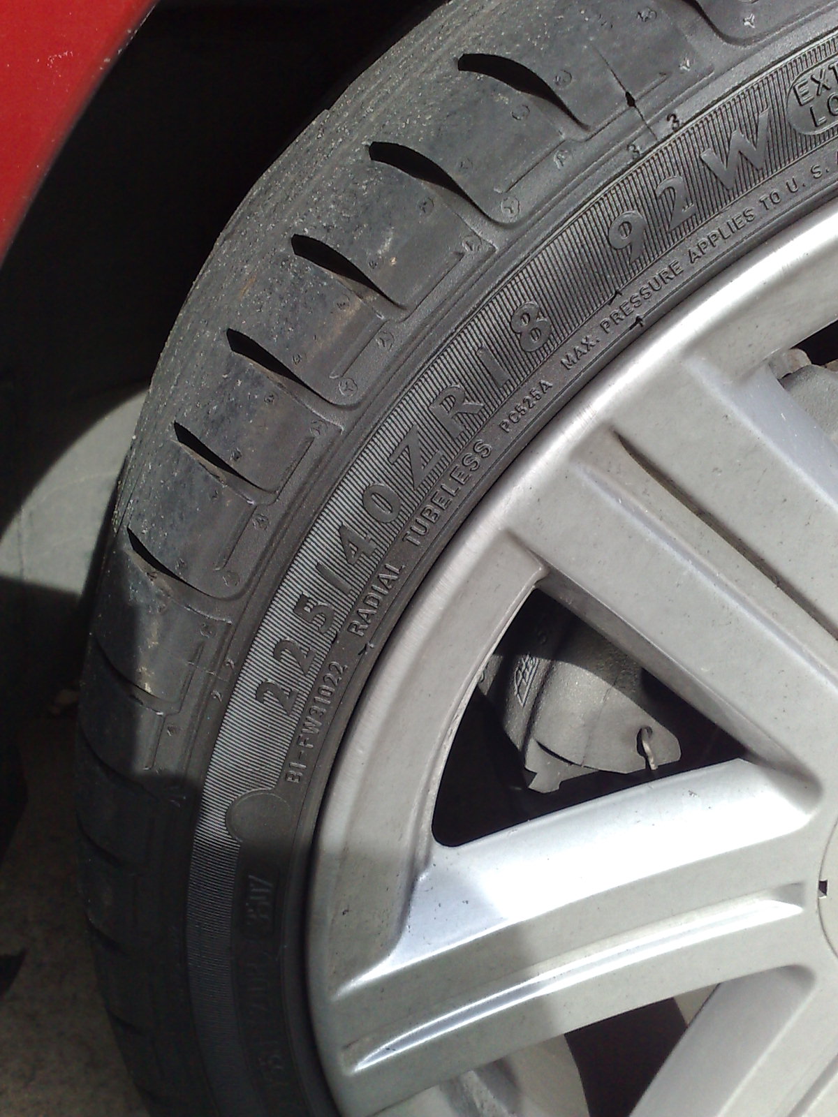

Hi All , I think you should check the size of that rear tire , it should 255 not 225 as that will not fit the rim , As i have wrote before go for the next size up (275) on the rear as it fis the rim better . i just hope that was a typo' SteveB1.

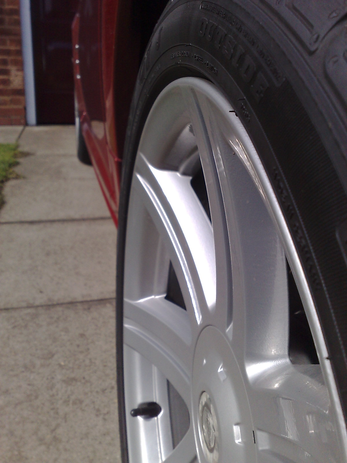

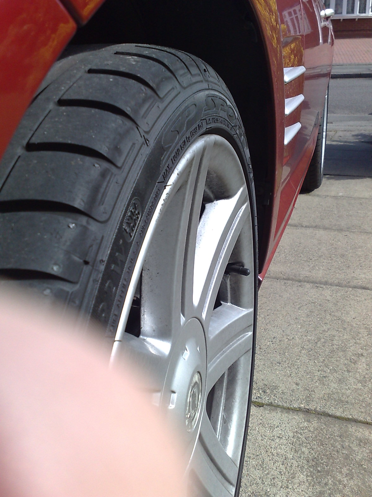

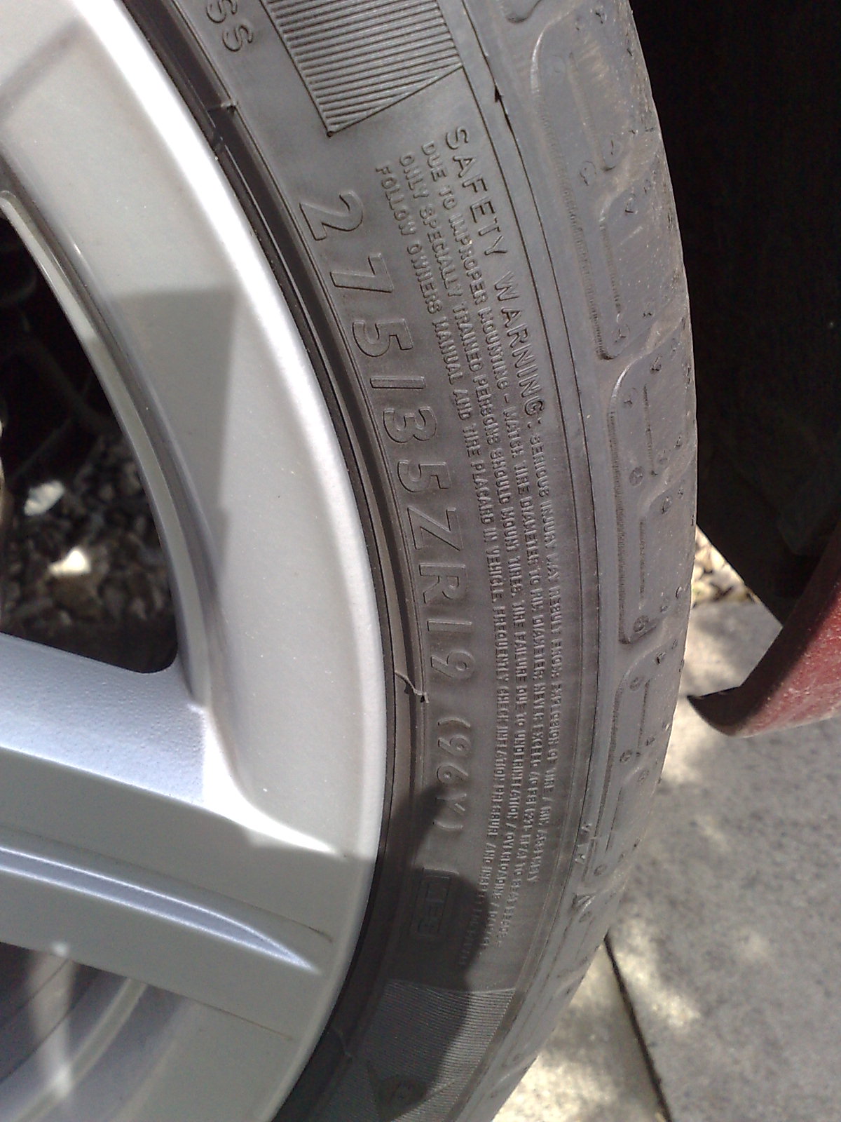

Hi there, re 275's on the back; do you have any pics of these showing how they look on the rims in comparison to the standard 255's? Im considering putting this size on, but it would usefull to get an impression first.
Thanks, Steve
Re: Help please on tyre choice ???
Hi,Many thanks for the pics, I can see now how the 275's seem to suit the rims so well, and the standard tyres look undersize in comparison. Fitting wider tyres can cause problems but I believe we can be confident with this application. I also note that there seems to be a bigger selection of tyres available in the larger size, also there are some 265's around as well. The way I am going, it looks like I'll be needing new rears durring the summer so its going to be 275's for me! The pics are great, I allways wanted a red Crossfire but coulnt find one when I was buying, so it kills me to see a nice one like yours (fancey a swap?)
Cheers, Steve
Cheers, Steve
Hi Steve Uk glad i can help , The only problem i had was getting the two tire sizes from same tire company ,but that could have been the shop i was using . It took me weeks of looking up tire sizes & checking this forum to make the switch to 275's , but they look so at home & match the front rim/tire set up , The two pics of the side of our xfire were taken the day before the last xfire meeting , I had washed twice & clay barred & polished , nice very clean wheels ,clean exhaust tips , then i get up in the morning & snow every where so stayed at home with a very clean car in the garage ( bummer) .
Cheers
Andy
Cheers
Andy

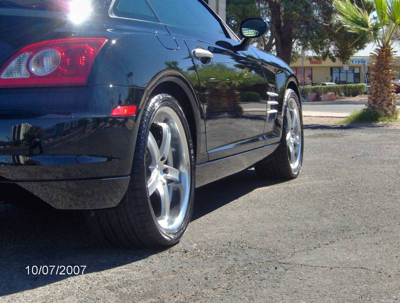

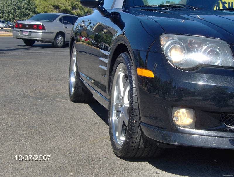

I've had no problem with my Yokohama Advans... 245/35R18s front and 295/30R19s rear... REALLY fills out my aftermarket rims.
Here are some pictures to give you an idea...
If you still have the stock rims I don't think you could get these mounted. BUT, if you are looking to change your rims too... now is a good time...
Cheers!
Cheers!

Steve - UK,
Thanks for the compliment! I too love the look and feel of this setup. I have a much harder time breaking the rears loose from a dead stop now. And when I do, they hook up quick.
As to any rubbing... The fronts only suffer very light rubbing at full suspension articulation (up) in the front. They rub every so slightly on a fender bolt that's at the top of the inner lip. Can't change it short of removing the bolt and trimming the inner fender area.
The rubbing is so slight and only at full articulation in the up direction that I've left it alone. Doesn't damage the car or the tires from what I can tell.
In the rear, I DID have to add a 4mm spacer to offset the rubbing at the upper, front, inside wheel well wall area as almost any upward articulation of the rear suspension was rubbing there. I let it go long enough to rub away the undercoating. Since the addition of the 4mm spacer (not in the pictures above), I have had no rubbing at all in the rear.
Now I just have to shoot some new undercoating on that area...
Cheers!
