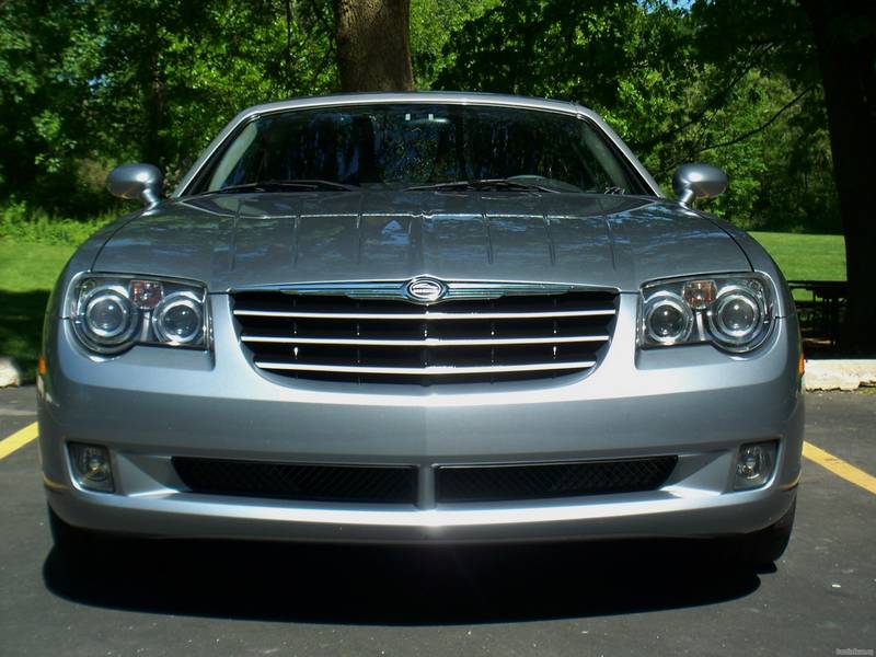

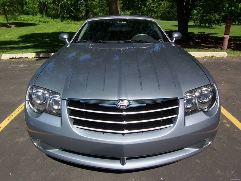

New posting of my Crossfire and how-to info on the black Grill.
PAINTING GRILL BLACK
I did some research on the paint. It had to be durable so I used
"Dupli- Color" Truck, Van & Suv Acylic Lacquer black & clear coat.
(1 ) 11oz. can of each at $5.00 per can.
1. Remove the top grill screws and remove grill.
2. Wash & remove all wax and grease.
3. Sand surface with 3M "Wetordry" "Tri-M-Ite" No. 400 grit to dull finish.
4. Remove all dust & if you can, blow with air.
5. Mask off top inside mounting flang on the grill.
BLACK BASE COAT
6. Apply 3 light coats allowing 10 minutes between coats.
7. Allow last coat to dry 1 hour.
CLEAR TOP COAT
8. Apply 2 light coats followed by one wet coat 10 minutes between coats.
9. Allow clear top coat to dry for 1 hour.
10. Reinstall grill.
