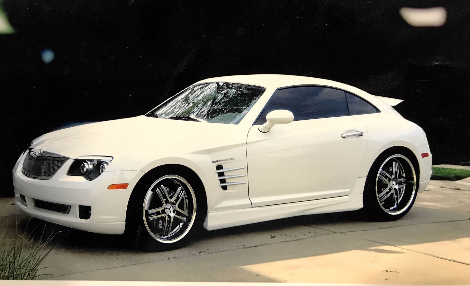

Does anyone know how much work and/or cost is involved in removing the existing Crosfire rocker panels and replacing them with the aftermarket AMG styled rocker panels?
Old Apr 25, 2017 | 06:53 PM
Glockhit's Avatar
Posts: 389
Default Re: Rocker Panel Removal and Detail.
The AMG style rocker panel was a lot of work. The fit was off and I ended up doing a hell of a lot of cutting, fitting and fiberglass work. At the time I was determined to get it done because of how few of these panels were available. And I did finish it to perfection (took my time) after figuring out how to remove the original OEM panel. No body shop near me would touch it. I don't have any idea if the AMG panel that fits is available now. Is it?
I have since sold this crossfire and regretted it ever since. Although I ended up with a 2002 M5 I would still rather have my crossfire. I put quite a lot of engine performance upgrades, lowered the car, custom exterior parts and on and on. It really tore *** with the engine mods and computer mods.I really miss it. I will say it was a very firm ride with the it lowered. hard on the prostate.
Anyway it can be done for the cost of the panel and fiberglass, bondo and your labor. Then that cost to me was a total of $225.00. Good luck, sorry I can't help you more.

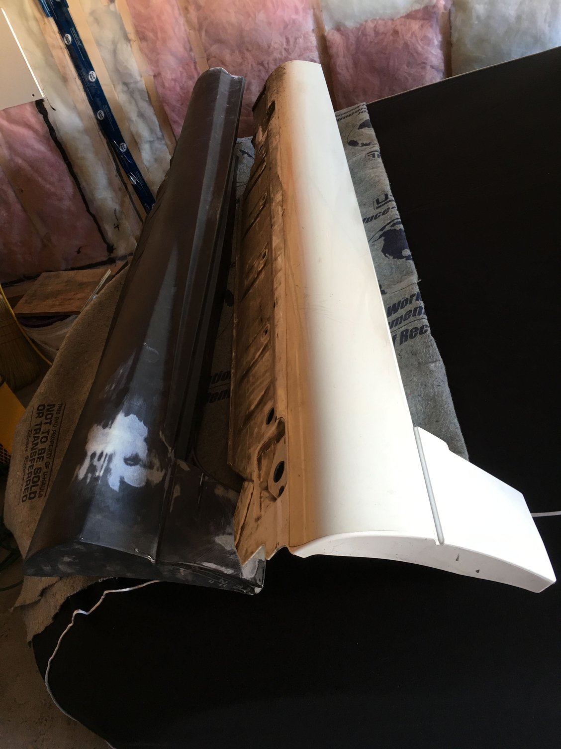

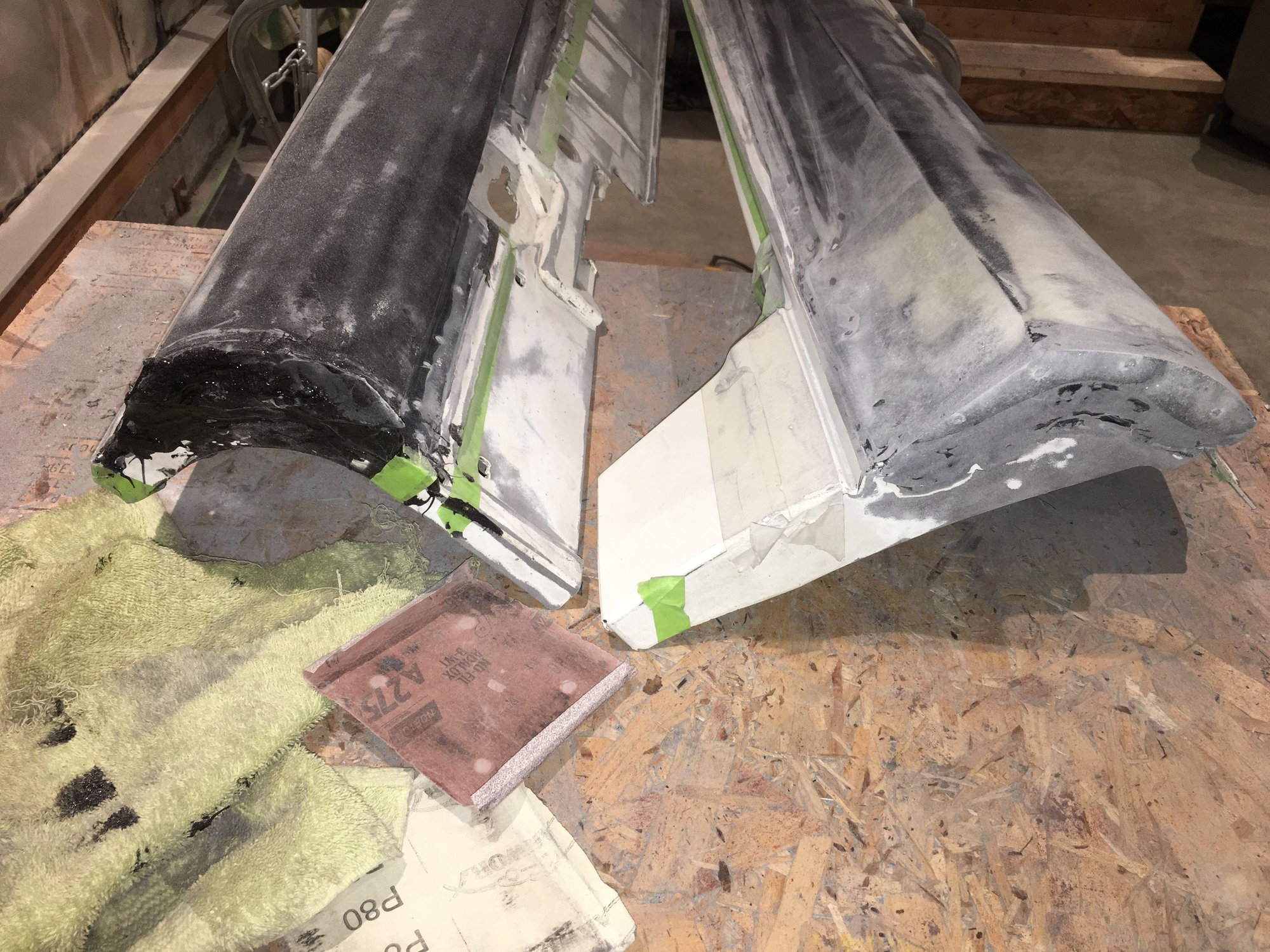

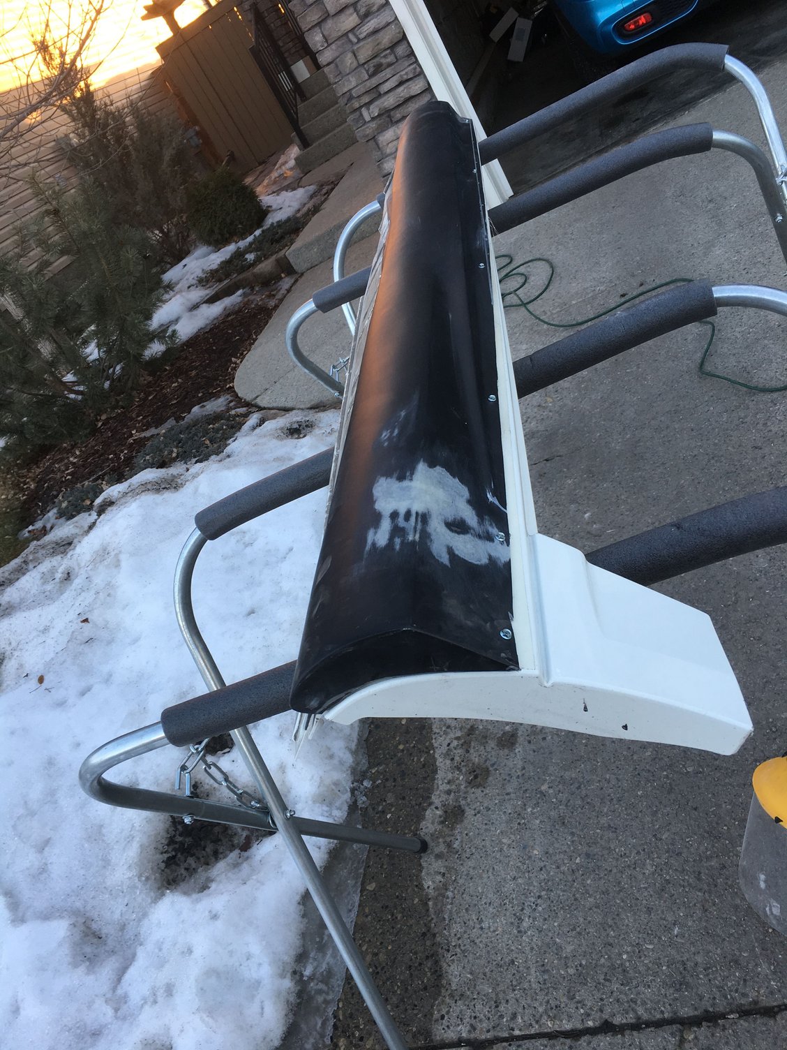

I’ve discovered the quality
Poor!
easiest way, at least to me is cut and glue
I trimmed away alot of material. Just kept the shape with enough surface to adhere to
so far, so good

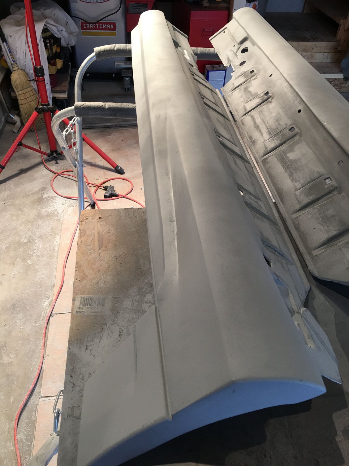

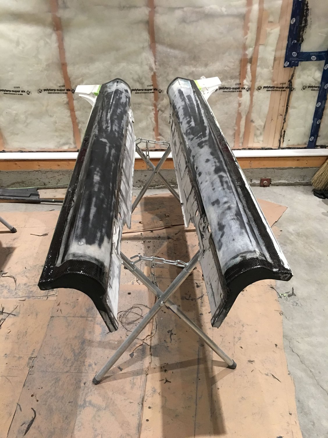

Applied Speed Grip
added material where required
removed fasteners and started sanding/shaping
fill next
then fibre

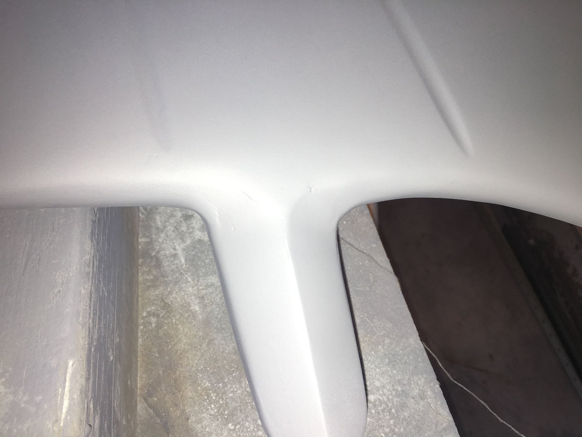

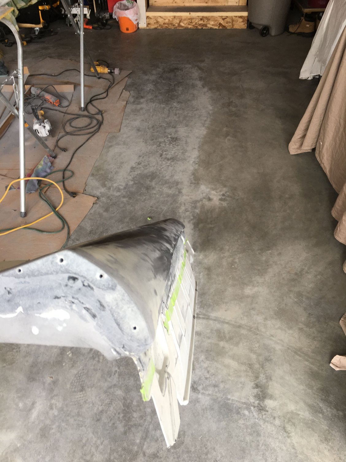

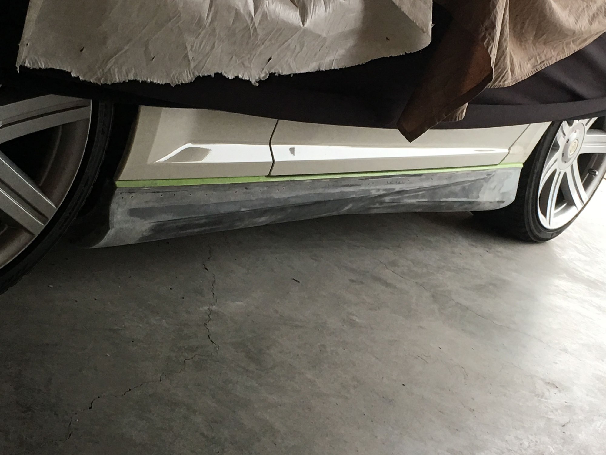

Commenced with shaping

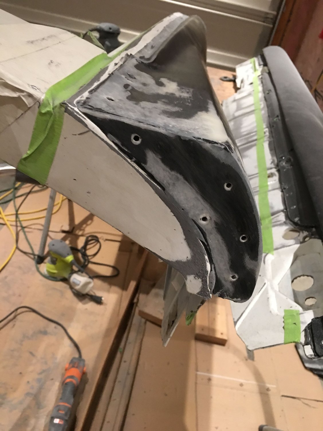

Fabrication complete
test fit today
if you want to install a set of these, a lot of messing around Will be required

Second coat of resin

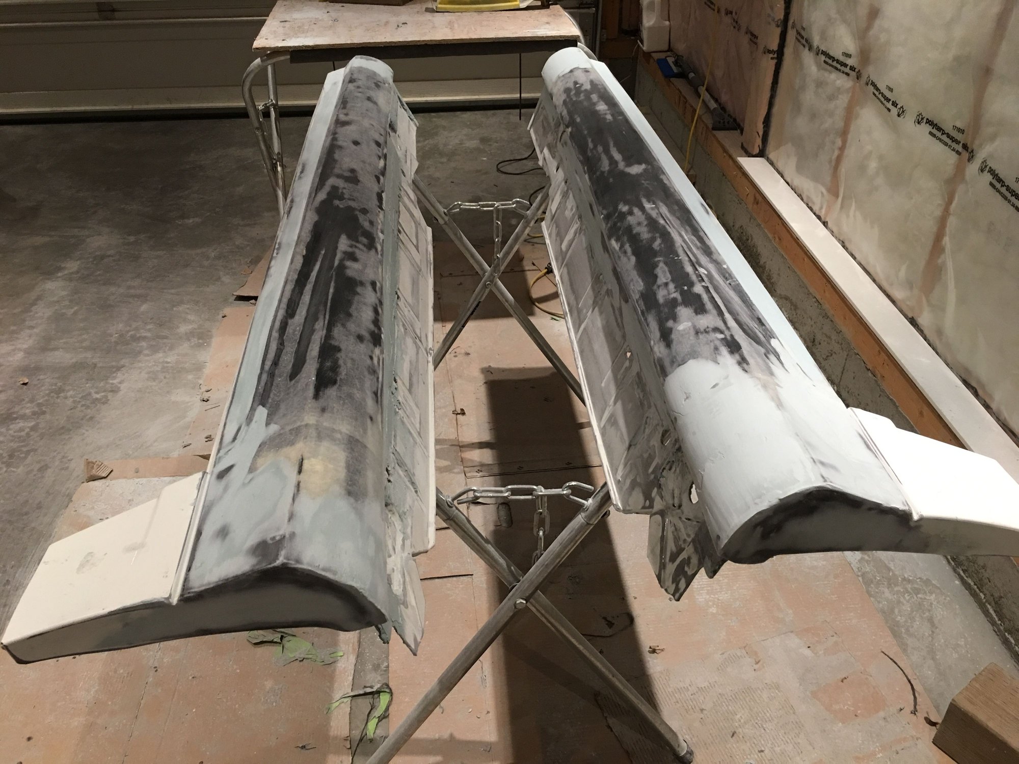

2 passes of fill

Fill primer today

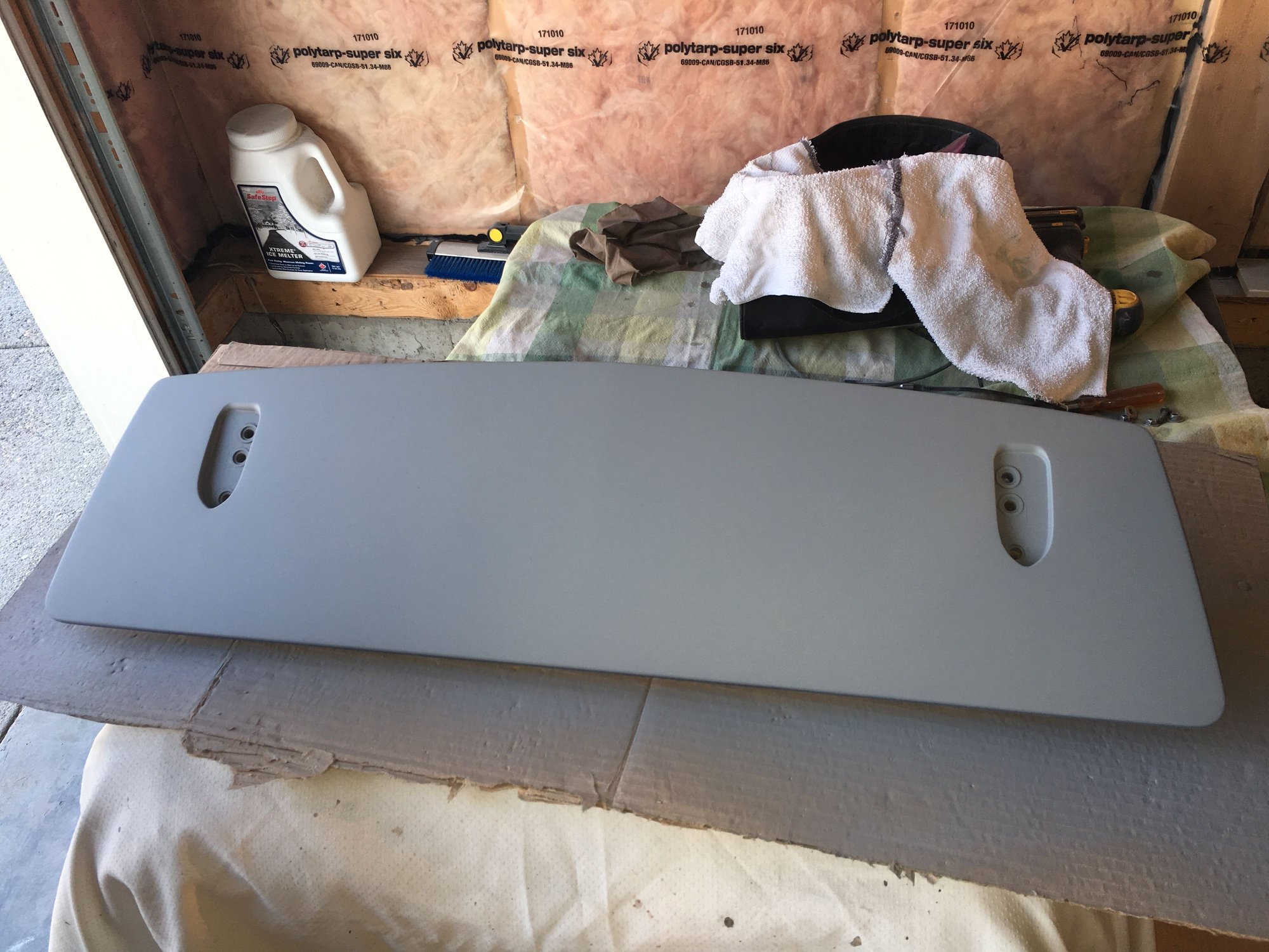

Primed today
sand and prime again tomorrow
paint on Friday
Wing too

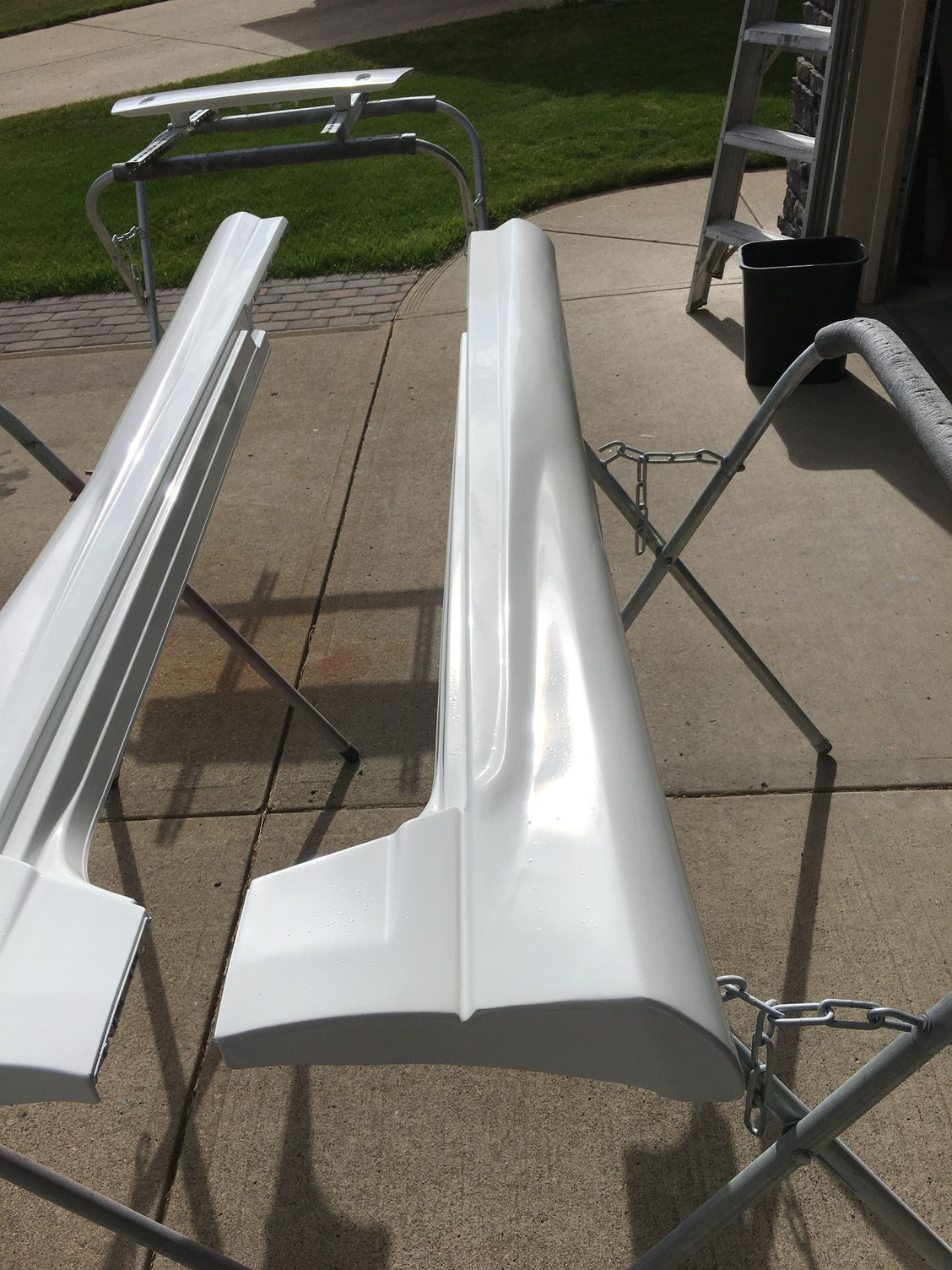

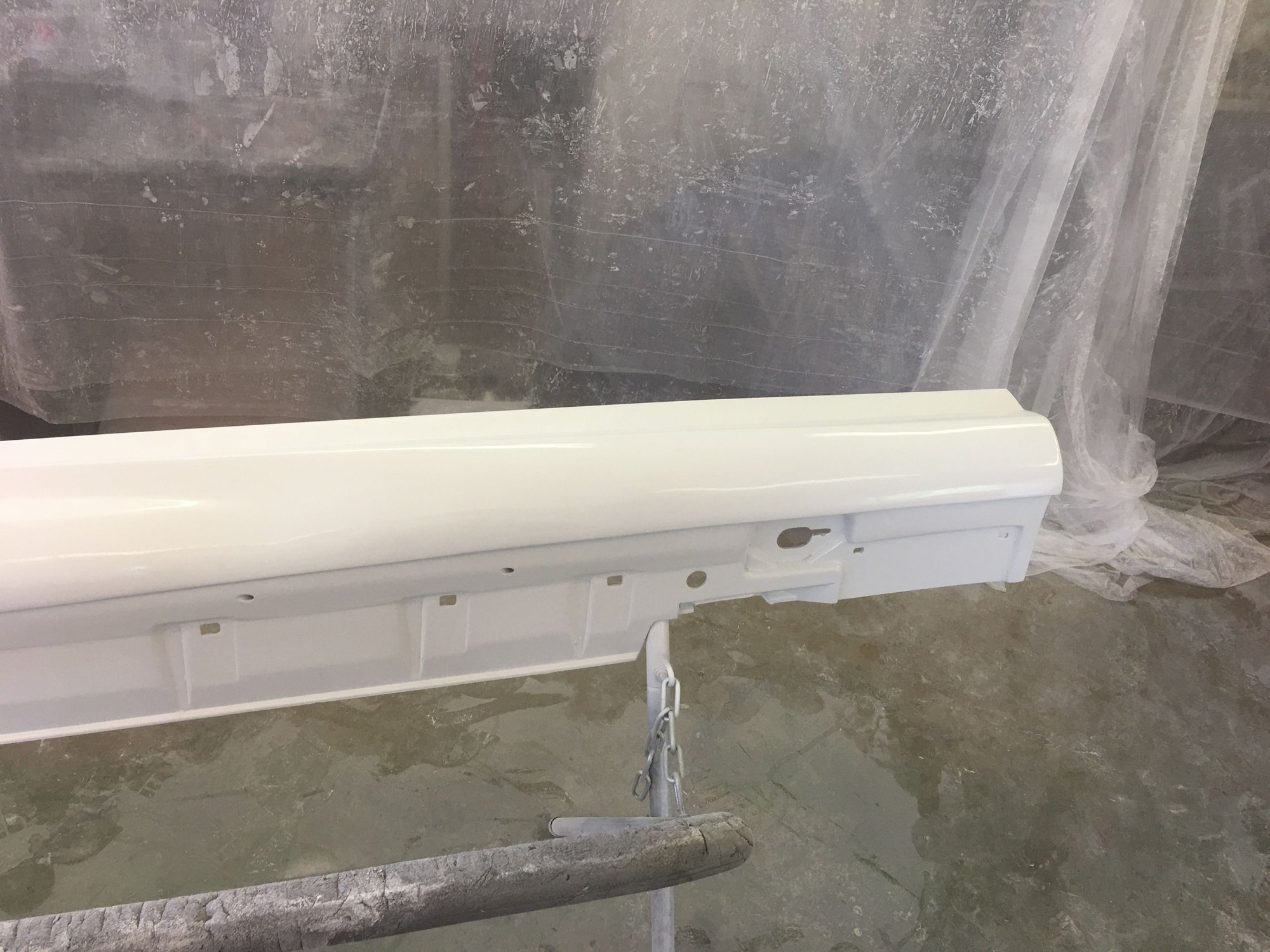

Rocker panels painted
3 coats paints
3 coats clear
painted in the garage. Wet sand and buff today
(fixed wing completed too. More on the wing in a separate thread)

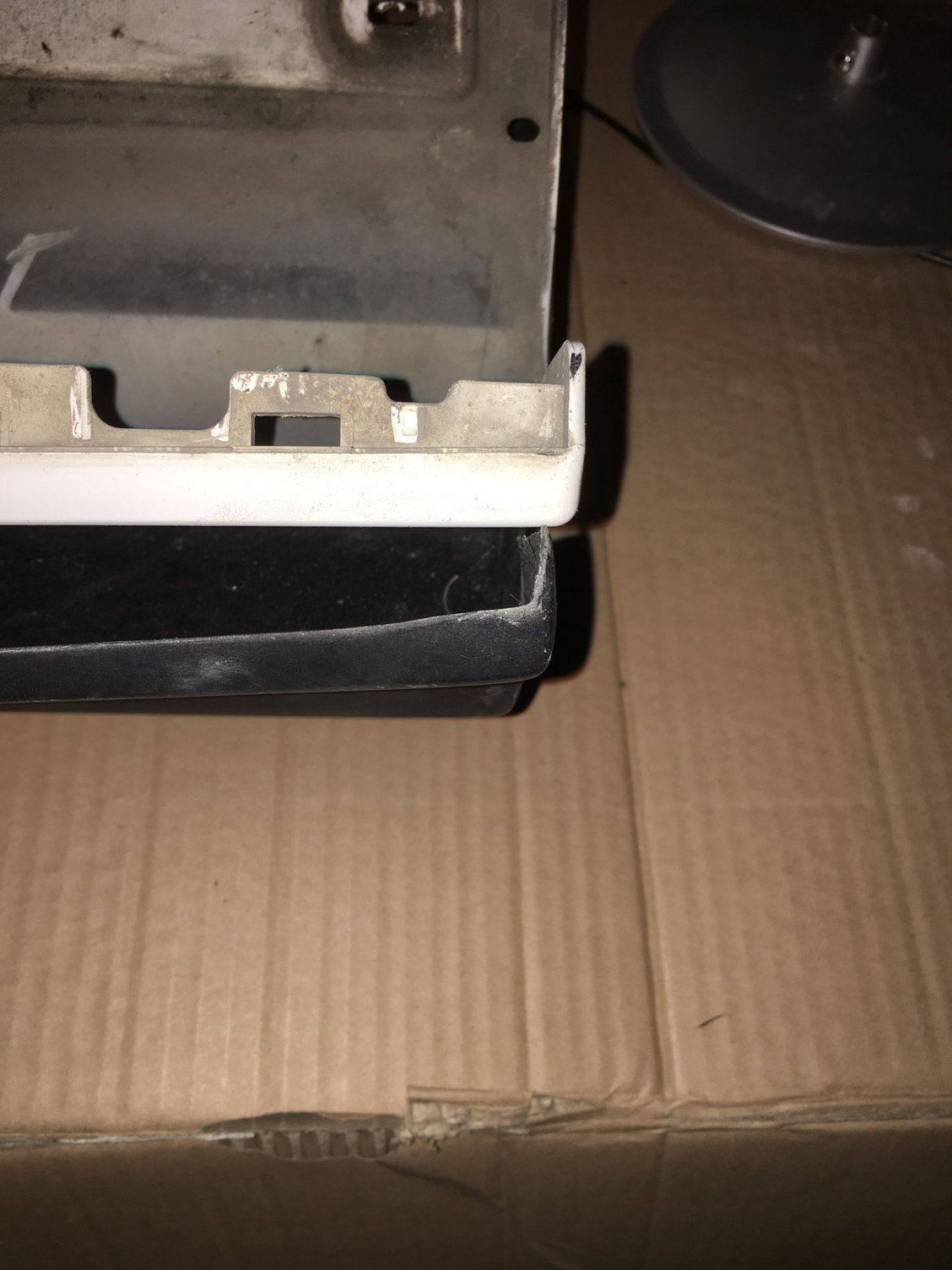

In an earlier post #16, you had indicated that the white sill clips should be installed on the rocker and not in the sill for installation. Could you or anyone else on the forum please confirm.
It it appears to be almost impossible to install the rockers with the sill clip on the rockers.
