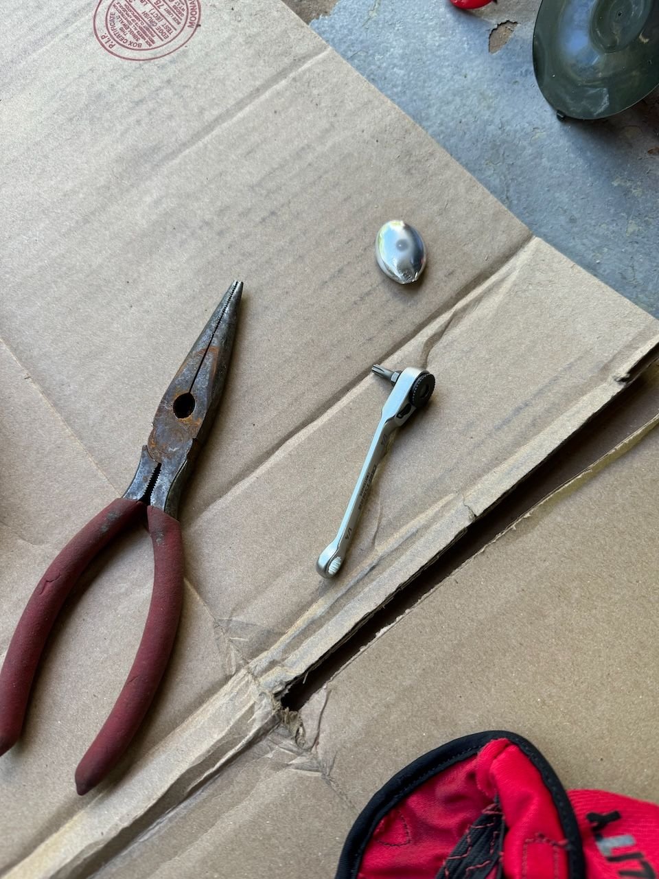

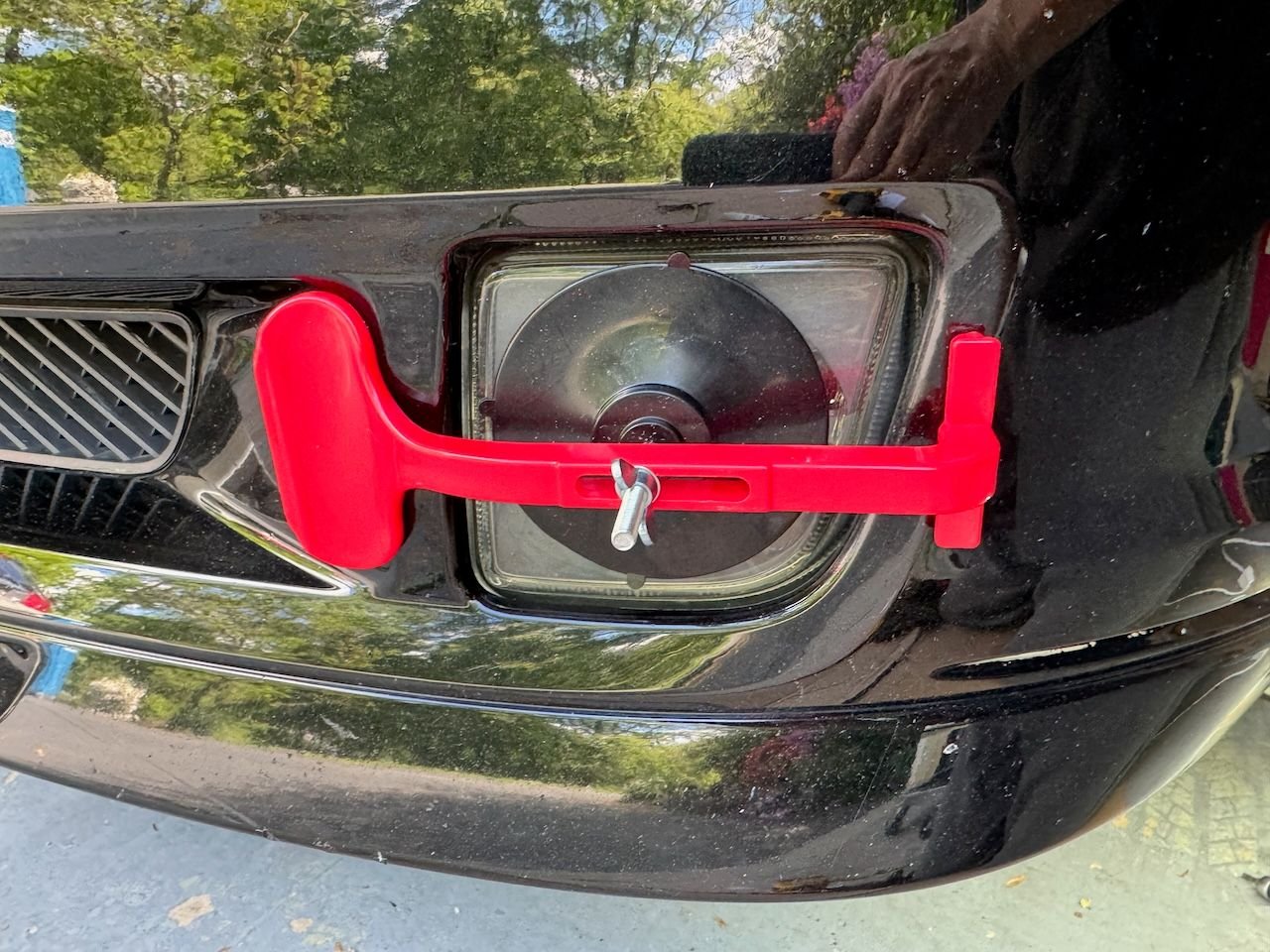

I know this is an old post, but I just did this today. I didn't remove the back, I just used a needle nose pliers and was able to grab the cap and bend it enough to pull it through the bulb hole. Also found a new use for those clamp thingies that we used to fix the back window years ago.
