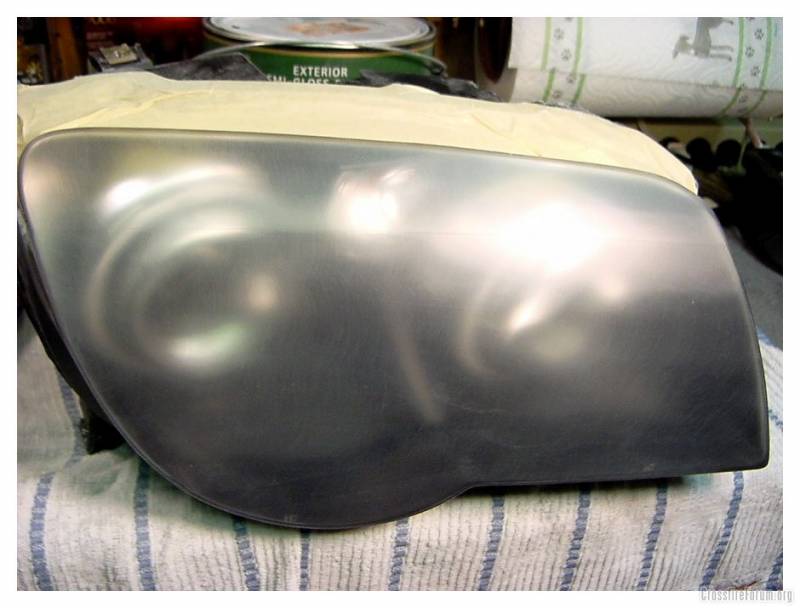

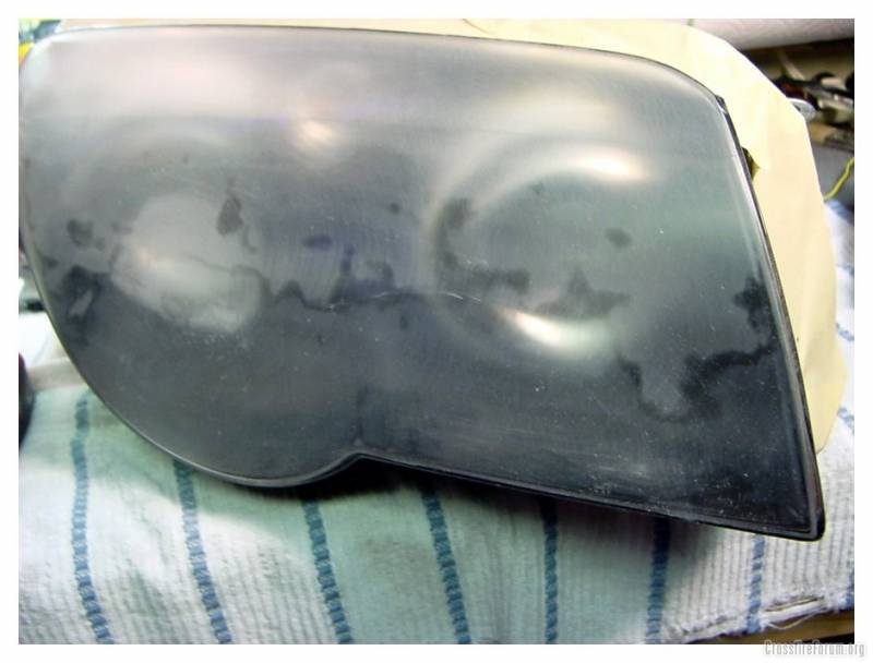

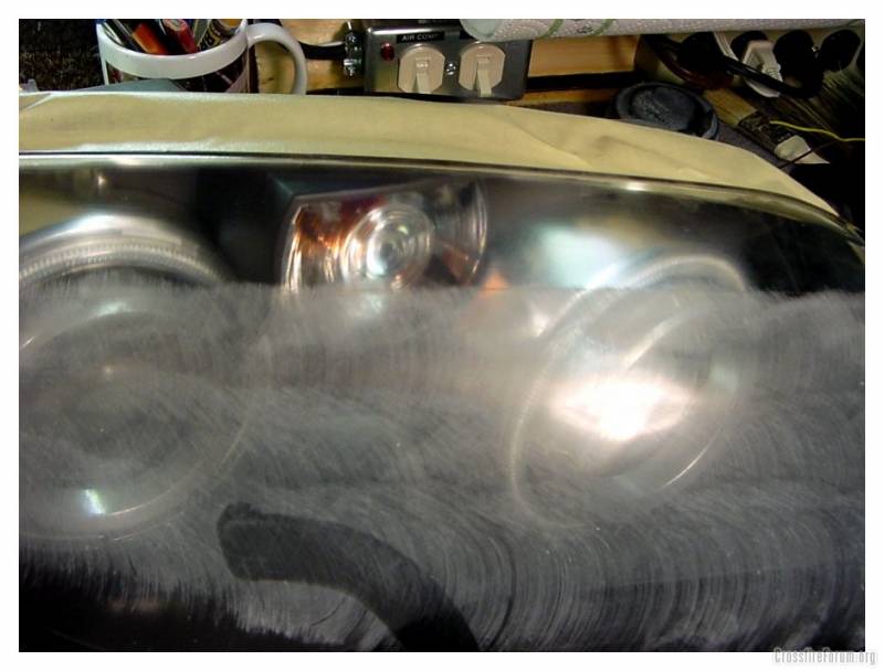

Thanks guys for your advice. I returned the Turtle Wax Product and ended up with the 3M. These worn out spare headlights will look better than the ones in my car! And the ones in my car look fine. I did one tonight. Working on the assy on the bench was a pain, but no leaning over. I am absolutley satisfied with the results of the 3M kit. I plan to get the Plastx and buff a couple coats on them once installed on the car. Thanks again guys!
First Step ^
At this point, I realized it would take more than the first grit pad to get the job finished. So I hand sanded the rest of the lens with a Scotch Brite Pad. Worked very effective, then finished off the first step with appropriate pad.
Sand until the entire surface is the same color/finish.
The lens is nearly invisible. The lights are white, but the camera shows them as blue .

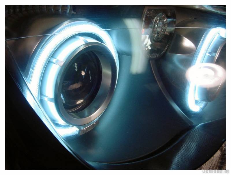

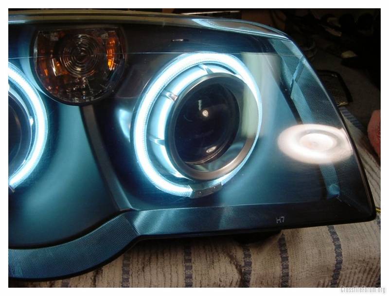

The halos can be bought from several vendors on eBay and the Internet. If I recall correctly, do a search for "3B Specialties" or something similar. They have a large selection of colors and sizes. I used 120mm for the main assemblies. A smaller size can be used if you use the outer ring. I used 71mm for the Fogs.
I went with bright white because they were in stock. I wanted orange like amber bulbs, but they were on a 4 week back order, and I just couldn't wait.
Oracle also sells them but at a much higher price and they look exactly same.
Any questions, give me a shout. James

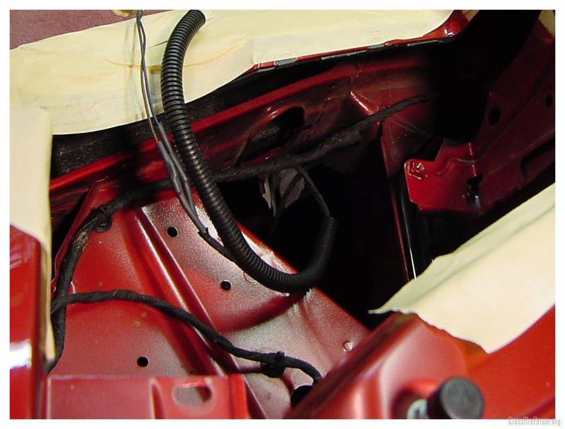

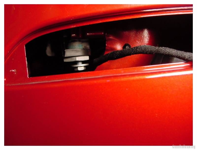

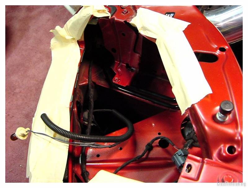

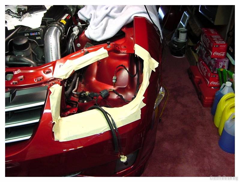

Thanks Evan. As noted, I restored my headlights out of the car. Personally I think it is a PIA on the bench. Once I had my headlights back in the car, I rebuffed them several times and I think it was much easier. They are secured and won't move on you as they do on the bench. Just tape up the paint really well.
Removing the headlights are a pain the first time. It is much easier if you remove the grille, and the one bolt on each side of it that holds the upper front bumper to the core support. That way, you can gently pull out on the bumper cover to give you plenty clearance for the headlights to tilt back and swivel out of their opening. Even doing this, I would tape off any painted areas with 2 layers of masking tape for added protection.
Also with the grille out, you can remove the bottom inboard bolts really easy. The outboard bottom bolt can be seen through the side marker hole, but accessed through the fog light door in the wheel housing.
James
