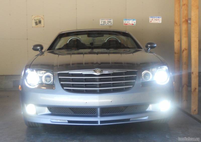

Wanted to share some of my recent mods! Probably not breaking a lot of new ground with most of these but for those on the fence, hopefully this will help you decide....

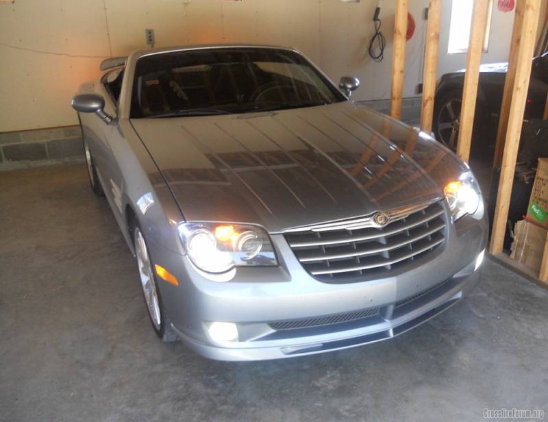

For starters, went with 35W 5000K HIDs for the headlights (H7) and the foglights (9006)...
Ordered from here: www.theretrofitsource.com

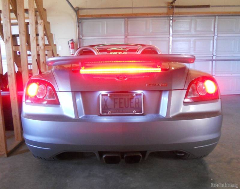

Blinkers are from the same place.... No Resistor Required Error Free 1156 LED Turn Signal Light Bulbs
License Plate LEDs are also from there... 36mm Festoon LED Click Here

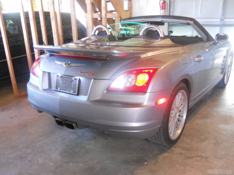

For the Tail Light Bulbs I went over to www.superbrightleds.com and went with the 45 High Power LED 1157 Tower Bulb
I couldn't get a good representation of the color, but it is VERY Red and a perfect match for the factory 3rd brake light.

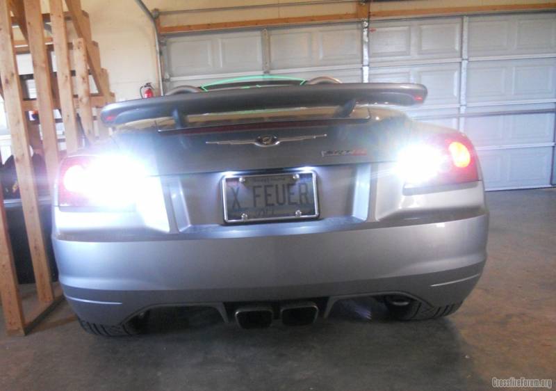

Went back over to JDMTOY for the Reverse Lights... Extreme Bright High Power 1156 Click Here

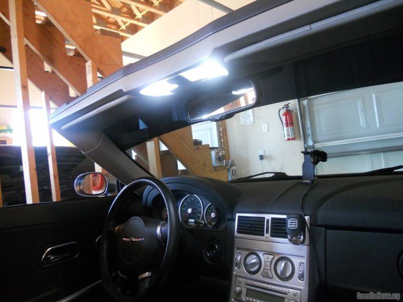

And back to Super Bright LEDs for the sidemarkers (in Red & Amber) & the Interior Lights (White) High Power 194 type LED
I do not have a picture of it, but I went with the 3 LED Festoon bulbs for the Trunk and the Glove Box...
37mm for the Glove Box: 3710-xHPx High Power LED Festoon Bulbs
42mm for the Trunk: 4210-xHPx High Power LED Festoon Bulbs

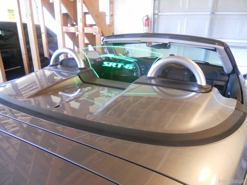

Also got my Wind Restrictor Installed.... WindRestrictor® Custom Laser Etched Illuminated Windscreens

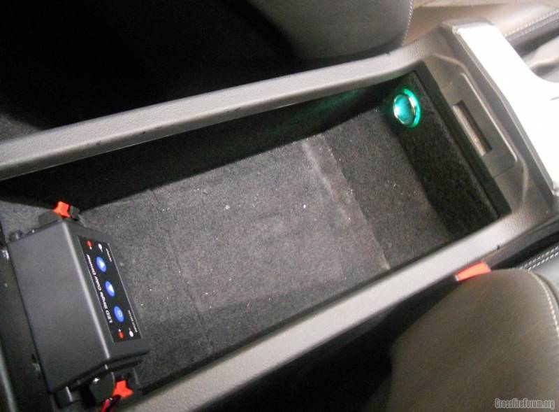

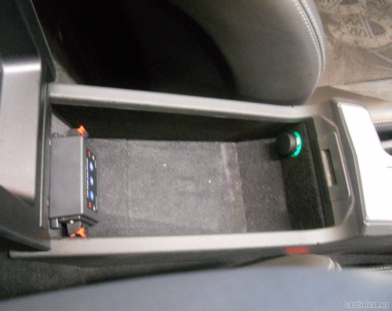

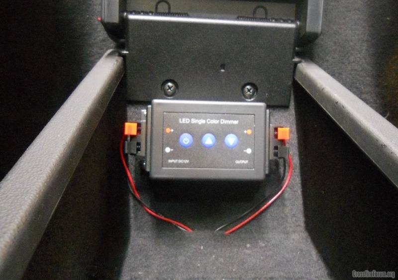

And last but not least, I was getting annoyed that the factory 12V plug (Cigarette lighter) would turn off when the car was turned off, plus I often find myself needing more than one anyway, so I added an additional plug, connected to a constant 12V source...
This one has a Green illuminated ring, which I modified to be able to use an LED and connected it to the factory dimmer. Makes it easy to see at night and a very good match to the rest of the Dash / lighting.

So a bit of additional commentary… I have used a few different brands / vendors for HIDs in the past and I will agree, these are by far the best I have used… It’s hard to describe really, I really didn’t see any issues with the previous ones, they all seemed to be built well and never had any trouble with them, but I also never cared much for the color temperature of those other companies so from recommendations on this forum I decided I would go for a bit higher cost product to see if the quality was improved.
YES IT WAS. I had went with 5000K on previous cars and had eventually decided I should go with 4300K to make me happy and to get the light output I wanted. But then, I found that MOST white LEDs were in the 5500 ~ 6000K range so I was afraid they wouldn’t match. Decided to try 5000K one more time, and have to say, these are far brighter and a lot less blue than the “5000K” models I had bought from other lower cost vendors.
Now, with that said, this is the only vendor I have used on the Crossfire, so I am comparing these to models installed on other vehicles over the past 6 or 8 years or so. This may not even be an apples to apples comparison, but I am much happier with these and will probably buy these for my other vehicles in the near future!

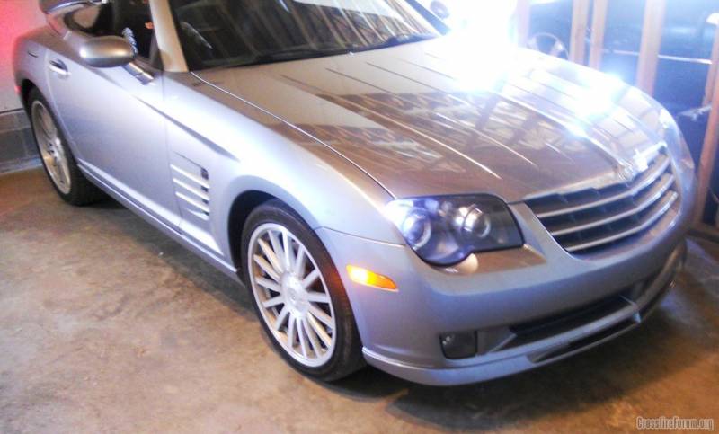

Also, on the front headlight Side Markers. They ARE STILL a bit bluer than my headlights. Not very noticeable to anyone not looking for the difference but they do annoy me enough ( I am a bit obsessive about colors matching perfectly!) so I have ordered another set, this time from Super Bright LEDs.
They have very similar, direct, low angle 1W LEDs but offer it in a NATURAL WHITE instead of the COOL WHITE of the ones I have in above pictures….
WLED-xLX Specifications
If any of you have the 6000K headlights, I think the ones from JDMTOY would be a perfect Match.

And for my last post (for now) I am also going to go with one step brighter (more LEDs) for the interior “Map” lights. While the ones I went with are bright, the camera made them look even brighter than they really are. They are about 90% of the factory bulb brightness but the fact the OEM reflectors in that housing do not do a good job of complementing the LED pattern, I am going to try the next step up and see if that gets me where I want to be…
High Power 194 Type LED) 360 degree 9 LED
Most people would be fine with the one I referenced in the first post, but wanted to mention if you want it to have MORE light than factory, you too may need to go one step above…

How do the rear LED turn signals show up in the daytime? Had some in my other vehicle and they were almost impossible to see during the day, making them pretty useless.
It's the same model I used in the front turn signals, which are VERY bright. Expensive, but VERY bright. I installed just one to compare to the factory bulbs and these were actually a good bit BRIGHTER than the stock filament bulbs.

Just installing the "45 High Power LED 1157" WOULD result in your "bulb out" warning indicator to illuminate UNLESS you used a bulb with the load resistor built in, or installed your own additional Load Resistor OR you disable the Bulb Out system...
I chose to disable the bulb out system... https://www.crossfireforum.org/forum...indicator.html
Keep this in mind... If you replace a bulb with an LED and install the Load restsor for that bulb, the Bulb Out warning system will never tell you if that LED has blown anyway... So assuming you are going to replace all or most lights with LEDs, then you have effectively bypassed the entire system, you just did it by wiring in a LOT of extra load resistors as opposed to a simple disable of the system at the source....
Unfortunately disabling that system works for ALL lights EXCEPT the blinkers. For this reason, I used the blinker bulbs with the load resistor already built in. VERY pricey but kept me from having to worry about any load resistors myself.
I went with the more expensive ones for the back up bulbs, not because of the load resistor being built in to those, but simply because they were the brightest / highest wattage I could find. They do make the 1157 type bulbs that I used for the brake lights, in a white version that would probably work well for the tail lights. They would probably be brighter than the stock ones but I wasnt sure if they would give me the light WHERE I needed it. I wanted to make sure the light was a bit more focused than what normally comes from the LED tower bulbs, and besides, to me, you cant get TOO bright on back-up bulbs so I just went straight to the brightest I could find.
Super Bright LEDs actually have an option very similar than the one I got from JDM.... High Power 4Watt BA15 bulb Specifications
