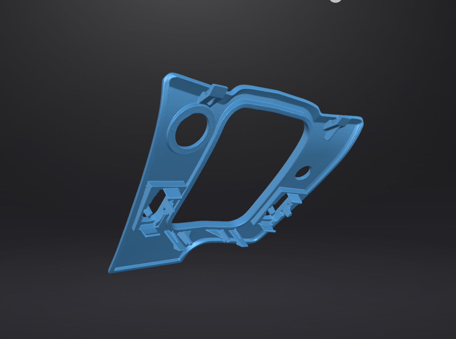

My new scanner is working great. Going to print these out and have them tested for fitment.

Looks like excellent quality.

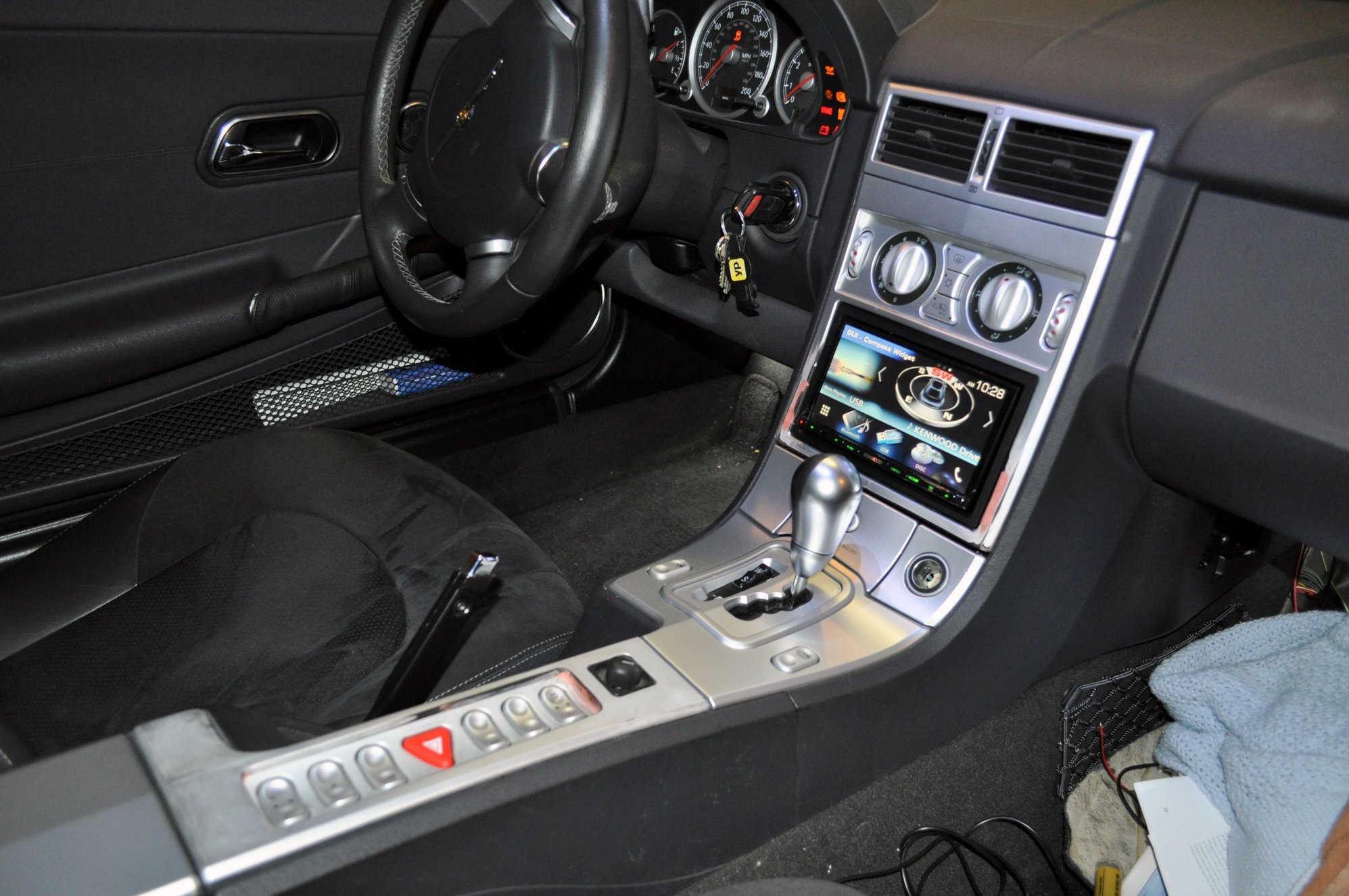

Why not make the two pieces in one, I made mine using OEM face plates and added the ciggy lighter and the passenger seat belt light to the window switch bezel. I think it is illegal and potentially dangerous not to have passenger sear belt light as the air bag could be switched off, that being a danger to the passenger . Or the bag could be on and throw a baby seat at the windshield. You would be liable having removed a safety feature.
I actually made two versions of the DoubleDin, the other kept the ash tray and the switches went to the console.
It is shown during filling the corners and is unpainted of course.

Why not one piece? Because there is no resin printer under 30k dollars with a build plate that large. These are preliminary scans, I never said these were finished products. They are being sent to testers to test fit and feedback. I can see the seams on your build

I can see the seams as well, but not before I painted them. I should have stripped it down but at my age I said Fxxx it.
I did finish the first one and painted them together, the first one is the one I am more happy with but I wanted the buttons on the dash.
I have all the original bezels, Nav radio etc so I could go back to stock.
Any mods I did can be taken back to OE specs, the NW Single air intake is on the shelf.
No original parts from my stock car were injured during the making of these faceplates.

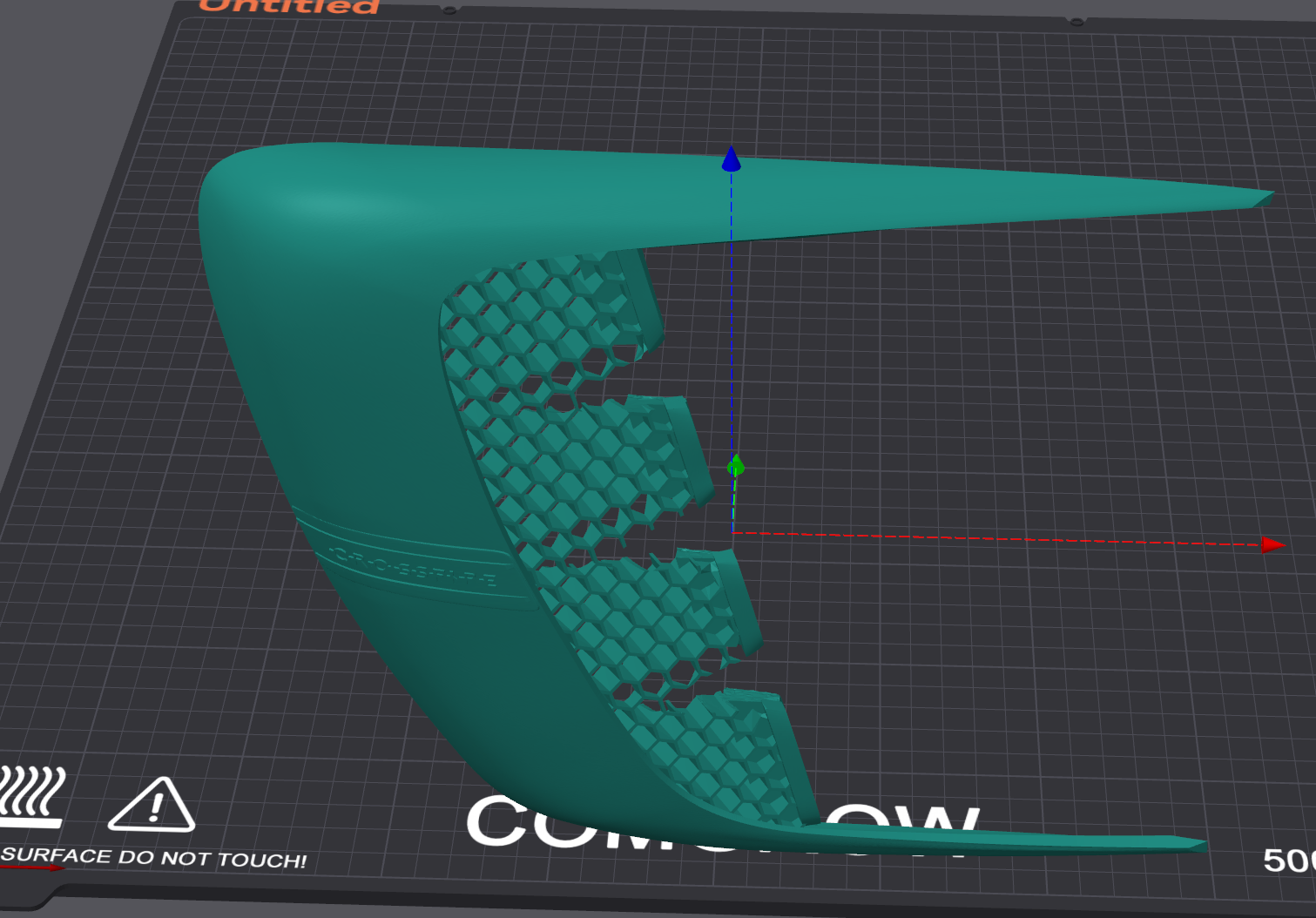

New side vents. redesigned.

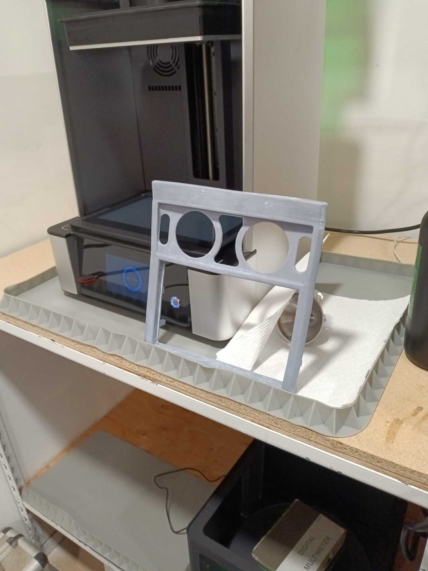

UPDATE: Printed my first prototype in water soluble resin to see if it came out well. It did.
I'm running some ABS prints tonight as well as the button panel and a couple other things.
Need to tweak a couple things but so far for a first print it's fantastic.

Looks great!
