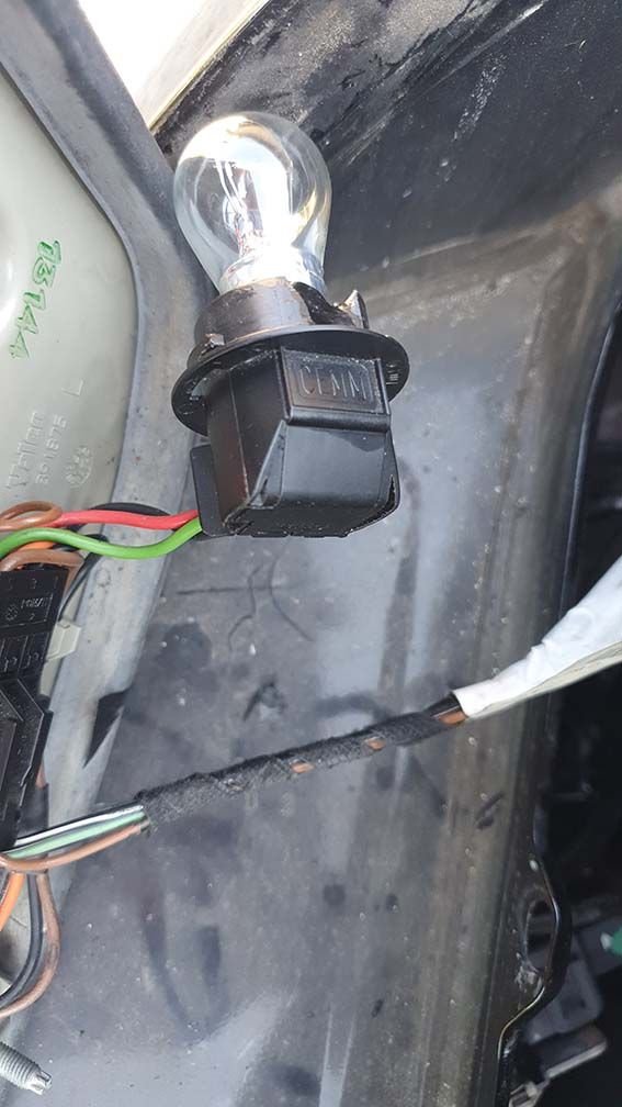

Je recherche le support de feu stop arrière de ma Crossfire Roadster (je pense que c'est pareil pour les autres).
Il est cassé et ne fonctionne plus.
Malheureusement, je n'ai pas la référence Mopar (si elle existe) et je ne la trouve pas en ligne, c'est pourquoi je vous contacte.
J'ai joint une photo de cette pièce.
Merci pour votre aide
Hello Excuse my English.
I'm looking for the rear brake light bracket of my Crossfire Roadster
(I think it's the same for the others). It is broken and no longer works.
Unfortunately, I don't have the Mopar reference (if it exists) and I can't find it online, so I'm contacting you.
I have attached a photo of this piece.
Thank you for your help

The Mercedes SLK 320 1999-2003 uses that same light socket. I would try cleaning the contacts and make sure you are getting good connection and make sure you have power to the socket

Thank you very much for the reply.
I need to replace the socket because part of it broke and it's no longer making contact.
Do you have the part number for the Mercedes SLK 320 for this part? Or, how can I find it among the Mercedes parts?

The attached link is for the Mercedes Benz SLK rear light socket for your Crossfire. It would be cheaper to go to the European site, I'm sure it would be cheaper to buy it, since you are located in France or go to a Mercedes Benz dealer with the part number.
