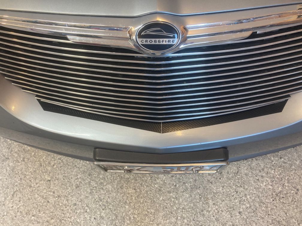

So unfortunately on most Crossfires I see the front and back emblems are faded.
Most don't know, you can buy front and rear emblem (different) sizes and replace them very easily with brand new ones.
I always found the front emblem on eBay (or pennies on the dollar on AliExpress,.might be knockoff) but I never found the trunk one.
Because I went to a Crossfire meet and folks said they paid $400+ to replace the full wing including emblem I thought I'd post instructions again on how to make your Crossfire look new for little money.
Here is the video that explains how to remove ONLY the emblems (drill into the "RYS" of Chrysler in the emblem as there is a hold behind it) and peel it off with a screwdriver, clean the leftover glue with GooGone and alcohol and attach new emblem.
Here is a YouTube video explaining the process:
Now, the trunk emblem is hardest to find because it is smaller. I assume it actually comes from a different Chrysler model (Sebring, 300 or Town&Country) but here is the eBay seller and here is the part.number OEM:
It says Front but it actually fits our trunk emblems eBay Click
As far as the front emblem. Click
It makes a big difference and definitely makes the car stand out more imo.

Here's another option also available with Chrysler logo, coupe or roadster image, high quality domed emblems go right over the old ones I have on my 07 since 2018 still look new : https://beststickers.net/index.php?r...product_id=817

Yessir! Had customized Karmann badge made by them to put on the fender of my old Coupe in brushed aluminum. Imo looked like it belonged there and came that way and definitely improved the look of the Crossfire.
For the SRT-6 folks among us, Beststickers.net also has really cool domed SRT-6 emblems for front/rear, steering wheel and the wheel hubs. I had replaced my work key fob shells with the Mercedes shell (the black one). Was like $3.99 on AliExpress. Moved the chip and transponder as well as flip out key into the new shell then got a SRT-6 logo from BestStickers.net for the back of the key fob. They can do the old font or the new one.
Looks great.
On the spare key I had them print the Chrysler logo on Gold paper with colors of the original and it looks just like the logo that was originally on the fobs. Oh and for those of us who would like to have an emblem on the Supercharger that goes in place of the AMG Engineer signature, they make some good options for that one as well.
