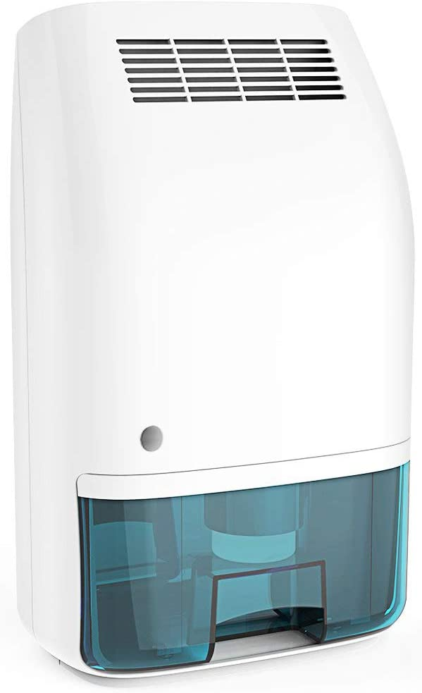

Default Re: Interior Condensation?
Might want to try one of these :
Amazon Amazon
