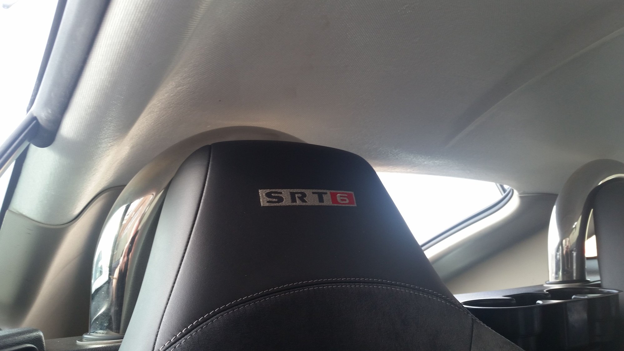

Pics worth a thousand words:
Bare bones

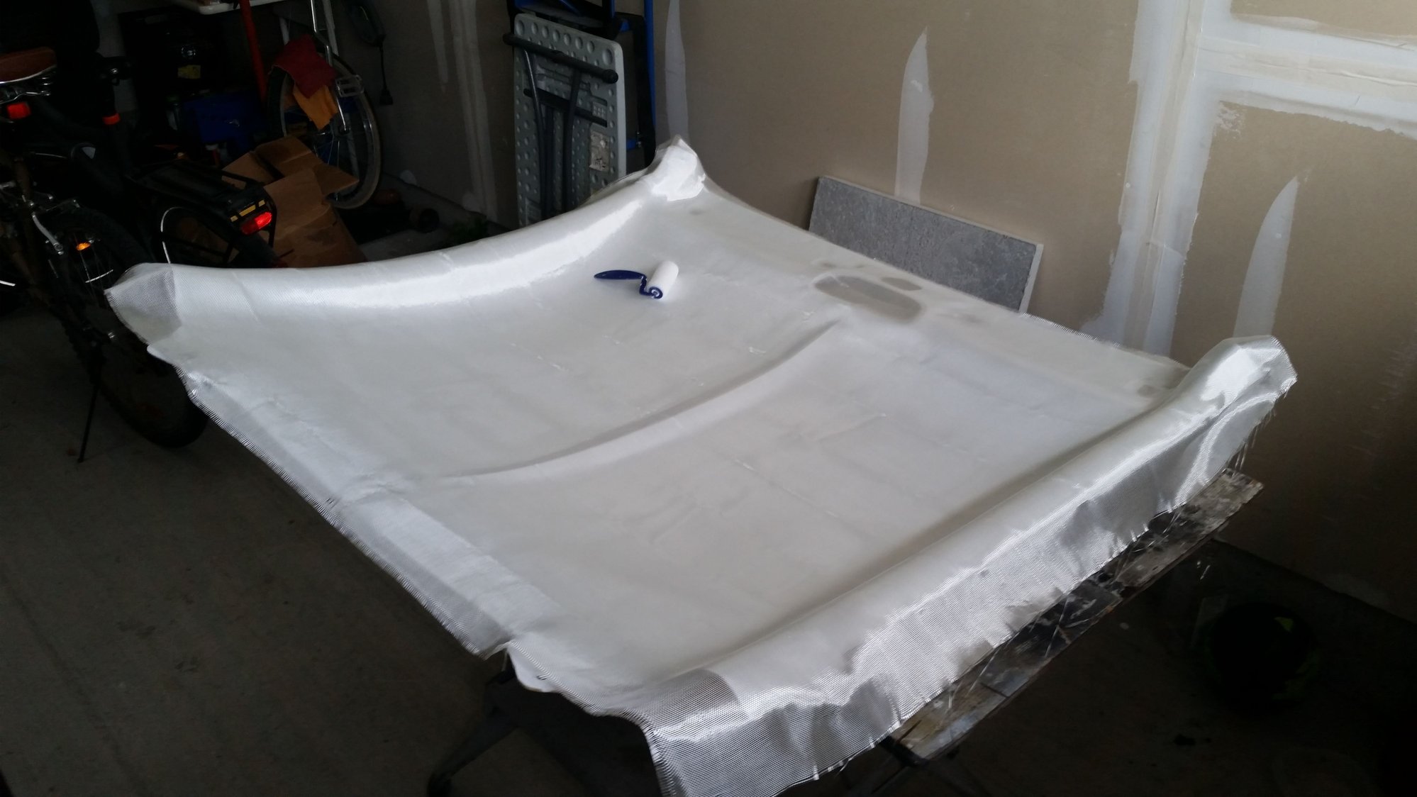

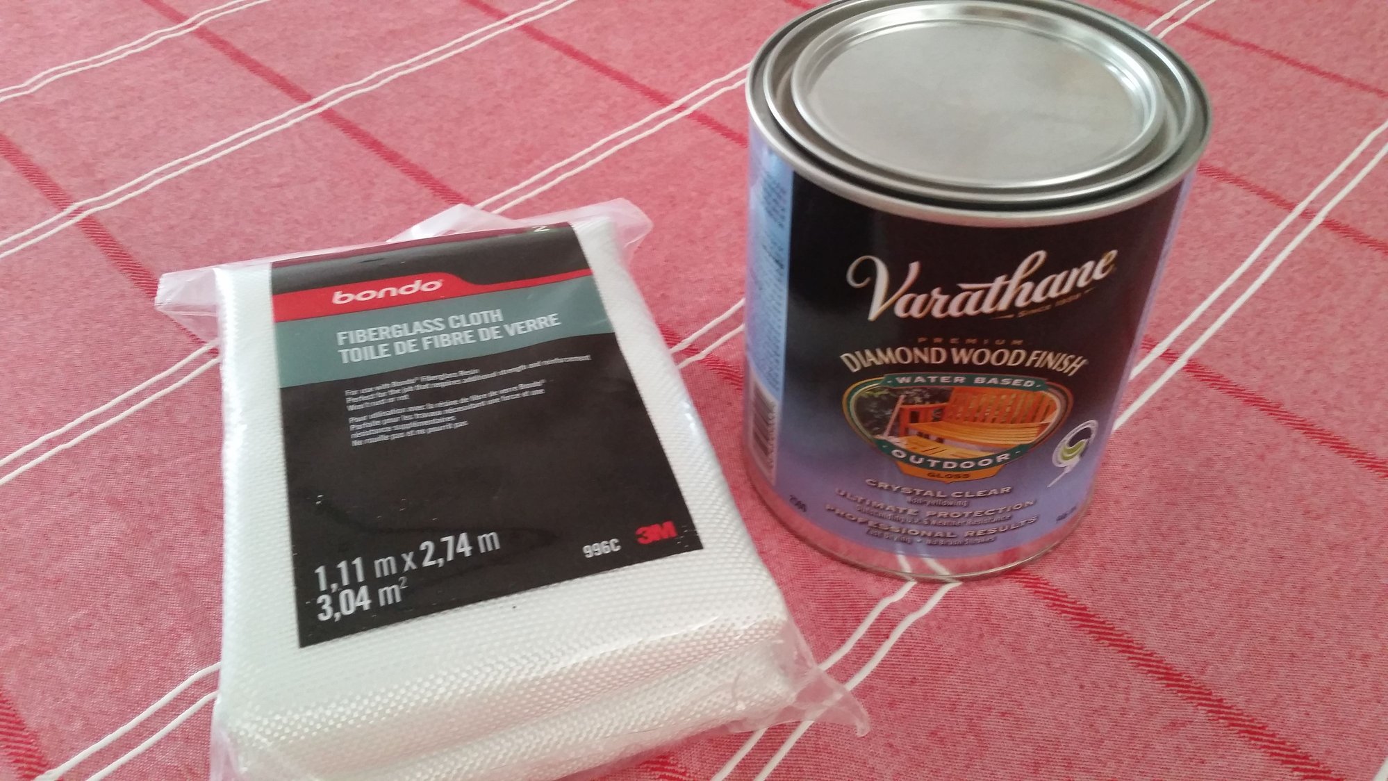

The base is primed and painted white. The fiberglass cloth is glued on with 3M spray adhesive. Two coats of non yellowing varatane to seal the cloth, otherwise it would unravel.
The liner loses some flexibility so it's harder to reinstall, specially if you have roll bars

What made you decide on this material?
Does it sound harsher inside the cabin? I would think the harder surface will not absorb noise as much as the softer surfaces.
I am thinking of using a heat resisting contact glue from a can and using a roller rather than a spray can, Something with a longer working time.
What do you think of that?
I picked fiberglass cloth to match with the silver carbon fiber dash trim kit I might install later, like I had in my black N/A. IMO the 3M adhesive is more user friendly. You can spray 1 or both surfaces for a more secure install. You can bond the media between 30 seconds and 10 minutes. Unlike contact glue, you can lift up the material to reposition and it's simpler to apply. No need to worry about overspray since you are working on a bench.
As far as noise suppression, I can't tell the difference before/after. Don't forget, there is more sound suppressing material on the other side of the headliner, Feels like 2"of foam/cotton combination
